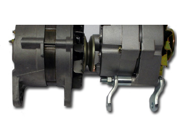

It was set up with a GM alternator during an old Vintage Air addition. I removed the old AC and went back to a factory mount and used this adapter and kept a GM alternator set up.
Definitely open to other more simple/Toyota options.
I hope you have a plan for the Power Steering, I would love to go back to a Toyota style pump and eliminate the existing type of set up!
The factory PS pump does not exist anymore. Plus the new head is like your old head. No place for the factory mount.
