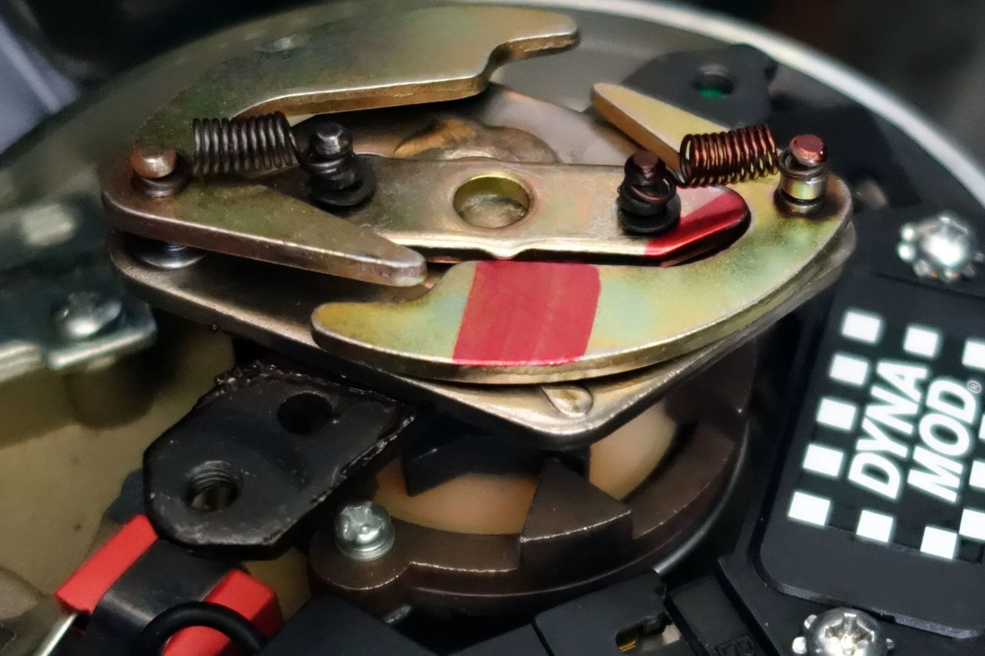

Jim,
What I found with two occurrences was that the distributor shaft would pull downward, destroying the cheap bronze bushing under the main shaft, the pole plate gets sucked into the pickup coil and turns it into a rat's nest of ultra fine copper wire. The motor just dies and when you lift the cap it looks like someone set an M-80 off inside the dizzy. The copper wire looked like Phyllis Diller's hairdo. Neither lasted over 17,000 miles. I haven't used another in ten years...maybe they've got better with the gear cut.
Jim,
Not quite what we saw happening, what we saw happening is the dizzy being kicked upward, where the drive gear was still in contact with the cam (and the engine still running), but the botton tip of the dizzy shaft no longer engaged down into the oil pump. Since the dizzy hold-down clamps were hammered, MAF came out with a heavier duty hold down clamp rather than to install a Toyota drive gear onto the Delco??? Additionally, the Delco drive gears were worn down to tin foil.
Ours were definitely pulling downward. The rotor plate was pulling into the pickup coil, throwing copper winding everywhere. I
pulled them apart comparing them to an old GM HEI from the mid 70s. The thrust bushing in the GM unit that the shaft rides on
preventing this was sintered iron. The Chinese knock off was softer bronze I could pick at with a screwdriver. The thrust surfaces
wore down quickly until the gap between the rotor plate and coils disappeared. This did not happen with Davis Unified Ignition's
unit but I did have the weights come off resulting in a bent main shaft. OEM HEI units secured the weights with e-clips.
The Davis unit did not have clips although the groves were cut in the weight posts to accept the clip. When I called Davis
they said that they determined the clips were unnecessary. Al at Manafre sent me a new main shaft . I rebuilt the DUI and added
the clips. You can find them with the weight clip/spring set that you find at a Oreilly or Autozone in their performance sections.
I believe they are Spectre products. I haven't checked a Davis in ten years but if I run across one I would certainly look to see
if the clips were installed

Well, my Davis DUI (Toyota model) was purchased July 2017. I will check for clips in the morning.
Are these the clips in question?
