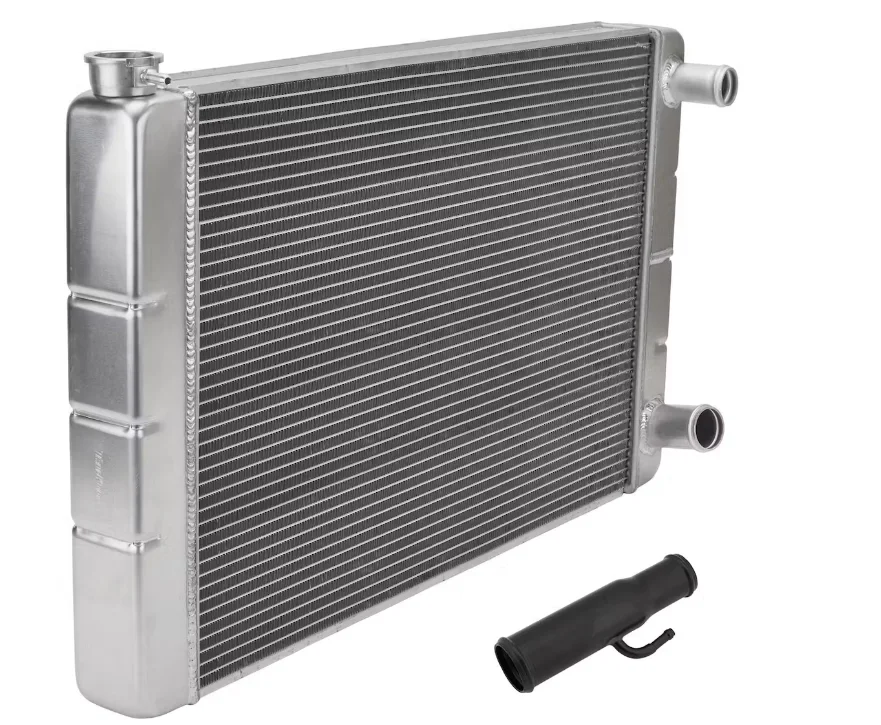

Ya and after I spent all the time doing it I realized I need some sort of steam vent plumbing to the radiator. It was sort of an exercise in can I. I’m sure it will seal but not sure if it’s enough cooling. More than likely will buy a new one.
There is a insert that you would connect between 2 rubber hoses that has a steam port. LEt me find it for you
This is actually the radiator I bought from Speedway. Price is hard to beat. That black deal in photo would go inline on your top hose.
Mine is in a 40, so take this with a grain of salt. I’m successfully cooling my stock 5.3 ls with a stock (fj40) radiator. In addition I’m using a Ford Taurus electric fan. I used what I had and figured I would swap it out if it didn’t work. Three years later, I’m happy with a newish stock radiator.
For the steam vent, there are a multitude of inserts with ports online. I had to piece two radiator hoses together anyway, so it was an easy choice for me.
