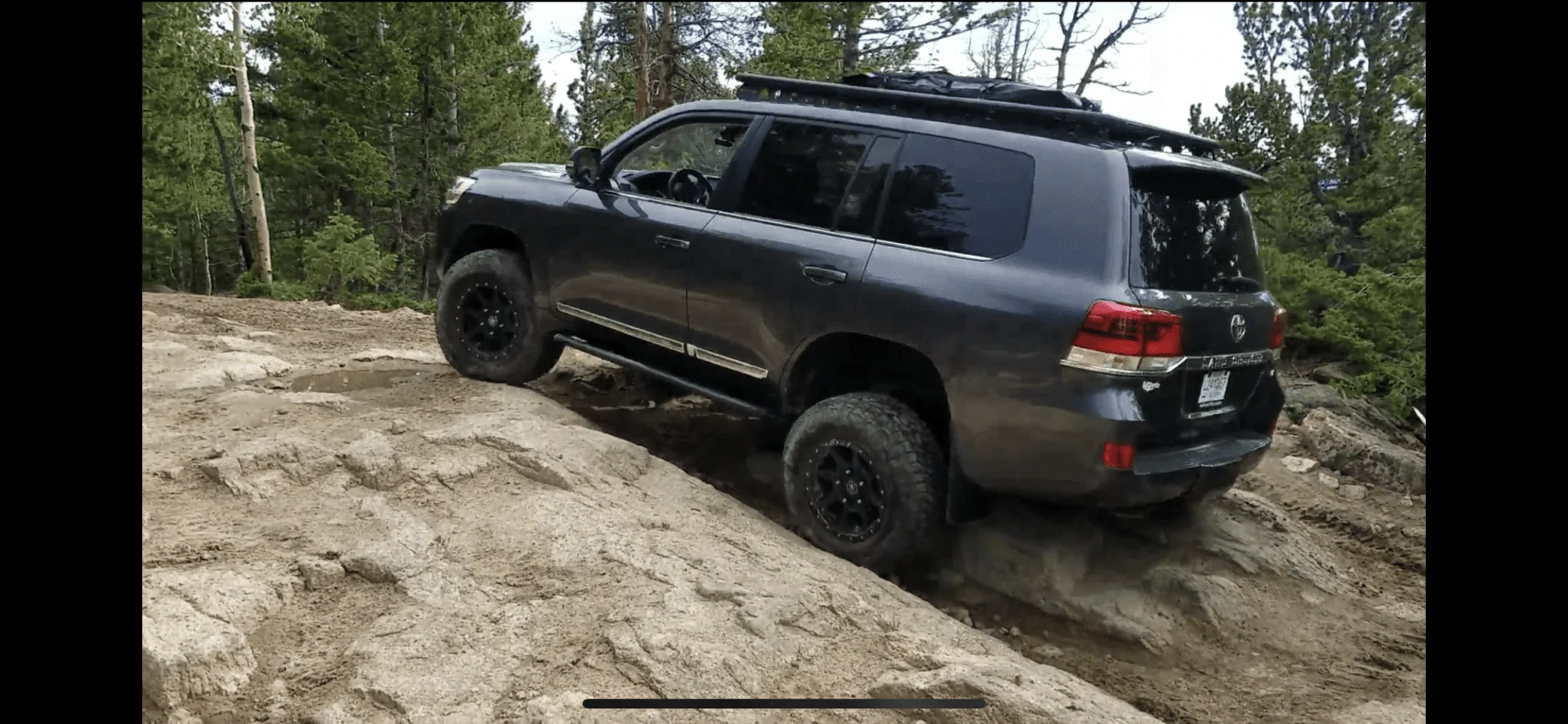

I am the new owner of a 2020 Land Cruiser. This is my first post although I have spent more time on this site than I care to admit.

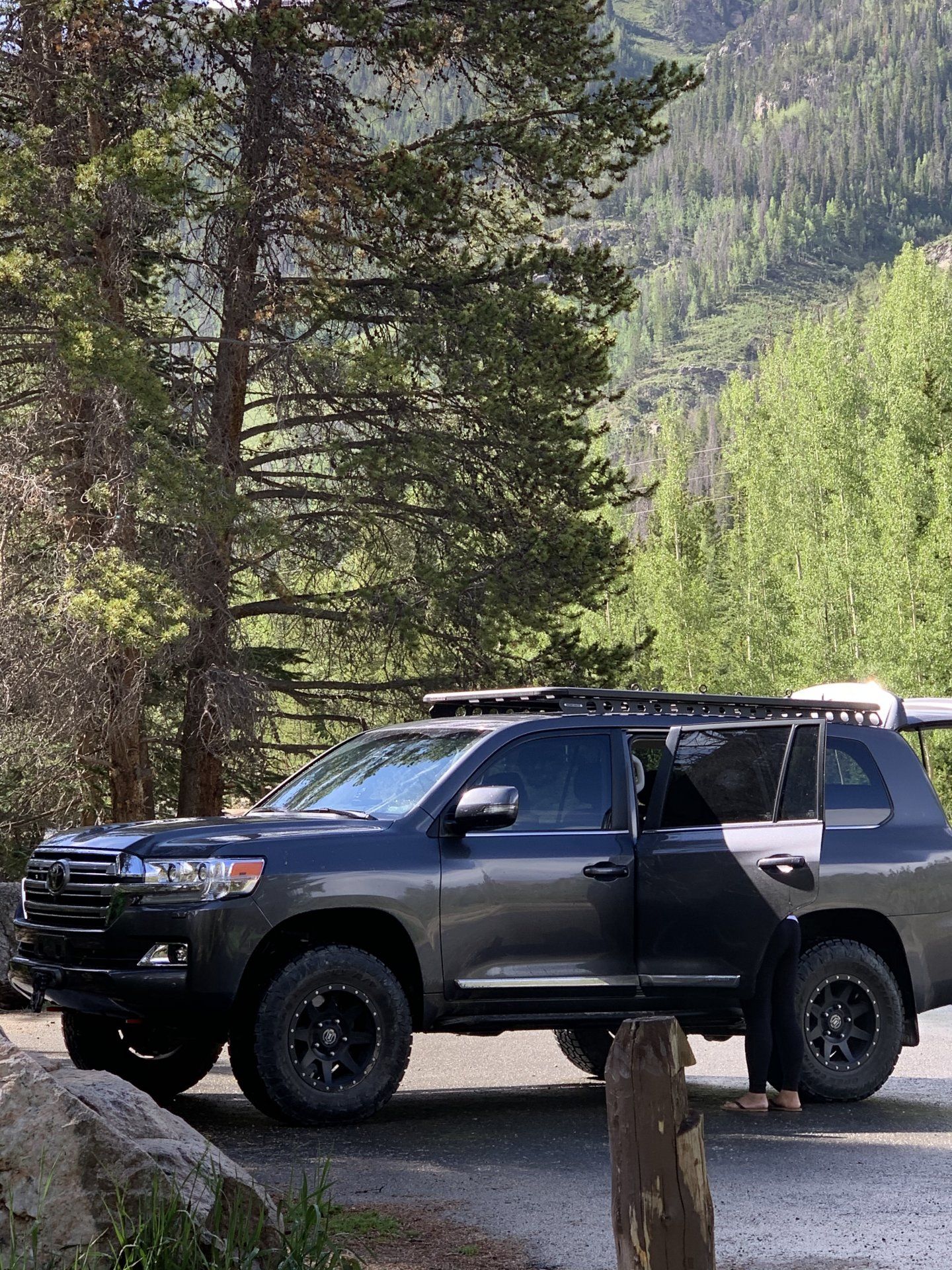

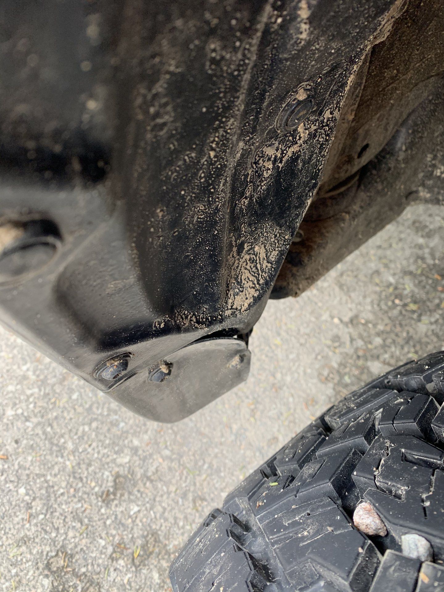

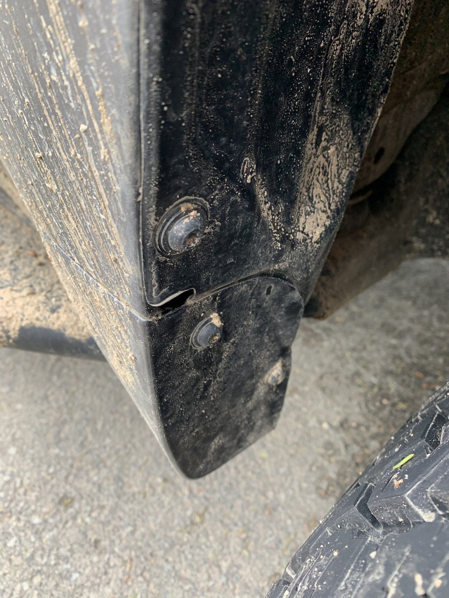

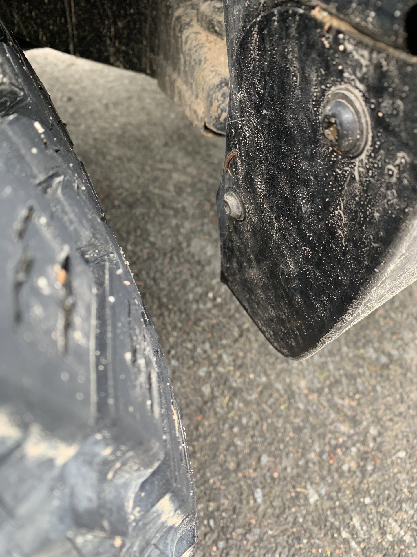

My tires are rubbing on the trail (and sometimes even when I pull into my driveway). I don't know the terminology however the front two tires hit on on the body molding directly behind them. Tires are Toyo ATIII size 285/70R17. I figured by staying with this size I'd clear however that is not the case. I have BP-51's with a 2" lift. I've always been a truck man and have chopped that area before however with a little nicer rig that this is I'd prefer sometime more subtle if possible. Enclosed are some pics of the molding that is catching but also a pic or two of the rig and I have never posted a thing.
New owner....new to the LC world with temporary tags still.
Any suggestions?
Thanks in advance.
It’s likely offset of those wheels not tire size.
Hard to tell from your photos but it looks minor. Some folks heat up the liner and massage it out the way. You can also drill new holes in the liner and pull it forward.
I was thinking of drilling new holes for support and removing some of the area that rubs. Thanks for the support. Very quick responses. Nice to know I was on the right track.
First step would be to verify you have an alignment with as much positive caster as possible. Sometimes they just set it 'within spec' but with a whole lot more to give....it would pull the tires forward. If you dont have aftermarket upper control arms they will also give you that needed caster.

If I'm not mistaken, those are Icon Rebounds. Offered in +25 and +0 offset. I can't tell from the pics but it looks like they are +25.
Following @tbisaacs lead, yes, the rubbing is likely due more to wheel offset than tire size.
You can do a little trimming or heating it up and molding it. If you have aftermarket upper control arms, you can align it such that it buys a bit more clearance at the rear. Or a combination of both.
Can you circle where it is rubbing?

If you remove the wheel spacers, you may go a long way to also losing the rubbing.

oh yea, ditch the spacers and likely you’ll be fine.
Pishhhh, that's minor! Just start cutting 😂
Yeah, 25mm and 30mm of spacer is -5mm effective or so. It can be done if you want the poke, but you'll have to trim. Agree with others you're better off without the spacer, for a lot of reasons.
Yep, that's what I did. I used a heat gun and pushed the plastic where I wanted it with a piece of wood (hammer handle). It worked well and keeps it's shape.
