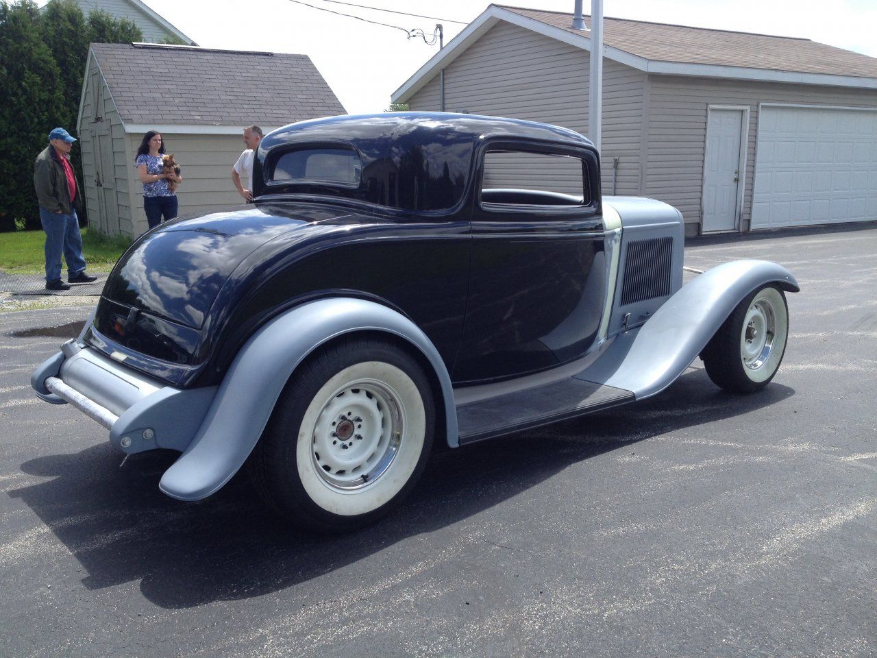

In Detroit picking up the '32. I'll trailer it home tomorrow. It's got a lot more left than the Cruiser does but this is year 4...
When THIS is done, I won't miss the Cruiser any more.

BTW, that looks to be a fun road project! (the '32!)
Cheers!
