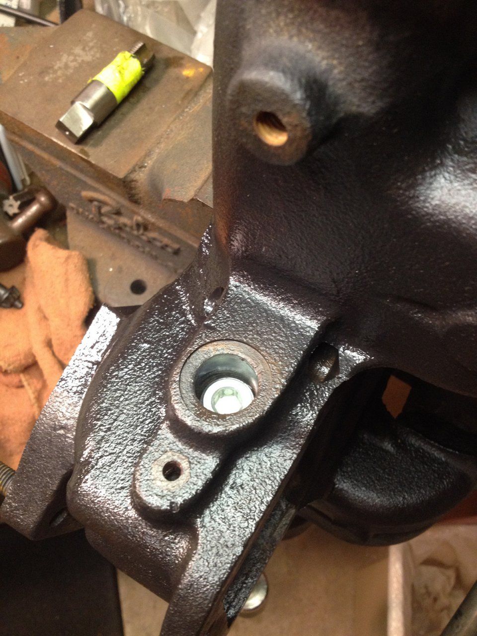

I just got all the right tools and time and everything else together all on the same day and right when all the planets were aligned and behold! Manifolds are on. Here's what I went through and just in case you want to see how I did it. (I'm sorry if there's a thread on this already. I'm not up to looking and it's part of my build so here goes: (long post)
This is how I took care of the heat riser and it's removal on my build. The two bolts holding the flapper are just tack welded on. A little Dremmel action ad poof.
Remove the bolts and simply lift out the plate exposing the shaft.
Nothing to it. The shaft and all the external hardware just slides out. (at least it did on mine.)
Next.
Pulled the bushings out of the casting because trying to put in 3/8th plugs, the drill ended up rotating the bushing in place. So out they come with a puller.
Then I tapered the hole. Not the one you see in the picture but the smaller diameter hole about an inch down inside. That made the bushing have to come out the top.
Then being very careful (as with the taper) not to go too far with either one and make the receiving hole too big.
With fingers crossed in the first hole, I placed the plug in and only had to go back with the tap one extra time to get the right depth and knew haw far to go on the other side the first time.
