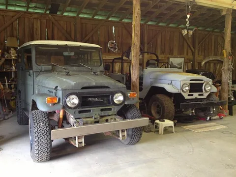

The organ donor has arrived. Runs like a champ. A little thievery and some cleanup and the green one's up for grabs.

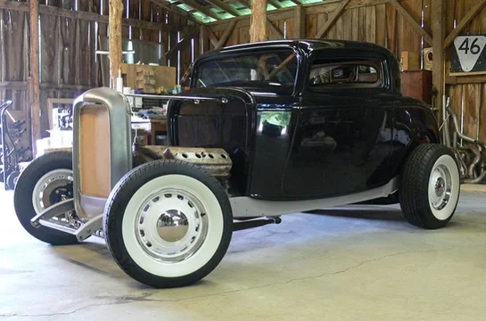

Nope. The green one will be a good starter for a trail truck but not up to my standards. You've got to remember what my last Cruiser was like. This one will be valued at or about 6k. And my spare "car junkie" cash is all going to my '32.
Here's what the '32 looked like about a month ago...
I thought maybe a picture of a '32 was out of bounds but then I realized that we're all "car junkies" and a nice ride is a nice ride no matter what it is.
I've got a '53 Hudson Hornet in the garage right now that I'm taking care of. I take it out once or twice a week for a stretch. If it's not a sin here I'll post that too. Kind of off topic...
