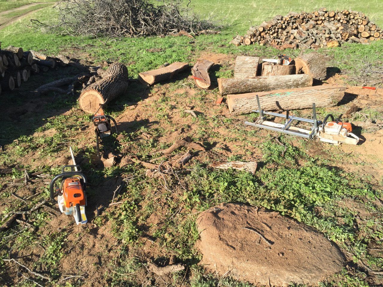

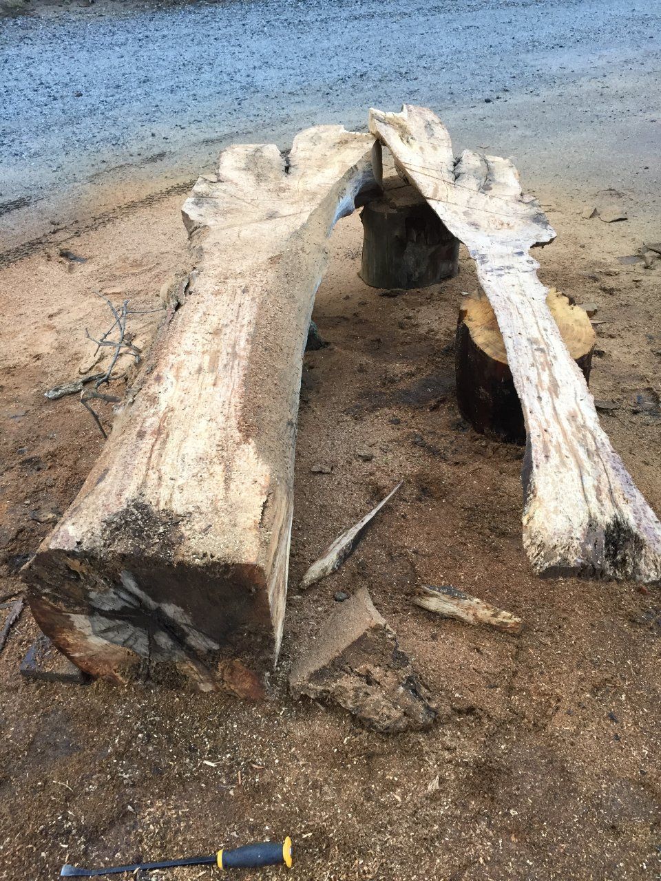

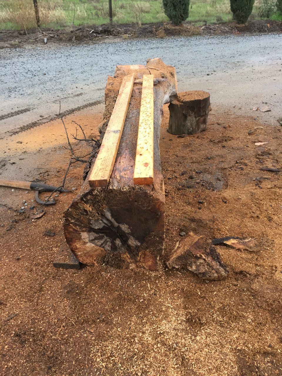

Firewood?

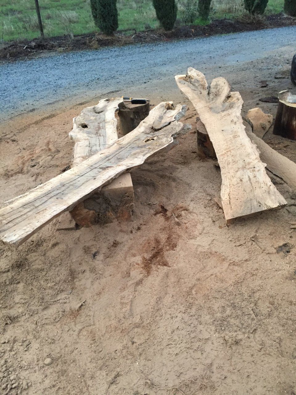

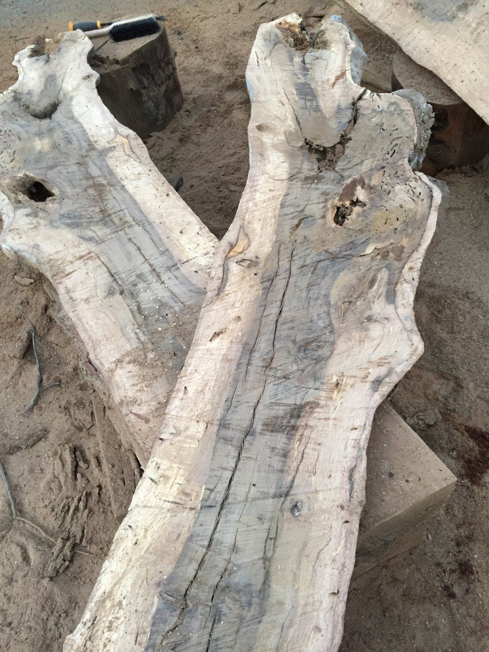

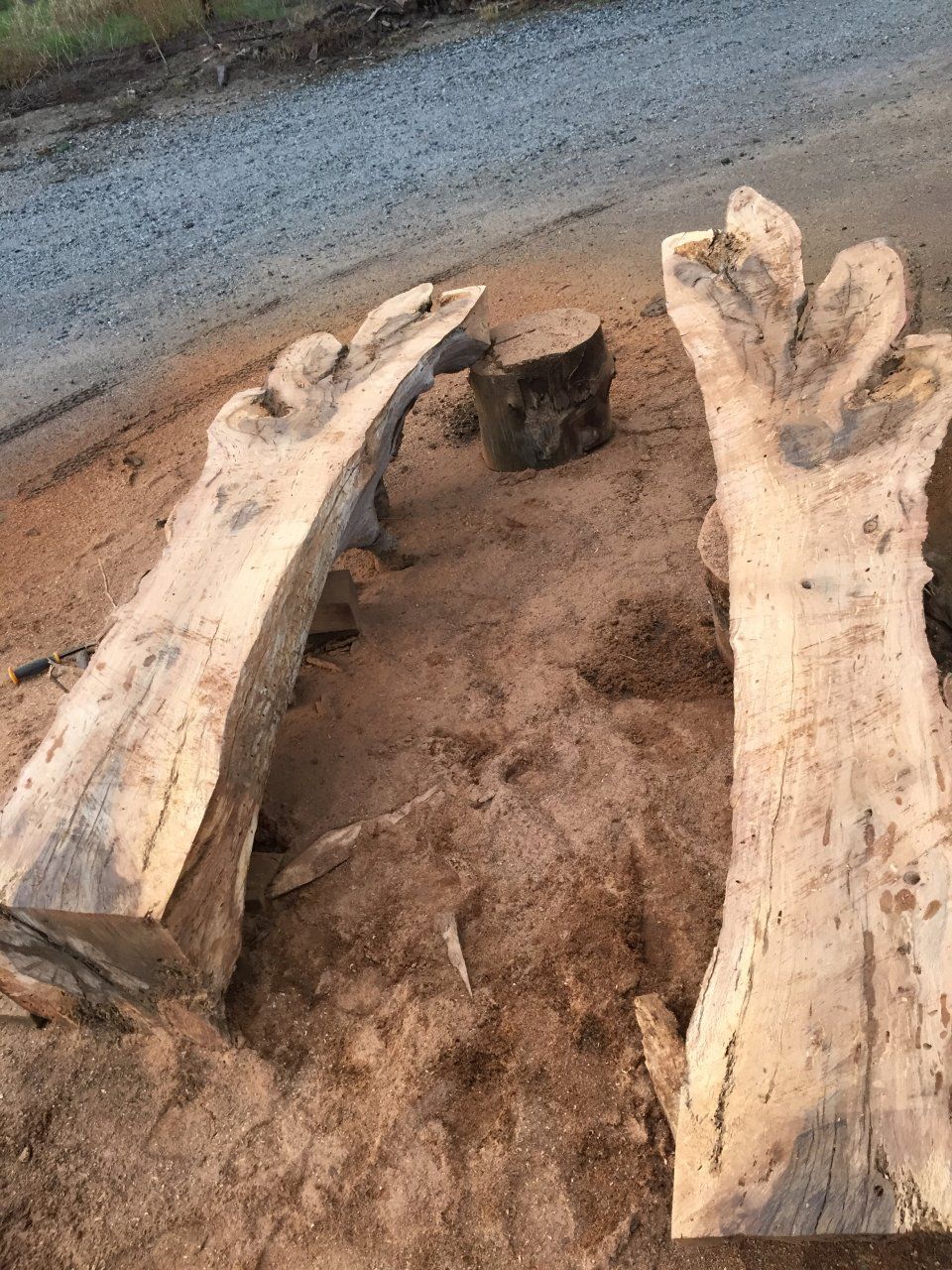

Sheesh, that must have taken all day.
Do you have a ripping chain on that?
I own an Alaskan sawmill as well but I haven't gotten around to buying a ripping chain.
Took about 12 minutes per cut.
Took longer to square up the log to make the first cut than anything else.

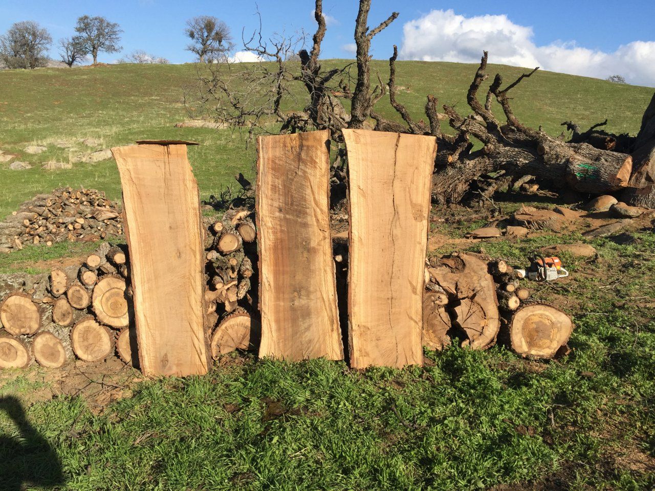

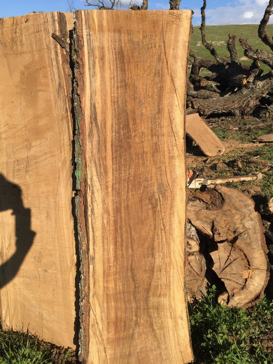

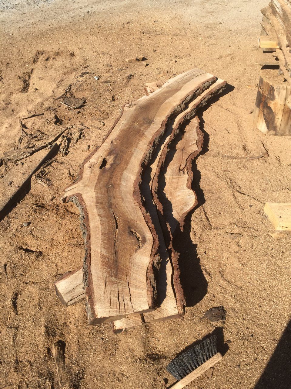

Made some slabs out of the oak log.
Very rich colors
Is it just me? Cutting oak with the grain is much harder on the operator and the equipment than across?

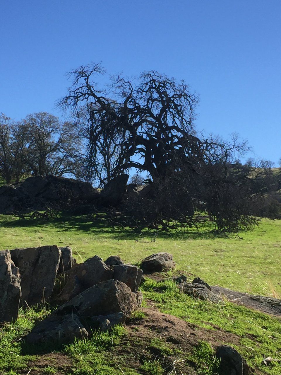

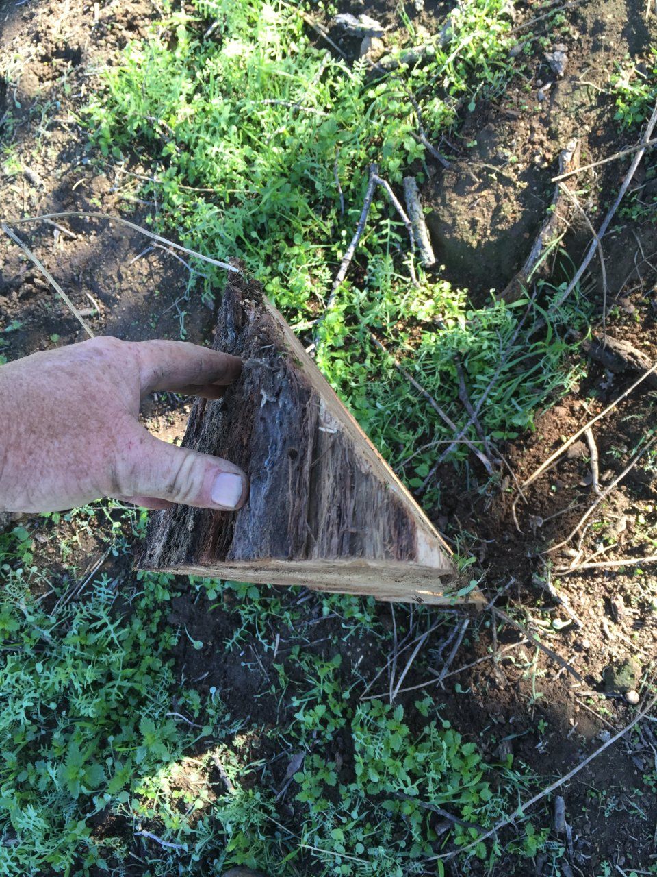

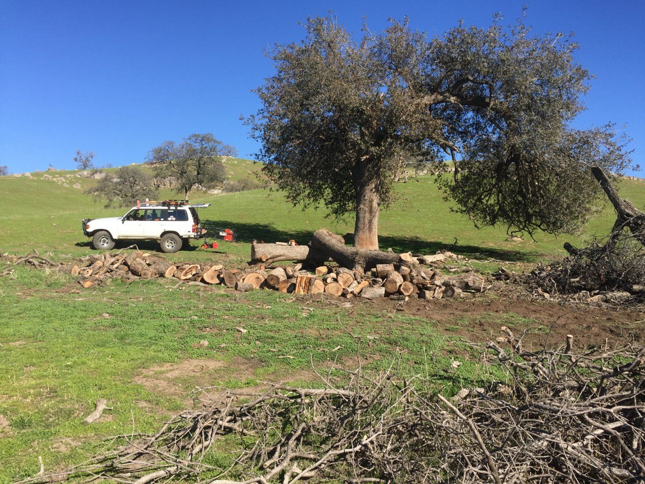

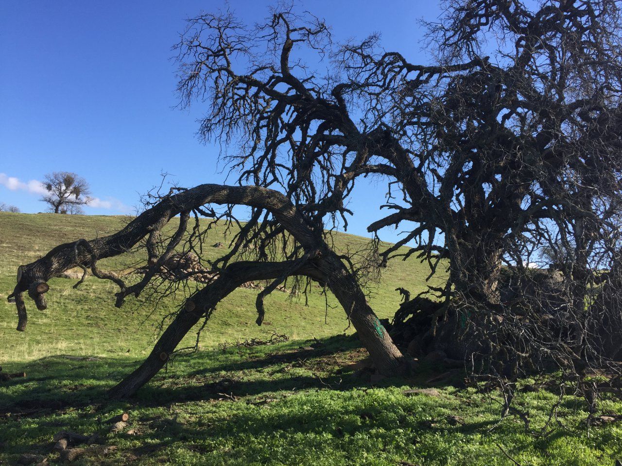

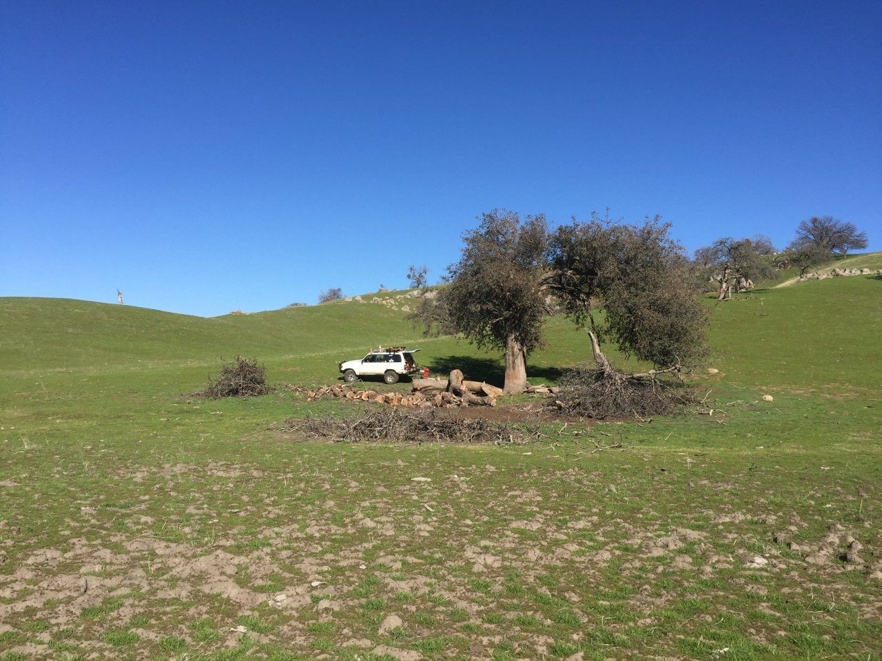

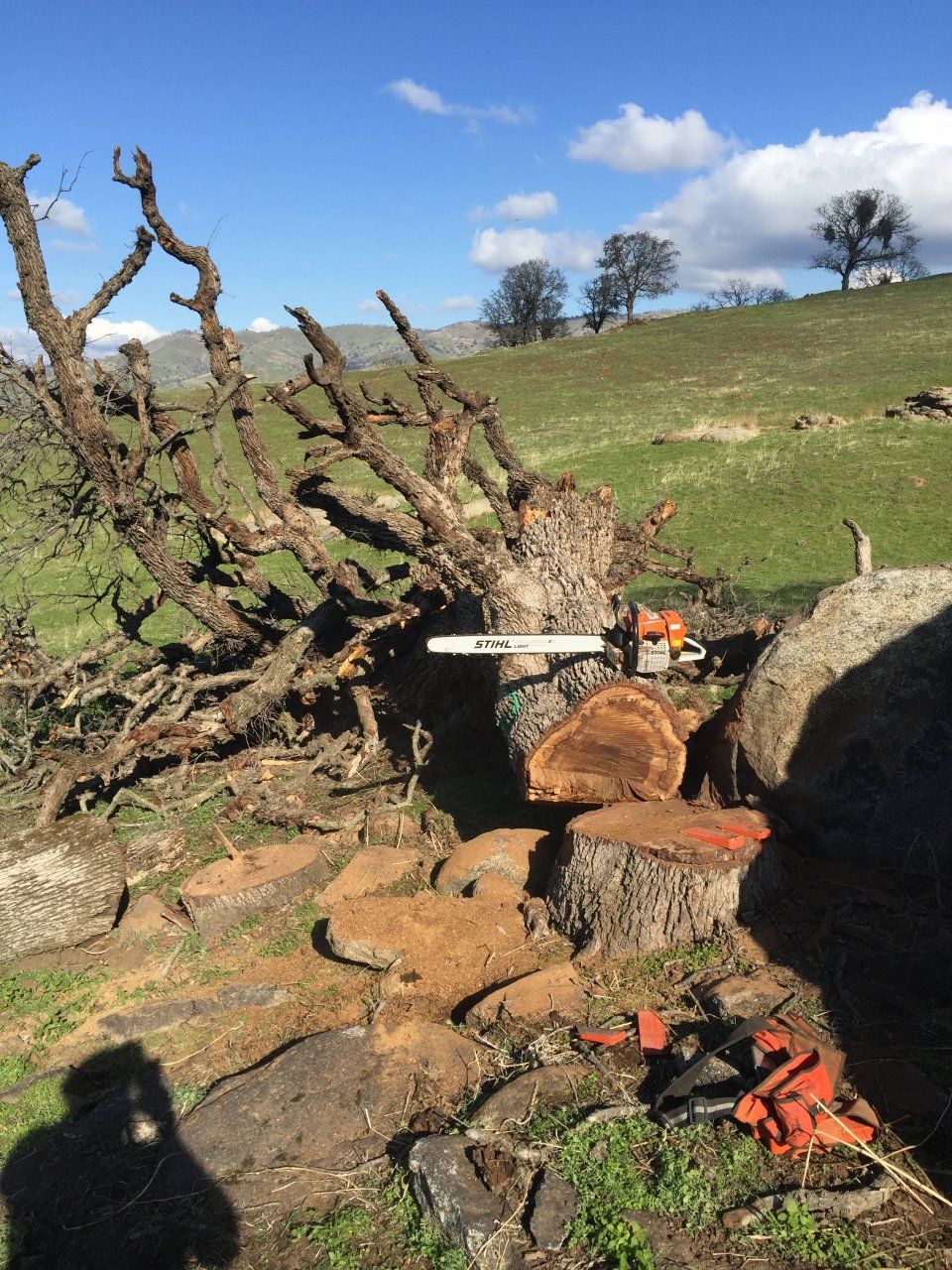

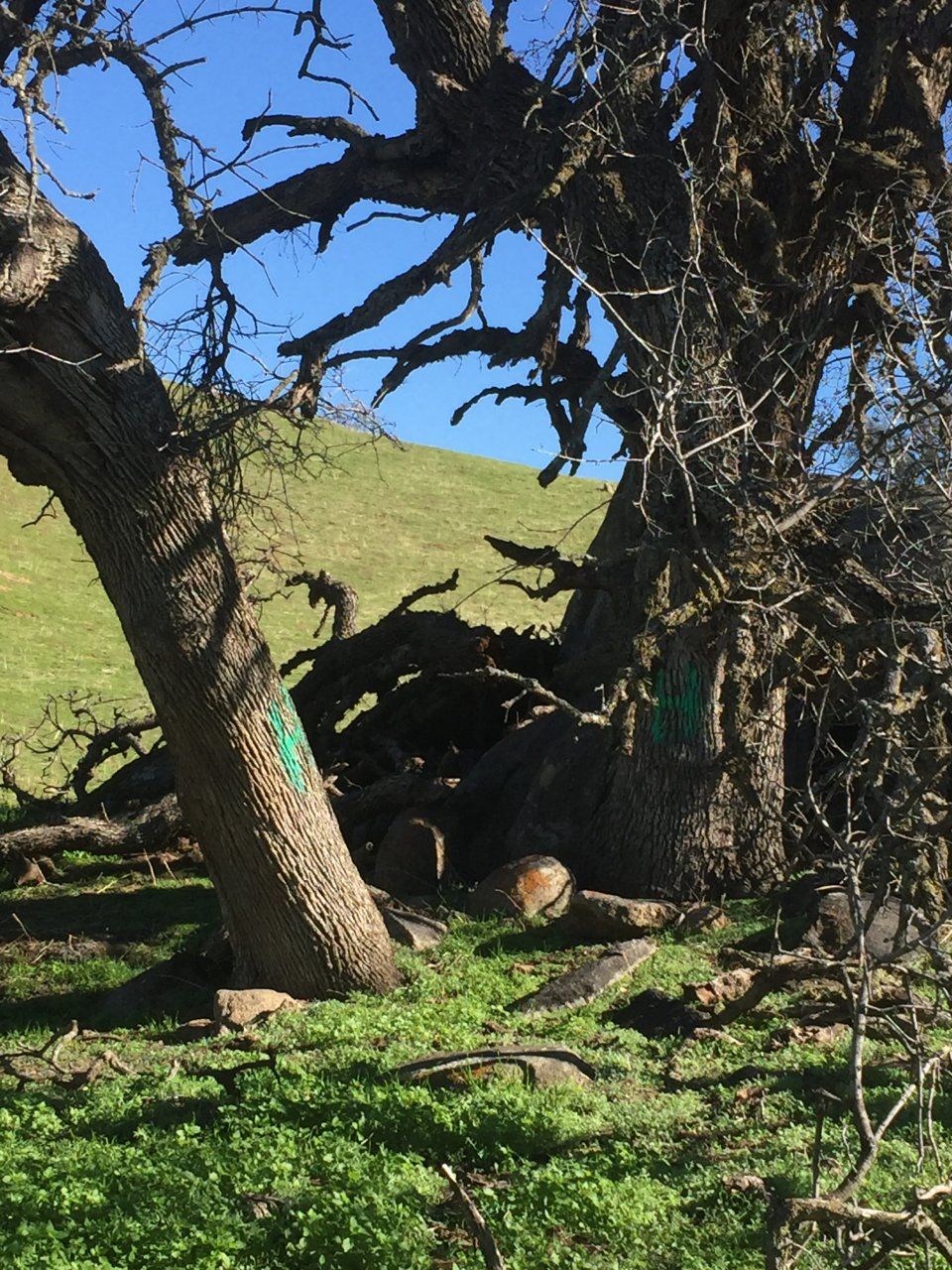

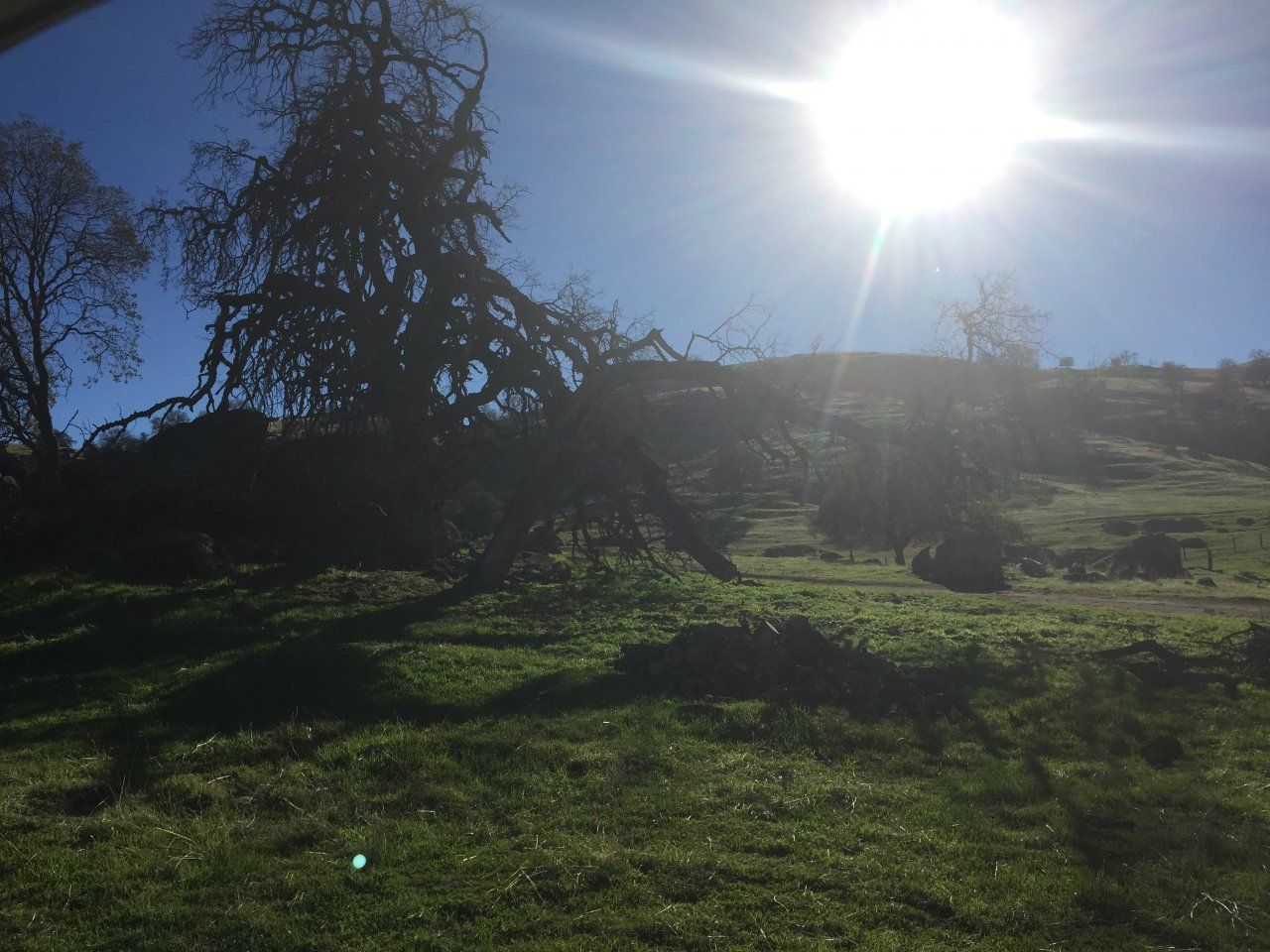

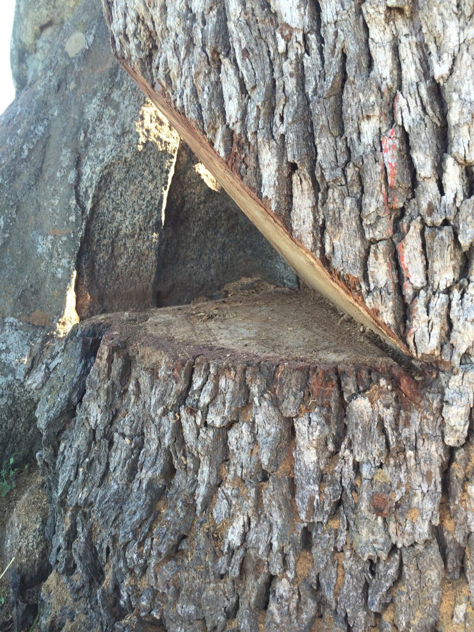

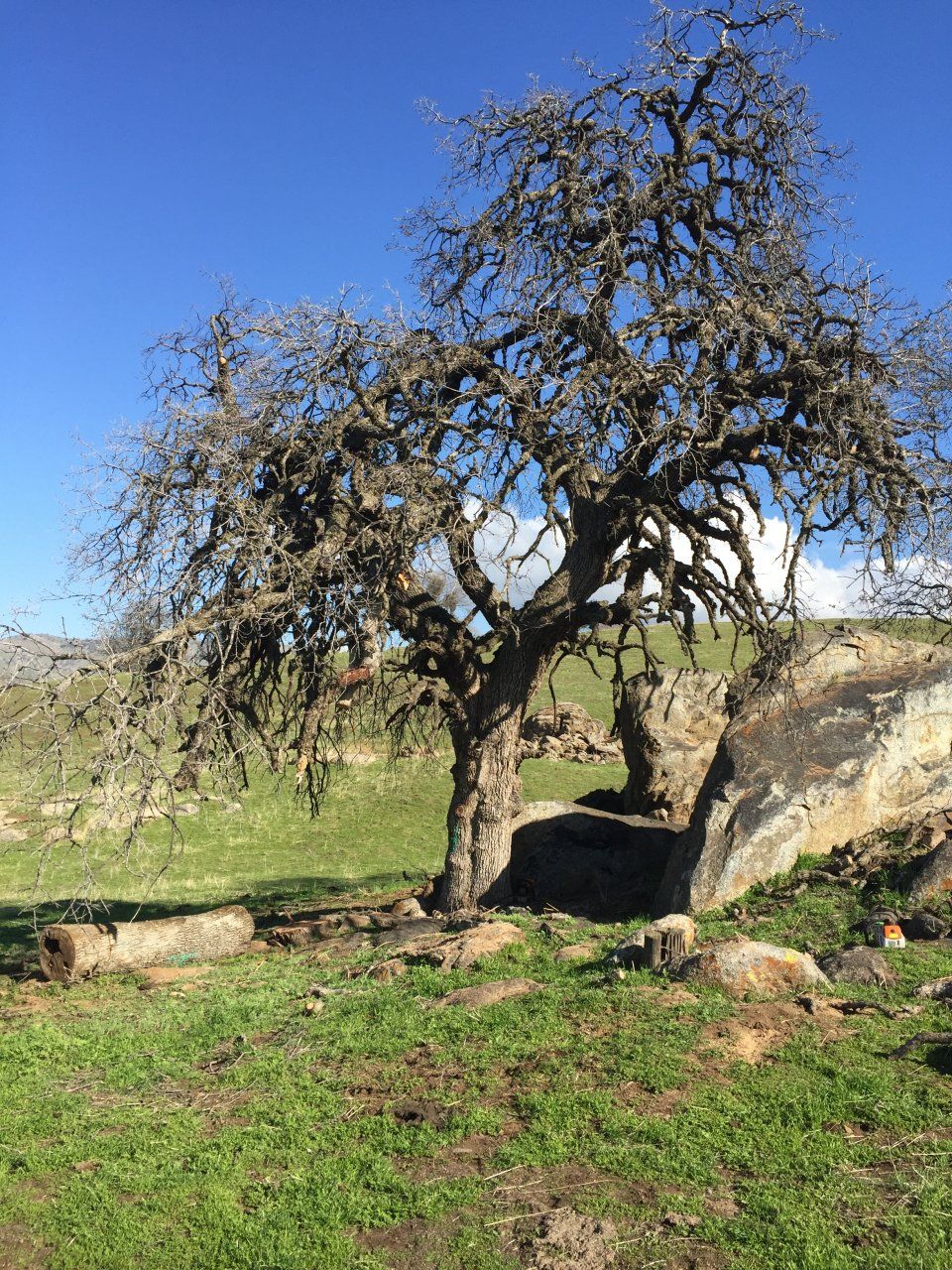

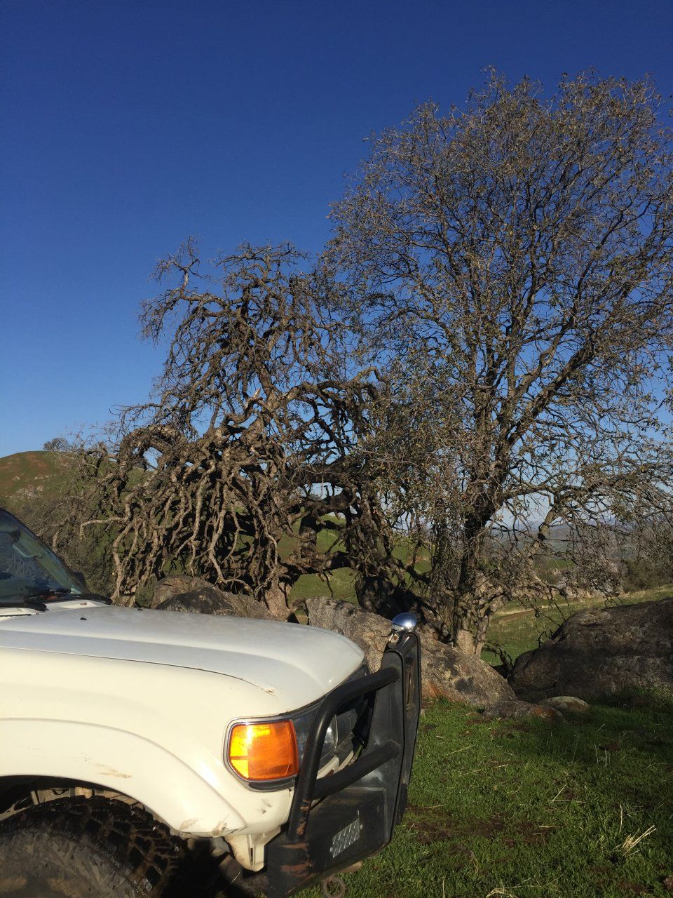

I'm a touch lazy and didn't feel like cutting firewood out of a rock pile.
I dropped it 90 degrees from rock pile.
Text book 2 cut face cut
Using Proper wedge placement and 6lb Collins I was able to jack the tree and drop it 90 degrees from where nature intended it to go.

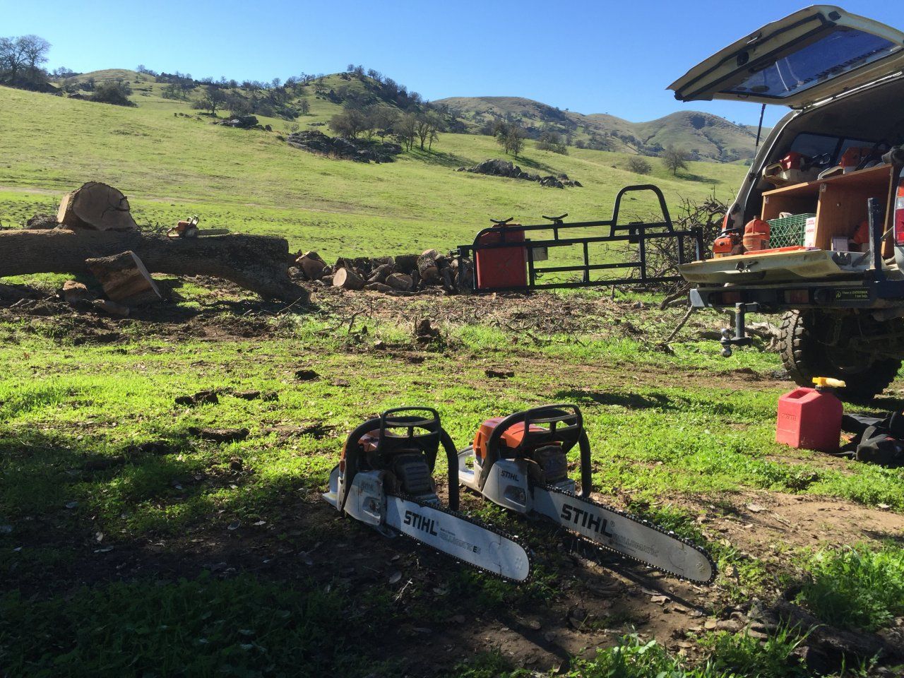

For size reference, that is an MS 660 w 36" B&C.
