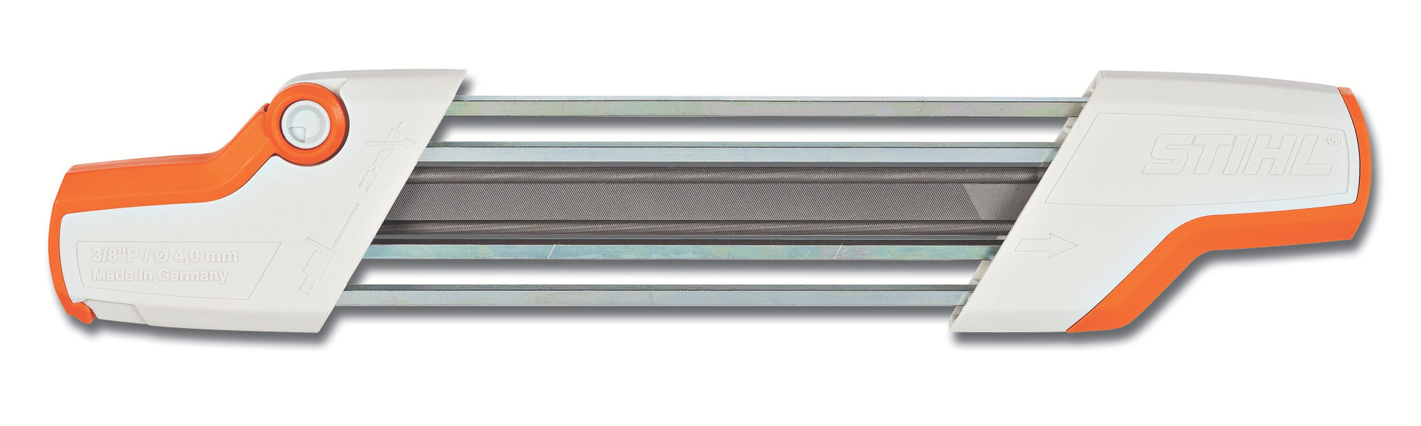

I've been enjoying cutting with sharp chains since getting one of these:
I also have a Oregon grinding wheel sharpener sitting in a box but may never need it as the 2 in 1 is so easy. If so it will get eBayed.
