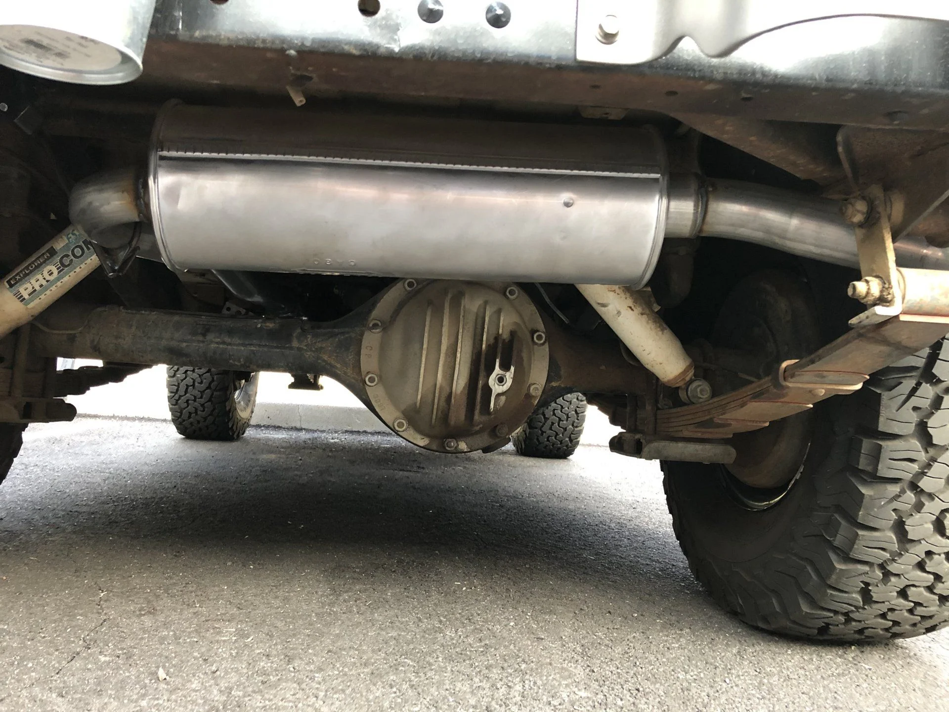

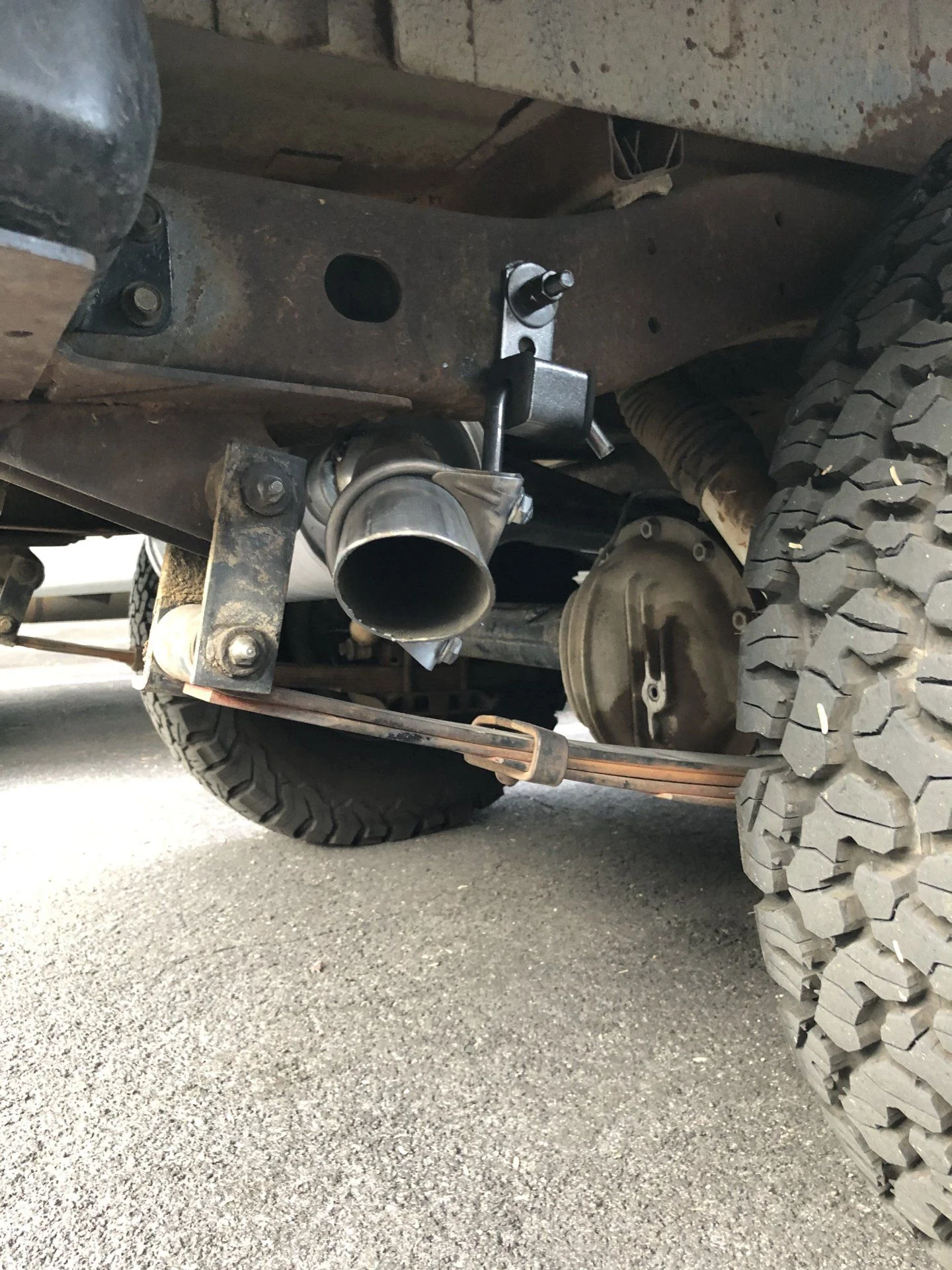

If you don't mind me asking, How much was a new exhaust? is a custom exhaust from an exhaust shop? I am looking at getting one done and I would like to know what other people have been paying.
You got ripped off. I had a new exhaust built from the manifold to the rear including muffler for $160. Plus it looks alot better than that setup.
