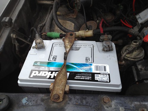

Today my old Duralast battery gave up the ghost... she made a valiente attempt to get BeBe started this morning in the 20* weather but alas she did not succeed.
But with my gift certificates from the in-laws she gave birth to a Diehard Platinum Group 34 P1!!

However, seems strange that I have what appears to be two fusible links on the positive terminal (seen as white and green). The green one I know is stock, but the other? Next for the electrical will be a battery cable upgrade from Fourrunner.
Oh and for those that may be wondering... approximate dimensions of the stock tray are 12.5"Lx7.5"W, I ended up having to make a small "booster" plate to have the battery sit on otherwise the holder would not touch the battery. So from my measurements, even a Group 65 battery (normally 12"x7"x7") will work there aside from possible height issues. Had I known that earlier I would have grabbed the Group 65 as it is the same price.

How much is Sears charging for said battery these days? I have a no name battery that seems to be quite robust, leftover from the PO, but have my eyes on your battery as a likely replacement option once it decides to go south. Any details on why you picked this one is appreciated.

The battery was $234 with tax, they do go on sale monthly for about $197 (of course that was last week) and it is usually a one day sale. I have found online that they go on "major" sale about once every three months so I was waiting for that, and when I say major sale I mean they can usually be had for about $150.
As to why I picked the DieHard Platinum, well it is made by Ener-Sys. From the research I have done the normal DieHard batteries are ok at best but the Platinum are their AGM style batteries and made by a very VERY good company that also primarily makes Odyssey batteries. I was going to go with an Interstate Mega-Tron II battery but once I got the Sears gift cards, I figured I would spend that same amount with the gc's and get a truly stellar battery.
No one answered you so I will.... I think you are a bit confused on what a fusible link is.
The fusible link is simply the wires between the white and green connectors. The connectors are present to allow R&R if/when it fails.
In other words... no, no, no... you don't have two fusible links... yours is exactly as came from factory.

That is what I figured dbleon thanks for answering.

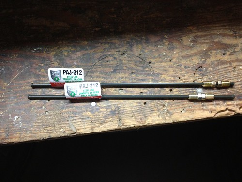

So the latest saga of the brake master is I finally got the RIGHT gasket but now I cannot find the right steel lines to go between the master and clutch slave since the flare nuts on mine are toast. From what I have found I believe they are 10mmx1.0 with 3/16 OD. Anyone know?!
G, pretty sure that is correct. double flare end also IIRC.

LOL.. this is now turning into a comedy! Got to NAPA to find the smallest length they have is 20"! Seriously, WTF! So looks like I am ordering online from O'Reilly as they are the only ones that actually list on their website and Autozone only sells up to 6mm in IMPORT specific sizes.

Funny thing, I ordered the hardlines online through O'Reilly and was there last night and told that they did not have the right sized line. Figured it would take a day or two so I had it sent to the store to save the TWELVE DOLLARS FOR SHIPPING, anyways just got an email that said they are ready for pick up at my local O'Reilly.

Steel Import Brake Lines from Brake Master Cylinder to Slave
Well they did have them after all. Funny enough the girl that helped me last night was there and said "your back?" I showed her the paperwork for the online order, she went in back and said "well here is why I couldn't find them, the sticker doesn't even list them as 10mm it list them as 4.7mm x 12" x 3/16"." So I went out and grabbed my m/c (since I had it in the car today) and tested the thread and sure enough..
So for all of you out there, these lines may also be under 4.7mm x 1.0 thread with 3/16" OD tubing (odd I don't get it)
Untitled by renofizz, on Flickr
Anyways, as I said above proper size is about 10mm x 1.0 thread with 3/16"OD tube, but may also be found as 4.7mm instead of 10mm.
