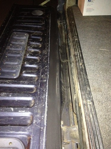

After putting down three layers of it just on the bottom lip of the tailgate I have to say that it has worked quite well. After a quick drive around the block there is no sound coming through the gap nor does it feel wet on the edge of the carpet. I remember this stuff being cheap and I actually bought it as a small amount of padding for the vertical stand that I made for our paddleboard in the garage.
Untitled by renofizz, on Flickr
Hopefully soon enough I can get one of the new weatherstrips from Kevin R or find one elsewhere.. but for now this does the trick and I think the 30ft roll was only like $10 from Lowes.
