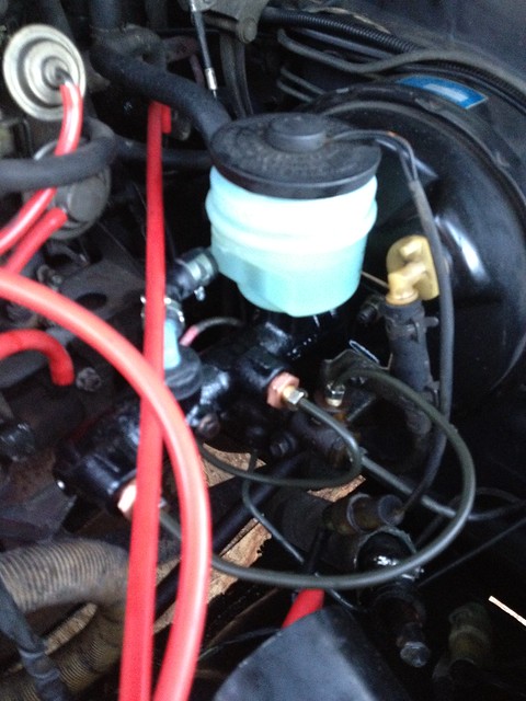

Well finally got around to replacing my leaking heater hose this weekend and my brake master cylinder.
All I can say is HOLY CRAP I HAVE BRAKES!!! The truck actually stops when I want it to!!

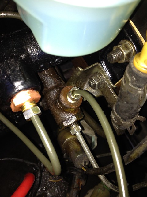

Here are some pics of the replacement. My hard lines between my m/c and clutch slave were stripped so I had to take those out and replace them. No big deal as they were about $6/ea from O'Reilly however it looks like the one that is on the drives side of the slave is leaking. New line in there? Kinda confused as to why because it threaded right in so it wasn't cross threaded or anything.
Untitled by renofizz, on Flickr
Here is the line that is leaking. No leaks anywhere else and it is enough that there is usually a drip of two on the ground when I stop. Only thing I can think of is that the threads are goobered up or the line wasn't in properly and seems cock-eyed which is creating a leak.
Thoughts?
Well the line from the m/c to the clutch slave is definitely buggered. Went out for a drive tonight and while stopped on a decline the brakes would slowly let out on me. Would start to roll forward and could feel the pedal give a bit, would press harder, rinse and repeat.

New hardline for the master went in early this week, too my time and used some old pvc pipe to help with my bends as it looks like the line was pulling on the flare nut in a way that was making it leak. Didn't have any problems after that and had a few days without any brake leaks!

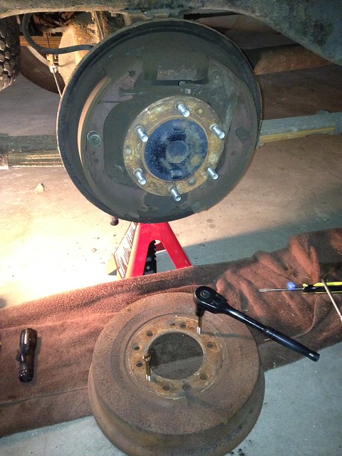

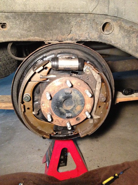

Tonight was the big adventure, did the rear wheel cylinders and new shoes. Total time took me about 5hrs with most of the time really being spent futzing with the star wheel and trying to get it loose to remove the drum. One shoe was cracked and I have one completely seized closed bell crank. Tomorrow when the wife is around I have to bleed the system then bed the shoes.

New vs old
The dirtyness
New Hotness..
The cracks...
G,
Those pics looked just like mine a few months back...
Yea but you put all new spring hardware and did new drums... Didn't have quite that much to do this so I figure when I get the new bell cranks I will get new drums and possibly spring hardware.
Not really sure I didn't pull to inspect but they are only $16/ea so figured I would really just replace the entire assembly.
I ordered a set of arms when I did mine and didn't use them. Mine were in good shape after I cleaned them. 20 bucks and they are yours.

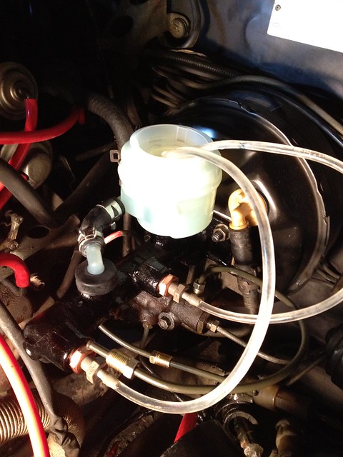

So got the wife to help me bleed the brakes and good thing as there was plenty of air in the lines after swapping the cylinders.. However something still doesn't feel right. Took it for a spin and I definitely need to adjust the pedal height and everything per the FSM but I feel like I have more travel than I should, which again I think may be from the pedal height problem.
The other thing I noticed was that under HARD braking I felt a pop towards the bottom of the stroke, but only during HARD braking. After that the pedal goes back to feeling the way it did before the pop. So I am wondering if one of my caliper boots or seals is trashed.

G, you probably did this and I know we've covered it somewhere before. Bleed from the furthest line to the closest with slow and steady pedal pushes.
You beat me to it! I was going to say that line looked angled a little too far to seat right. I had that same thing happen when I bent up new fuel lines for my truck.
