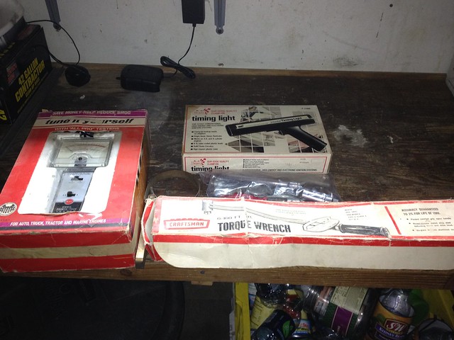

Last weekend my parents came up for the birth of my niece. While in the waiting room my dad and I were talking about the Land Cruiser and why I had bought it. Basically, I told him, I was tired of having to take the car to the dealer or mechanic anytime some random light came on and have always loved this particular series Land Cruisers. He asked if I had all the tools I needed, and I told him that I didn't yet but was going to need things like a timing light, torque wrench, etc. so I can do the timing on the LC, do a valve job, replace all the shoes/pads, etc. And he got an excited look on his face and said, Ok next time we are up I will bring you a care package!!
Well they came up last night and here is what he brought to me..... (mind you these tools are as old as I am if not older)
Untitled by renofizz, on Flickr
Old tools are the shiz
I have a few from my grandpa and uncle. Inch-pound torque wrench is my fave. Need to use it on my oil pan just to check it :)

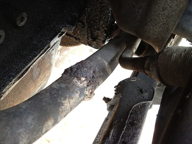

I was seriously surprised at how smooth she ran. But there does seem to be a tick when I open the hood, which I believe is an indicator of an exhaust manifold leak (if I can ever figure out how to embed the damn video). So looks like after baselining the brakes I will have to tackle that exhaust leak, but I did notice a large clump of "crap" on the downpipe. I am assuming that one of the POs attempted to fix some leak or hole in the pipe and this is the result..

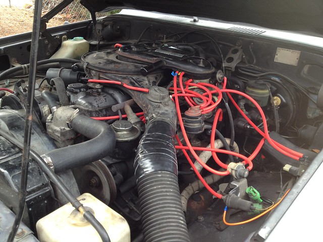

Oh yeah and here is the after shot for a little more desmog porn!
