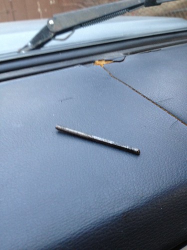

Now the speedo cable is another issue. Whatever you do DO NOT buy the cheap aftermarket one from CCOT. Mine lasted all of 4 months before it broke. When I pulled the cluster today here is what I found.
Untitled by renofizz, on Flickr
So looks like Kurt will be getting an order from me soon for a new OE one.
