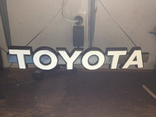

Here is what the "TOYOTA" emblem looks like after spending two days sanding off the fat amounts of paint that one of the POs caked on her. This weekend I will take off the grill and work on that, guess I will be blacking her out after all.
