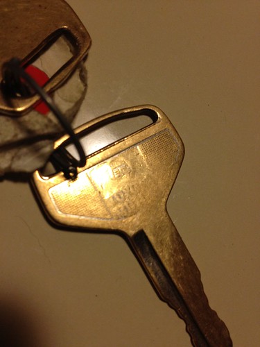

1. I still have the original master key! Has the TEQ on it and everything (though quite rubbed/faded)
Untitled by renofizz, on Flickr

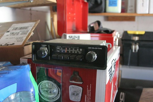

2. The guy I bought it from still had the original stereo that came with it! He said that he believed it worked but I didn't try it.

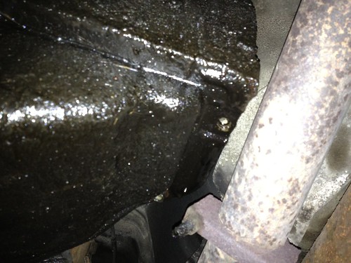

However, I did find the first bad thing. While I was under the truck looking at where the speedo cable entered into the cab I noticed something out of the corner of my eye. Granted I knew there was a lot of grime and dirt under the truck, and it was fairly fresh but I saw no where that seemed to be leaking more than another and nothing was leaking more than a drop or two here and there a day.
Well I found where/why one section is leaking. This is the bottom of the tranny I believe. No Bueno!!!
So the question is, how are is this to fix (have to drill out the old bolt and then tap it I am assuming) and is it something I should attempt myself?

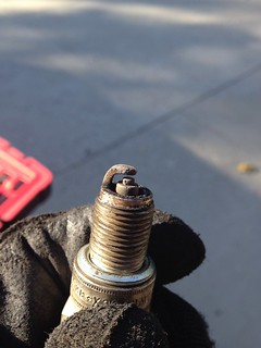

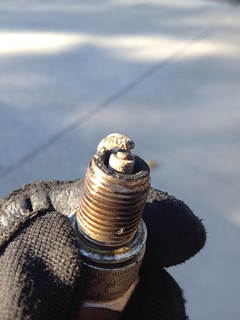

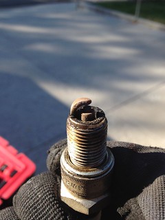

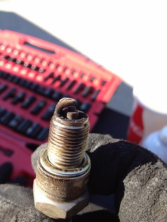

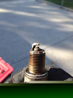

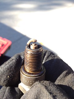

Ok and here are pics of the plugs:
Cylinder 1
Cylinder 1 by renofizz, on Flickr
Cylinder 2
Cylinder 2 by renofizz, on Flickr
Cylinder 3
Cylinder 3 by renofizz, on Flickr
Cylinder 4
Cylinder 4 by renofizz, on Flickr
Cylinder 5
Cylinder 5 by renofizz, on Flickr
Cylinder 6
Cylinder 6 by renofizz, on Flickr

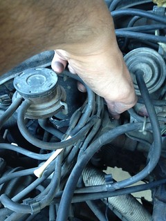

And wanted to make sure this is correct for the "golf tee fix"
Golf tee fix by renofizz, on Flickr
