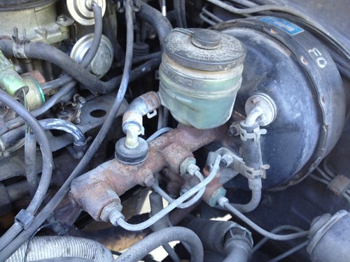

You'll definetly need to bleed the brakes, possibly even "bench bleed" the master if any air got in there.

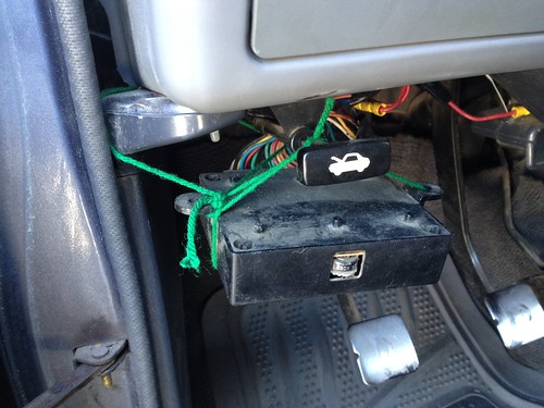

I am hoping that the box is something like that but wondering why I would hear buzzing coming from it when I use the heater? I got to save up some money to get some speed bleeders and then do the passenger side knuckle. Noticed that is leaking a couple drops of oil each day on the ground so it is pretty much shot.

Ok thanks Georg that is what I figured. Is there a good tutorial on "bench" bleeding the system on here?

Quick question on bleeding the brakes, because it has been YEARS since I did it with my dad, if I remember correctly you pump the brakes a couple times (while synchronizing opening the valve) and then push it all the way to the floor, correct. I should start with the furthest from the the m/c so LR,RR,FR,FL and do 3 pumps then push to the floor? I know that some people are different on how they do the process but this is what I seem to remember.
project. It should be LR,RR,FL,FR. Check where your brake lines goes down to your front diff, it's on the passenger side, so the front driver side is further! At least it is that way on mine!LOL.. very nice J... I am sure she was distracted by a text or something.
