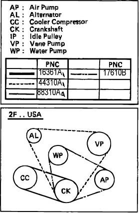

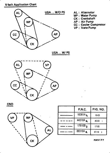

Ok after looking around on ToyotaPartsOverstock.com I found a different V-Belt diagram for the US 2F (with and without PS).
So If I am reading this right I need the following belts:
- Cooling Compressor (CC) to Crankshaft (CK)
- Water Pump (WP) to Air Pump (AP)
- Alternator (AL) to Vane Pump (VP)
V-Belt_Alternative by renofizz, on Flickr
With this diagram that is belts: 88310A, 17610B, and 44310A respectively. But when looking at their site, there are 3 for each number.. SO CONFUSED!
