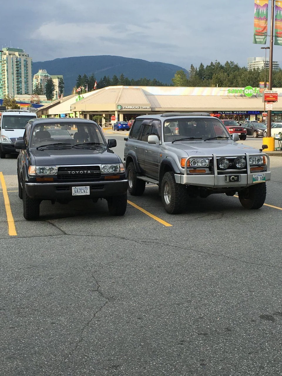

Was looking through my pics and figured I'd throw some more up from our summer roadtrip, on this cold day MB. Can't wait for next summer!

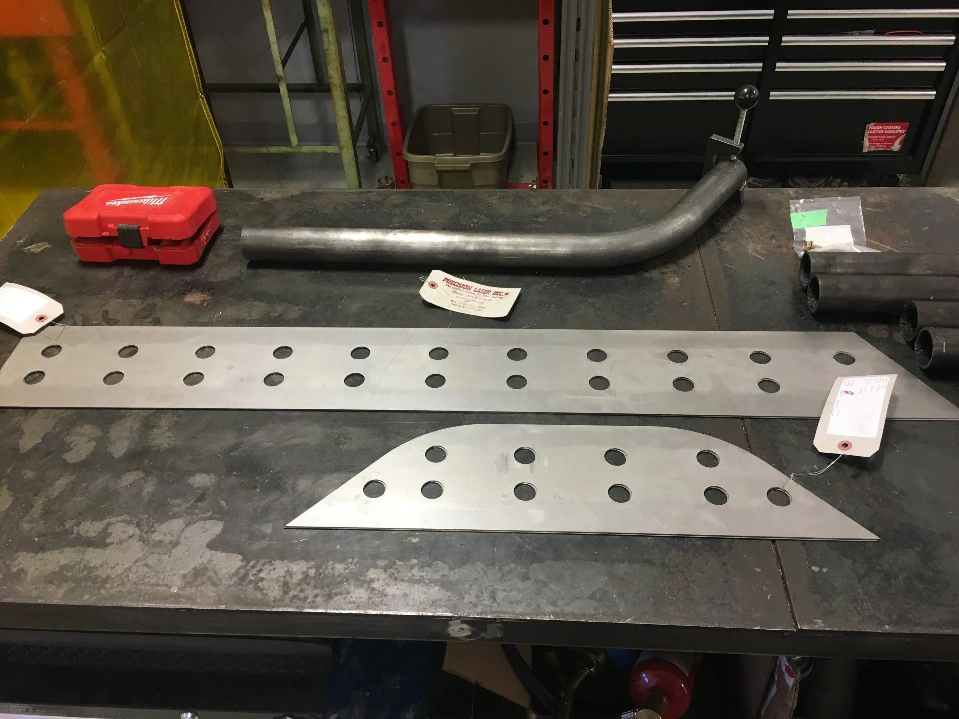

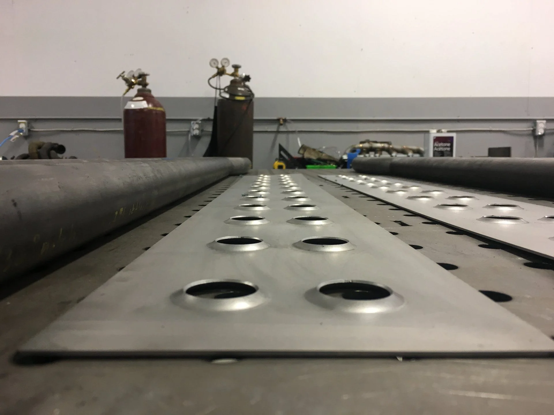

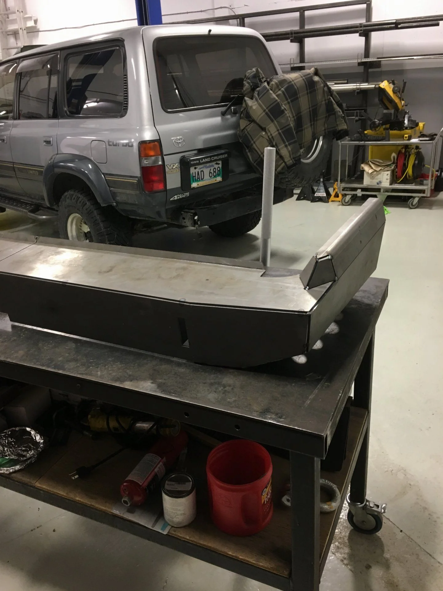

Dropped the truck off at Arclab again last night, the metal is back from the cutter and they are going to be tacking up my rear bumper and sliders over the next few days! Also having my front Fox IFP's rebuilt as one leaked it's fluids everywhere in the fall.
I'm going to have the front bumper powder coated the same color as the rear, I haven't picked the color yet but thinking a shade of grey or graphite to match the belt molding on the truck. The sliders will be done in black.

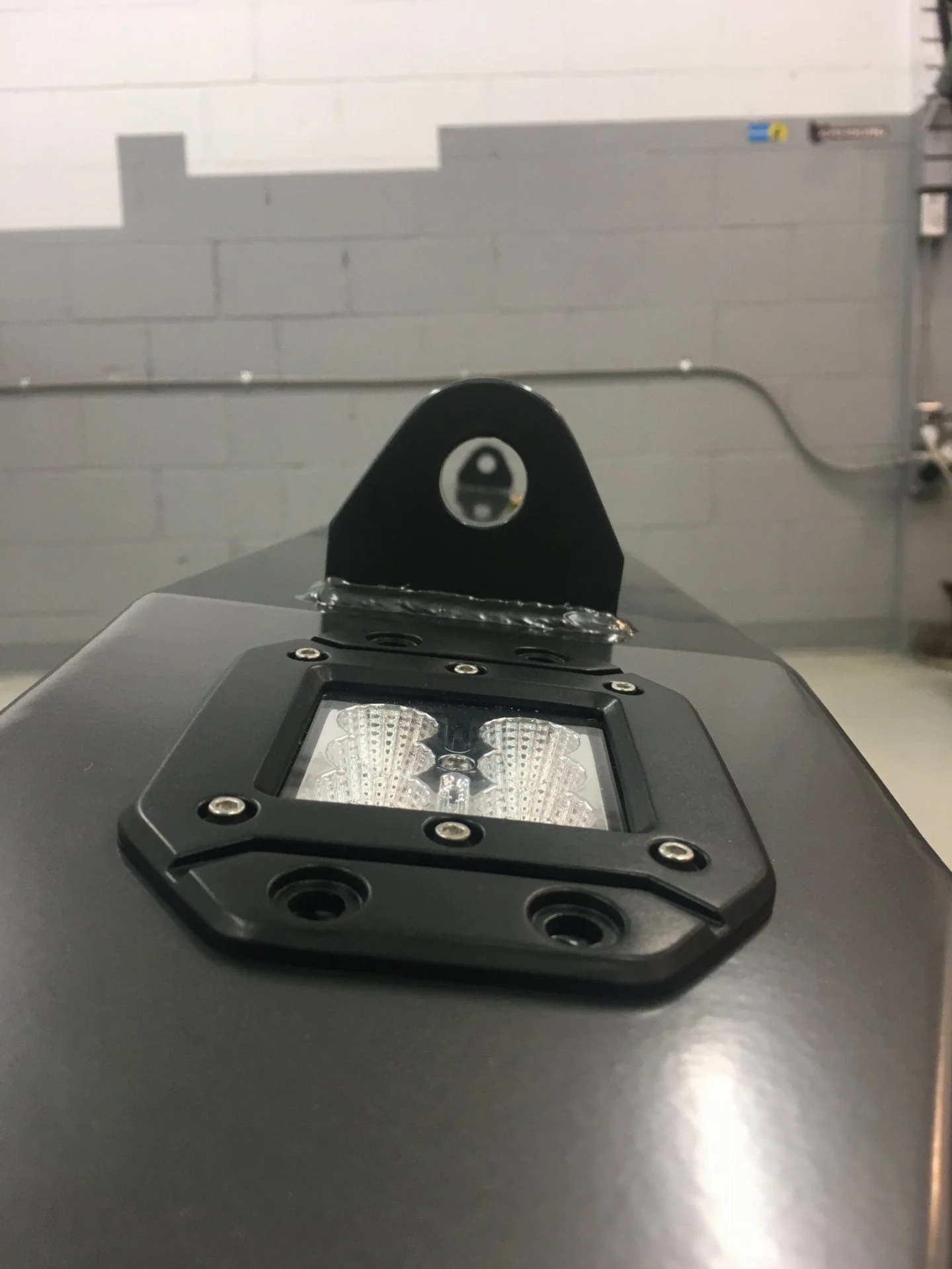

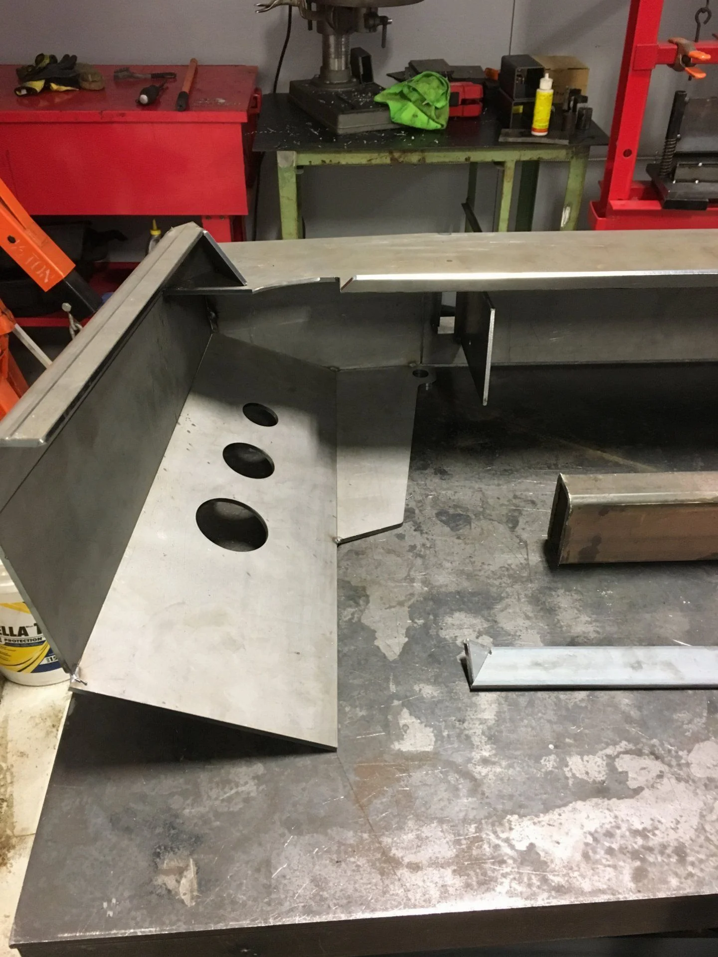

Another quick progress pic of the sliders and the top plate for them!

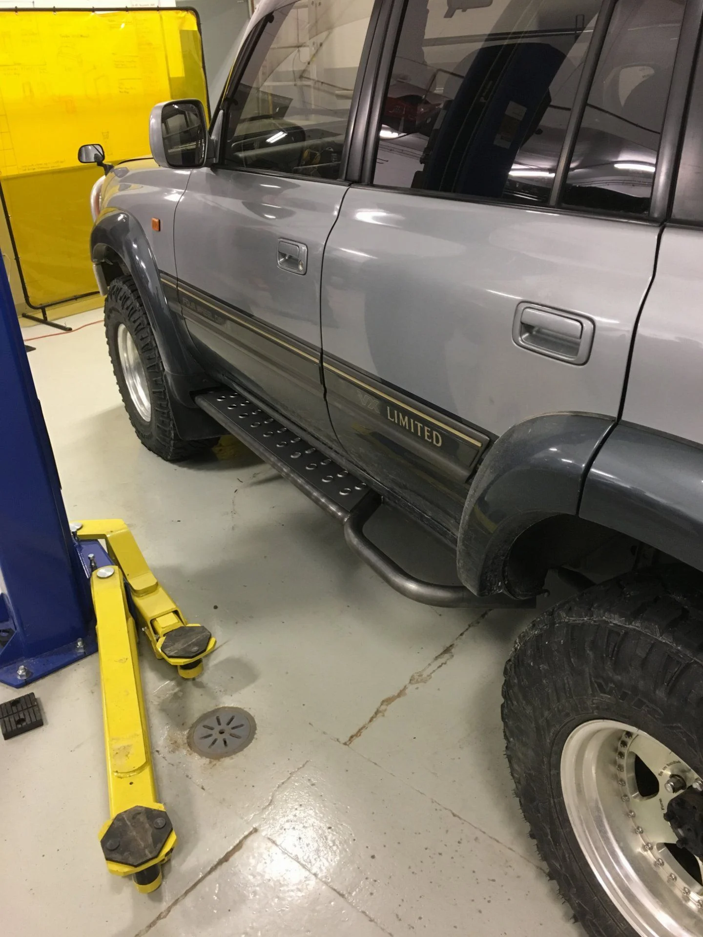

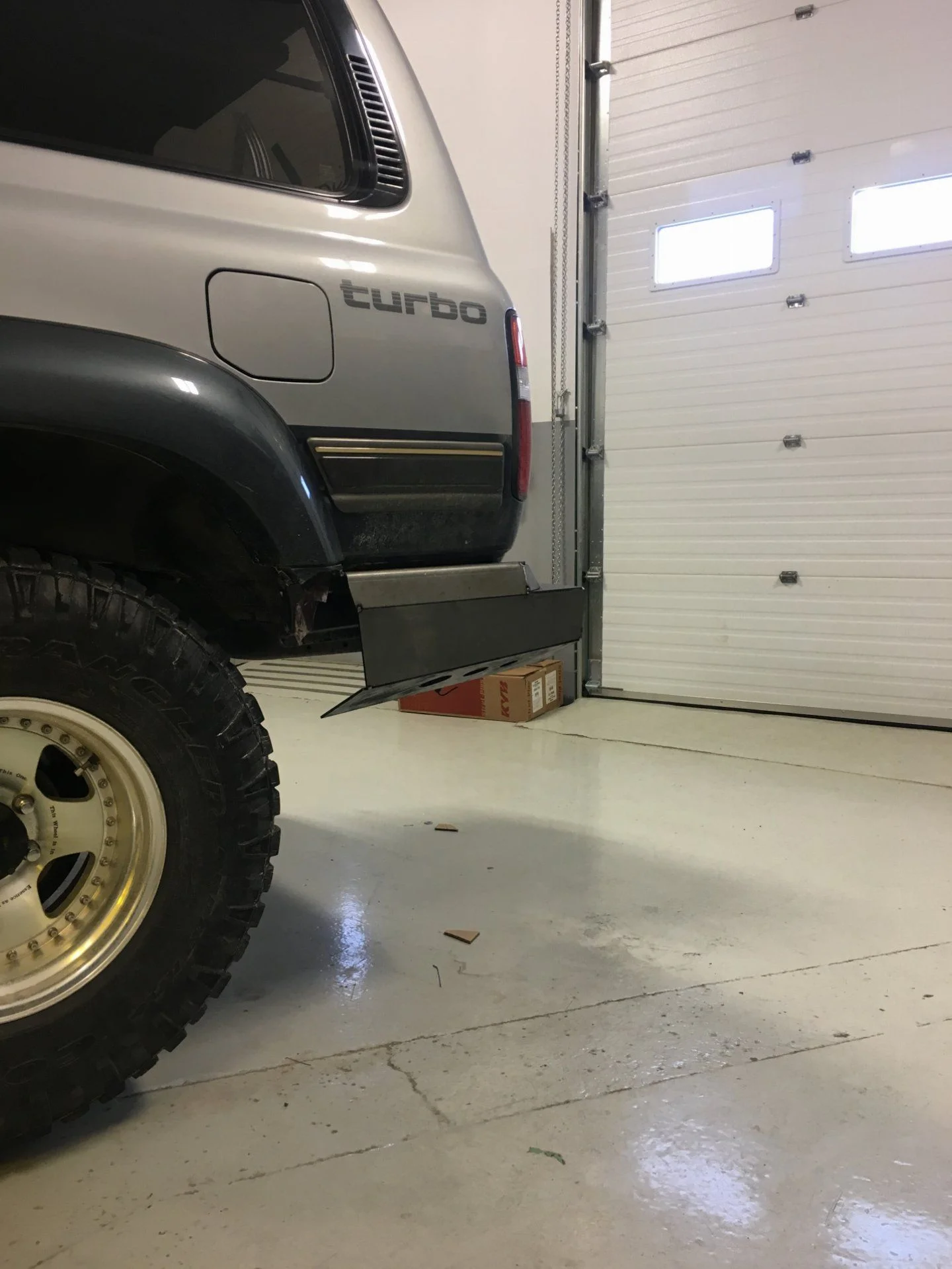

Got the truck back last night, sliders and rear bumper are all tacked up now, and look great! Once their all welded it's off to the powder coater! Getting close now!

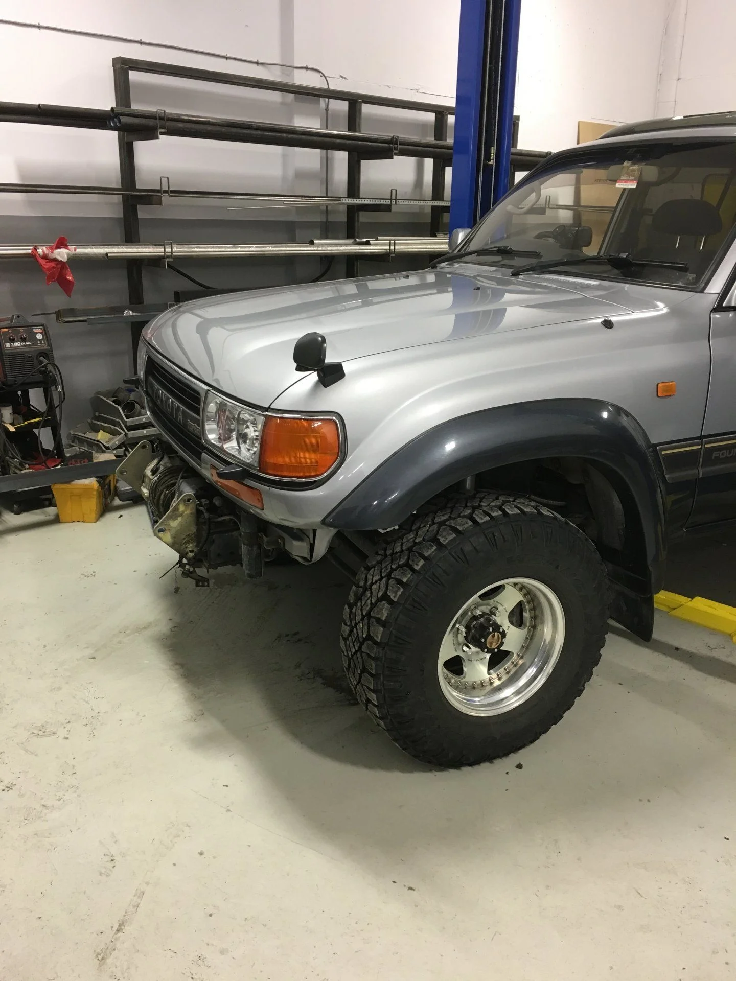

Back at the shop last night to fit the tow receiver, add some tabs for the mudflaps to attach to, and pulled off the front bumper so it can be sent out for powdercoating with the rest. Front and rear bumpers, and sliders will all be done in gunmetal, a very close match to the front grille and side molding charcoal color. I'm really happy with how it's all turning out, and excited to see the truck all back together finally!

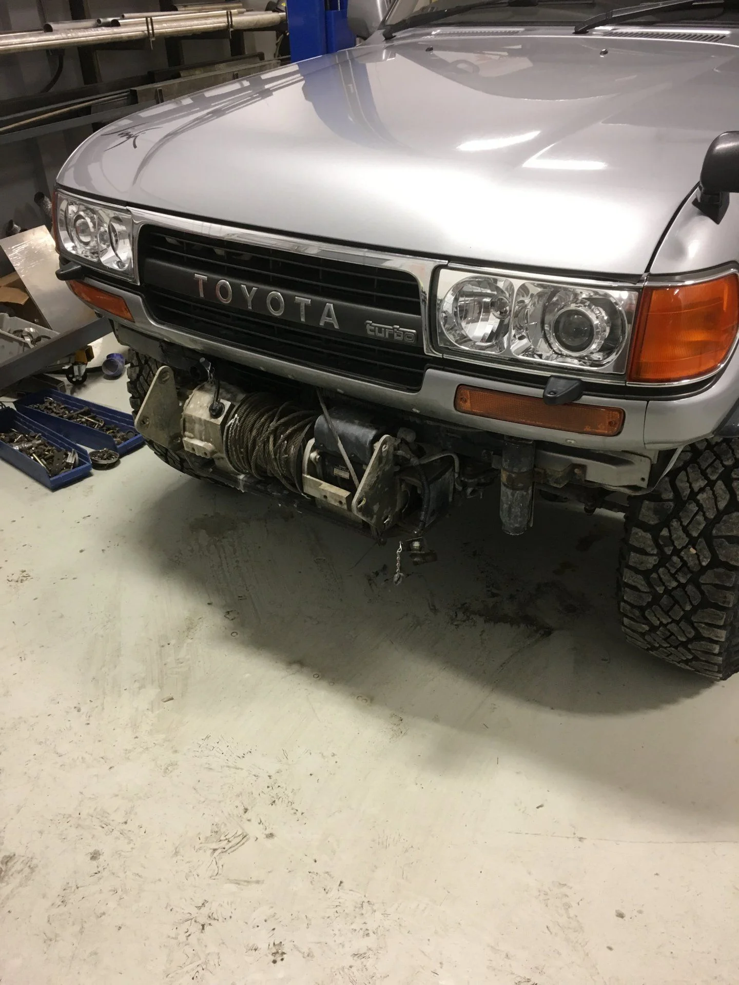

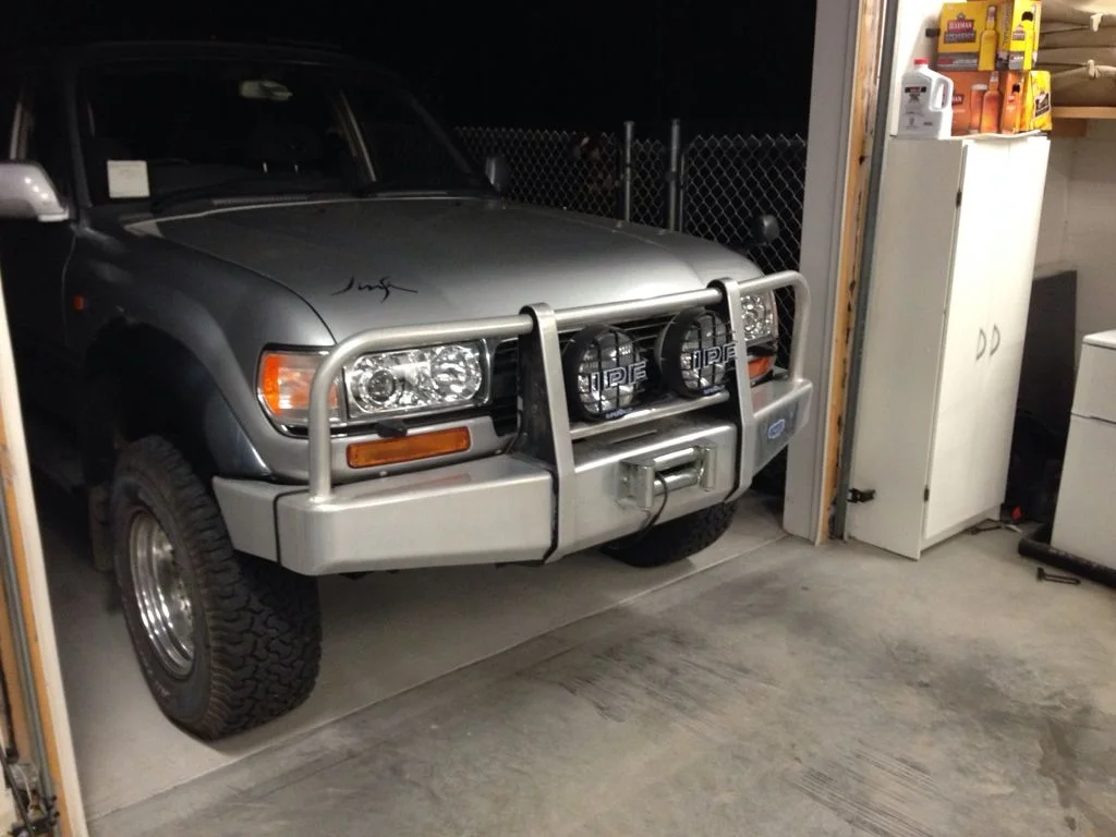

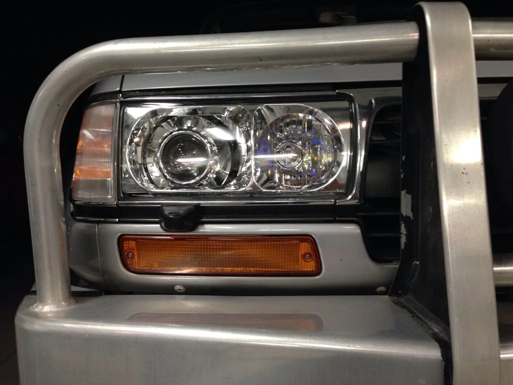

I've been waiting for a conversion harness to put some FJ80 headlights in the truck to pass safety, but a series if miscommunications resulted in that not being shipped out. What I do have is the harness to connect my retrofitted DEPO's, so that's what happened last night!
The DEPO's have e-code markings on the lense, but I fear the retrofit could cause issues for the inspector, I guess we'll find out.
Install was fairly straightforward, but I think one of my high beam bulbs isn't properly seated, and the high beam on one of the bi-xenon projectors isn't working, so I have some fiddling left to do.
Here's a before pic of the JDM headlights (H4 low/high, H3 fog), then one of the new units (bi-xenon projector/H1 high) with new LX450 corner lights, then with the OEM orange corner lights, which is what I ended up liking best.
They need to be aimed badly, should get a chance to mess with that this weekend.

They are DEPO's with a bi-xenon HID projector retrofit. Very impressed with the output on these!

No, I had them done by a user on MUD who is no longer doing them. I had some issues with the highbeams blowing the headlight fuse that ended up being related to the way the harness was set up, but it's resolved now and they work great!

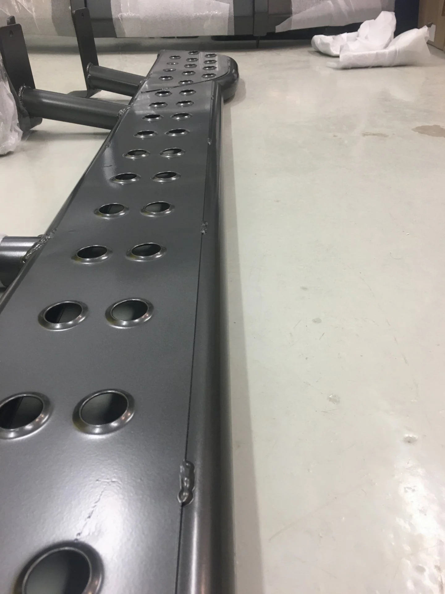

Big day today, bumpers and sliders are back from powdercoating, so I've taken the afternoon off to install it all. Here's a few teaser pics the shop sent me, better pics to follow once they're on the truck.
