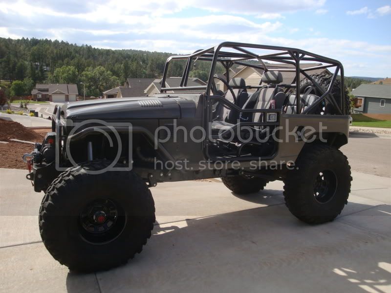

Started with a blue 76 that was in "ok" shape. Like a lot of people here I started out intending to make a few minor mods and get it on the trail.
I soon fell victim to the "while I'm in there I may as well replace..."
FIVE years later and after a lot of doubts, frustration and work it finally came back together. It's not completely finished but it's probably 95% there :D
It was a lot of fun but I'm ready to drive it and not work on it anymore!
Details:
76 FJ40, kept the original 2f - desmogged
built a new rear tub from 10 gauge steel
wheel base stretched to 110"
custom gas tank under rear tub
fenders, bumper and roll cage are custom made by a friend
front seats are out of a Supra I think
Longfields in front
doors from Redline in Colorado
stock transmission and transfer case with Marlin Toy Box
hydro assist stear
SOA front with Proffits 4 link rear
driveshafts from Jesse at high angle
Irok 39.5 on 16" 2.5 backspace wheels
windshield frame isn't painted yet
Lots of blood sweat and tears including from a couple of friends
Now you can finish the front yard - or have you heard that before??

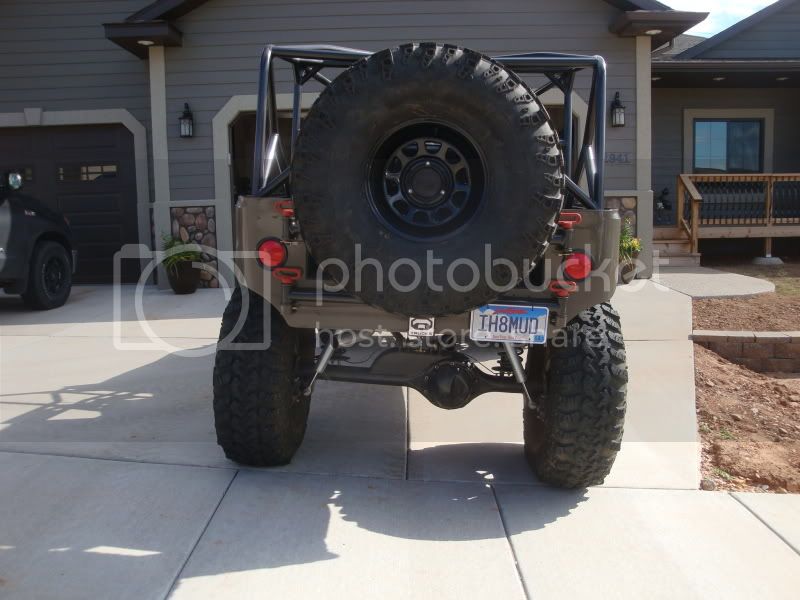

Any shots of the custom tank? I did one too in mine.
BTW, that color is awesome!!
One of the best I've seen for a cruiser!!
5.29's in the diffs so it gets around ok. It's no interstate cruiser thats for sure! Final ratio in lowest gear is 180:1
It handles quit nice on the road actually. I did have the front axle cut and turned. I think I posted pics of the gas tank on here somewhere. It sits up above the links and in front of the rear axle. I just welded up a rectangle and used the stock sending unit.

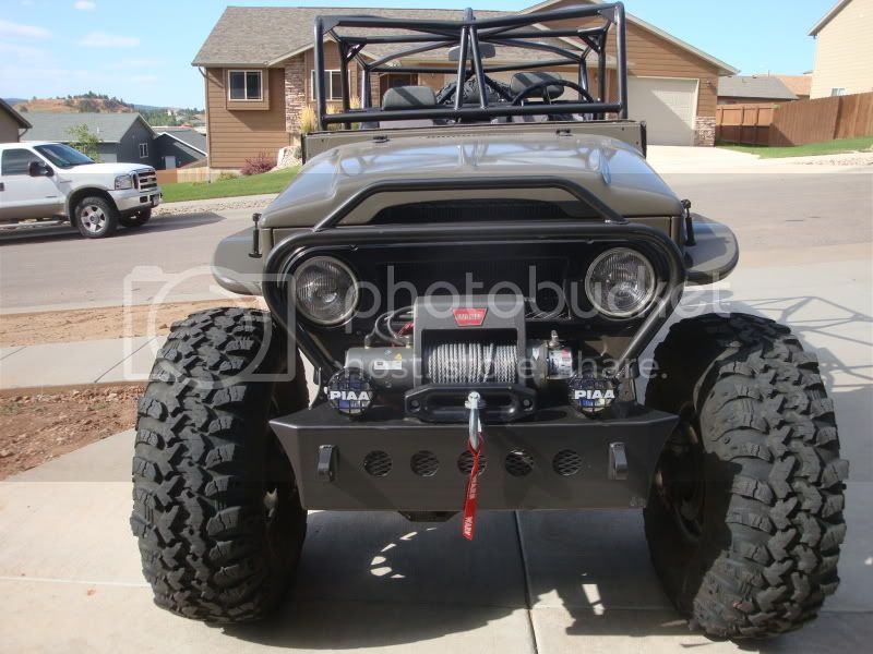

Only thing I don't like is the front bumper (hangs too low.)

The front bumper is plate steel that wraps just under the front spring hangers to act as a skid plate. It's probably an inch or less of clearance sacrifice. The pic does make it look like it hangs lower than it is. So far I haven't hit it on anything :D

thats the most creative, functional, and cool looking front bumper ive seen yet. king kong ?? humm looks like you may have a name there.
