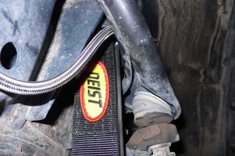

One more pic showing the front shock to upper inner control arm clearance. The smaller diameter shock housing allowed the control arm to droop slightly more than with the OME's.

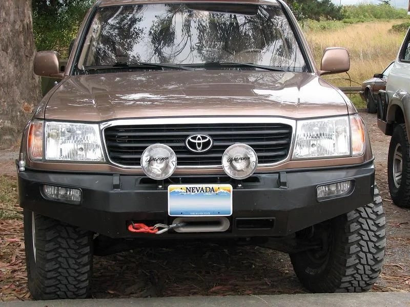

That's a nice sharp looking rig at Oysterfest I took last month.
Cheers,
Thanks! I wish it looked as good now as when I first drove into the parking lot for Oysterfest ;).
