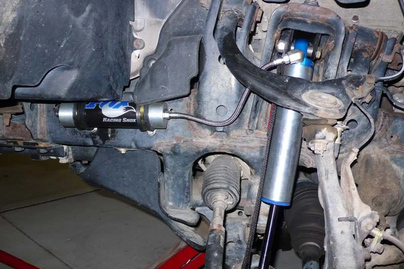

Got the Fox shocks installed on each corner. Haven't had them in the dirt yet...but they sure are an improvement over the OME's on the street! I, not being a suspension guru, thought the problem in the front had to do with not having a stiff enough t-bar. However once the Foxes were driven it became apparent the OME t-bars are fine. It was the heavy/sticky rebound of the OME's that made the front end slow and dull. The Foxes translate into much quicker and lighter feeling front end...even though they are MUCH more compliant. This is just out of the box valving. So I'll see if tuning is needed after some time in the dirt.
Sam and his crew did a great job fabbing the upper front and rear brackets. No cutting was needed. And if I ever want to reverse the path back to post style it's a simple deal.
These are the fronts.
