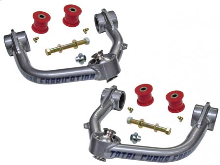

The 4Runner uses coilovers, and their UCA's are different. The coilovers will 100% not work.
The UCA don't care what type of spring you are running. I'm not saying they are interchangeable, but they could be...
This is the Total Chaos 100-Series UCA:
This is the Total Chaos 4Runner UCA:
They are obviously different, but they are close enough that it is possible to make on work for both as long as the mounting points are in the same place...
