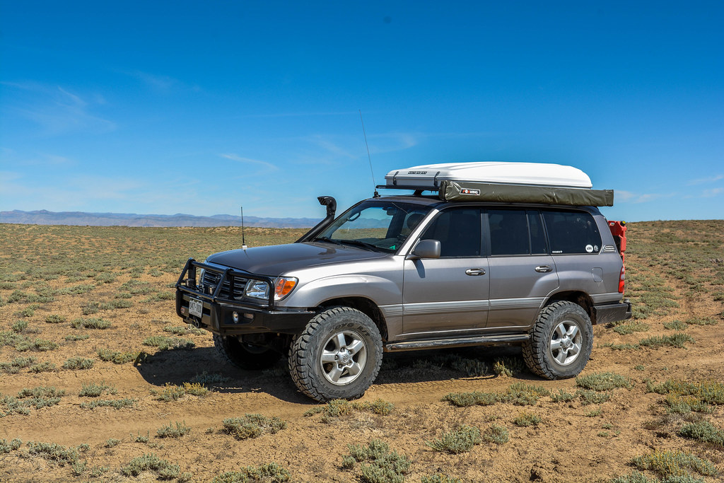

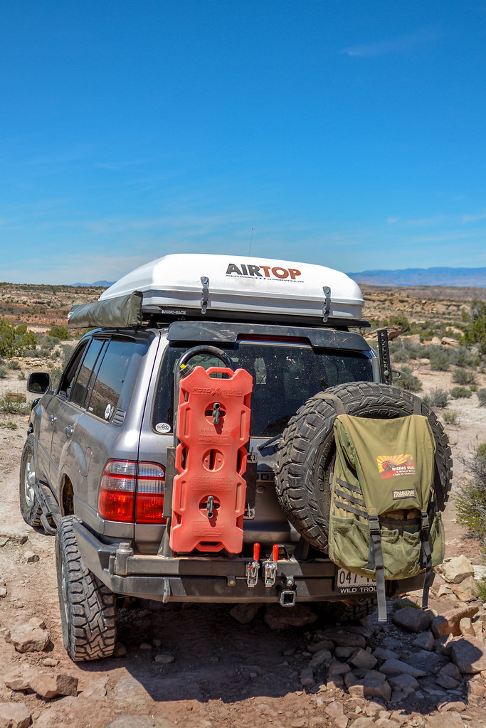

It's been a little while since I've made any updates here, but my 100 has gone through a few changes. For the first time since I've owned this truck, I have a different rack than the original V1.0 Gamiviti Expo (one of my first mods). I switched over to a Rhino Rack aluminum platform for a while but still have the Gamiviti standing by. The Rhino Rack was a little larger and I was interested in trying a few of their accessories. So far, I've been happy with it. It is a little more difficult to find places to strap things down unless you're using their proprietary clamps and straps. I also needed to drill holes in the floor of the rack in order to attach the roof top tent. The Gamiviti didn't require any of that. It's basically ready to go as soon as you bolt it up. This is a very nice, full length rack with literally thousands of configuration options though. That's ultimately what moved me in that direction for now.
I also decided it was time for an awning. Rhino Rack handles the Foxwing line in North America, so I was able to get everything together. The Foxwing connects to awning extensions and sidewalls as well as the Foxwing/OZ Tent. This gives me and my family a huge, fully covered area around the truck with a full ground tent attached. This allows all of us (and two crazy pointers) to camp from one vehicle. My wife and twins in the Autohome RTT and me, my son and our dogs in the attached ground tent. Pretty sweet setup, but it's not something you'd want to set up and break down every day.

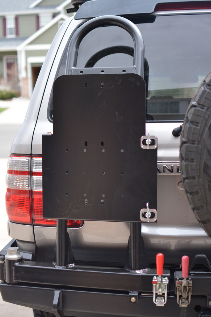

The Autohome RTT is very nice. There are some things that I liked better about the fold-over type RTT, but I can go from the driver’s seat to my sleeping bag in about 1 minute with the Autohome. The downside is that you lose all of your roof rack space. I used to carry my extra fuel up top, but that won’t work with the Autohome unless you get the Extreme which comes with load bars on top. Instead, I finally caved and put the Slee ladder/swingout on. I was holding out for years because I didn't like the idea of opening both swingouts every time I needed to get in the back. It hasn't been nearly as bad as I imagined. I'm back there opening the single side anyway, so it only adds about 5 seconds. I also decided on the Slee Rotopax carrier that pivots open and out of the way so the ladder remains useful. This helps when I forget the Autohome ladder, or I pack the tent full of sleeping gear and want to leave the ladder out to save room.

That extra weight kind of forced me into heavier springs in the rear. That's something I've been trying to avoid for years. More now than ever, I'm looking for a smooth and comfortable ride. I added OME 863's in the rear and upgraded all the bumpstops to Timbren's new Active Offroad bumpstops. The ride feels exactly the same as it did with the 860's and my bottoming out from the added weight is gone. Smooth as silk.

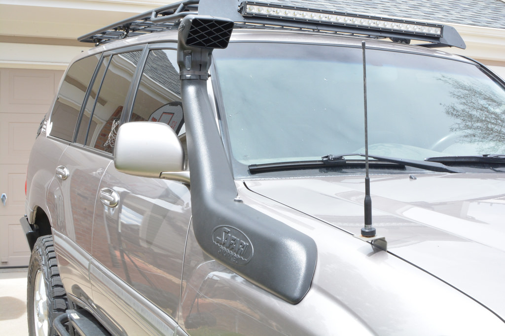

I also added a snorkel and ARB diff breather kit, although I'm pretty sure I'll never need it. I hate water crossings, but I do drive on some pretty dusty trails, so that's probably reason enough.

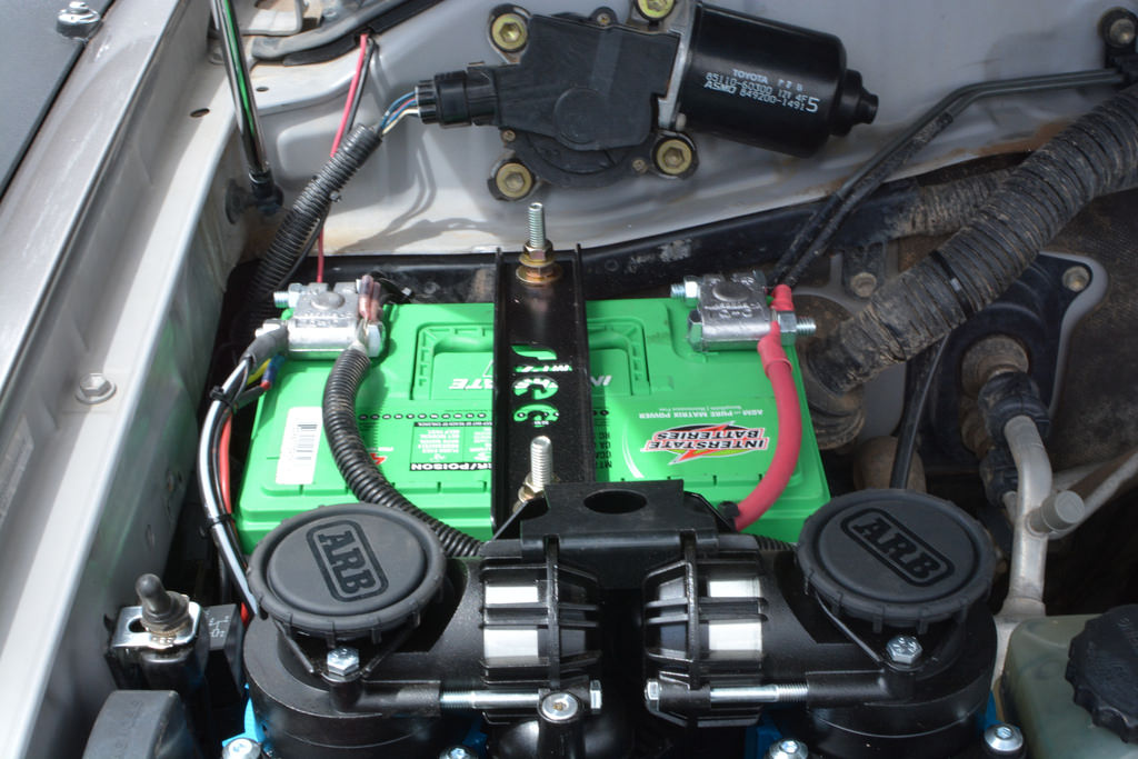

I had a very basic dual battery setup that is explained a few posts back. I still have a basic setup, but I'm not much for high tech electrical work. Fortunately for me, Joe Risavi, the lead tech at Slee is. Joe installed the new Slee Dual Battery tray that is designed to fit the ARB single or dual compressor. Now I can leave my Powertank at home. (Powertank's are great for running air tools arounf the house, in the garage or on the trail.) Joe rewired everything and installed the dual compressor and new battery disconnect. I'm super happy with this new setup. It's clean and simple.

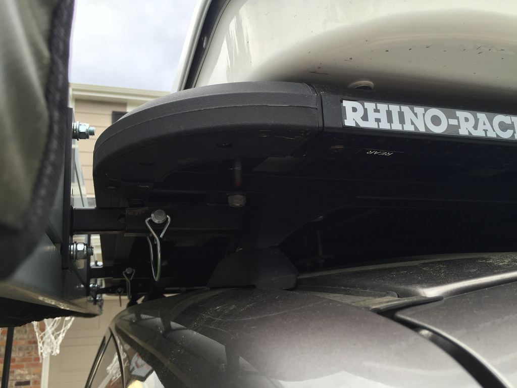

The Gamiviti rack receivers are one of the best new products on the market. They allow you to install and remove an awning by yourself..... in seconds. Roof Rack Receivers
I r&r my awnings a lot because I can't fit in our garage with them on. Plus, I hate dragging all of my gear with me if I'm just driving around locally. If you own an awning, there's no reason not to own these rack receivers.

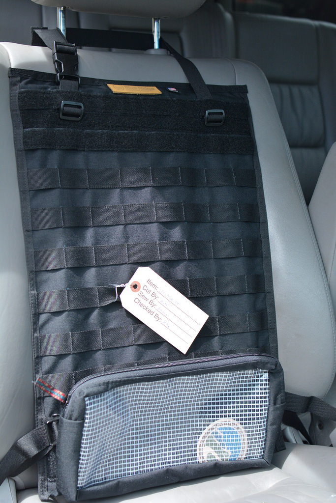

I hate digging around for lost items, especially on the trail. I'm trying to be a little more organized from the front seat. I always have stuff that I need just riding along on the front seat. One steep descent, and it's all on the floor. Blue Ridge Overland Gear is making some super nice items for organizing and carrying gear. I picked up a MOLLE seat back panel and a clear pouch from them recently during a sale. Instead of running it on the back of the seat, I run it on the front. This obviously only works when I'm traveling solo, but it's super nice to have either way.

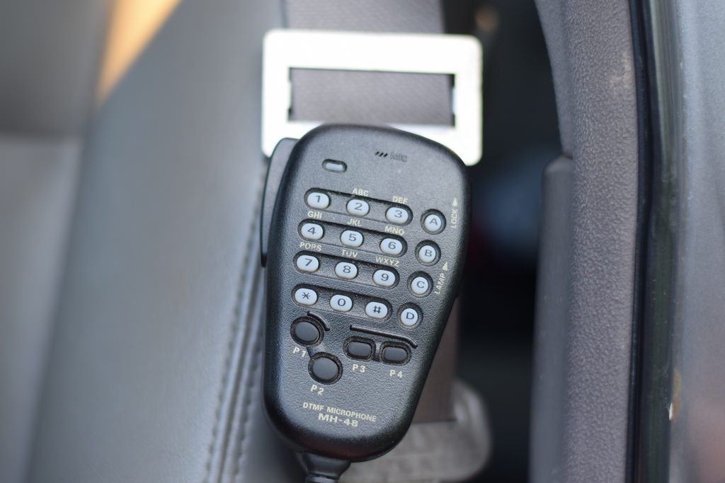

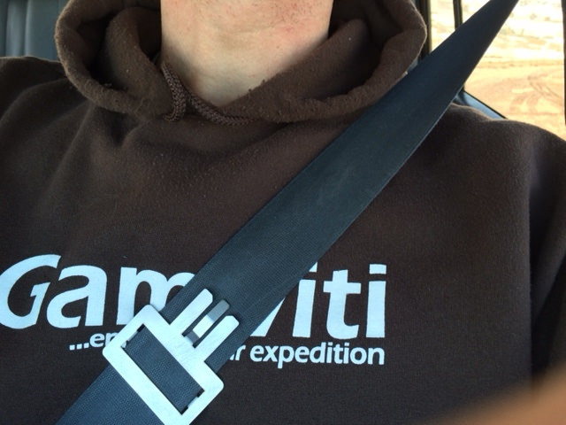

My other cluster up front is two comm speakers and two mics. One for ham radio and one for CB. Once again, @nakman of Gamiviti had a solution for me. A seat belt mic holder! I can keep my ham mic (or whichever one I'm using more often on that particular day) attached to my seatbelt. I can just reach down, key up, talk and unkey. I don't have to hold anything near my face or fumble around looking for the right mic to grab.
