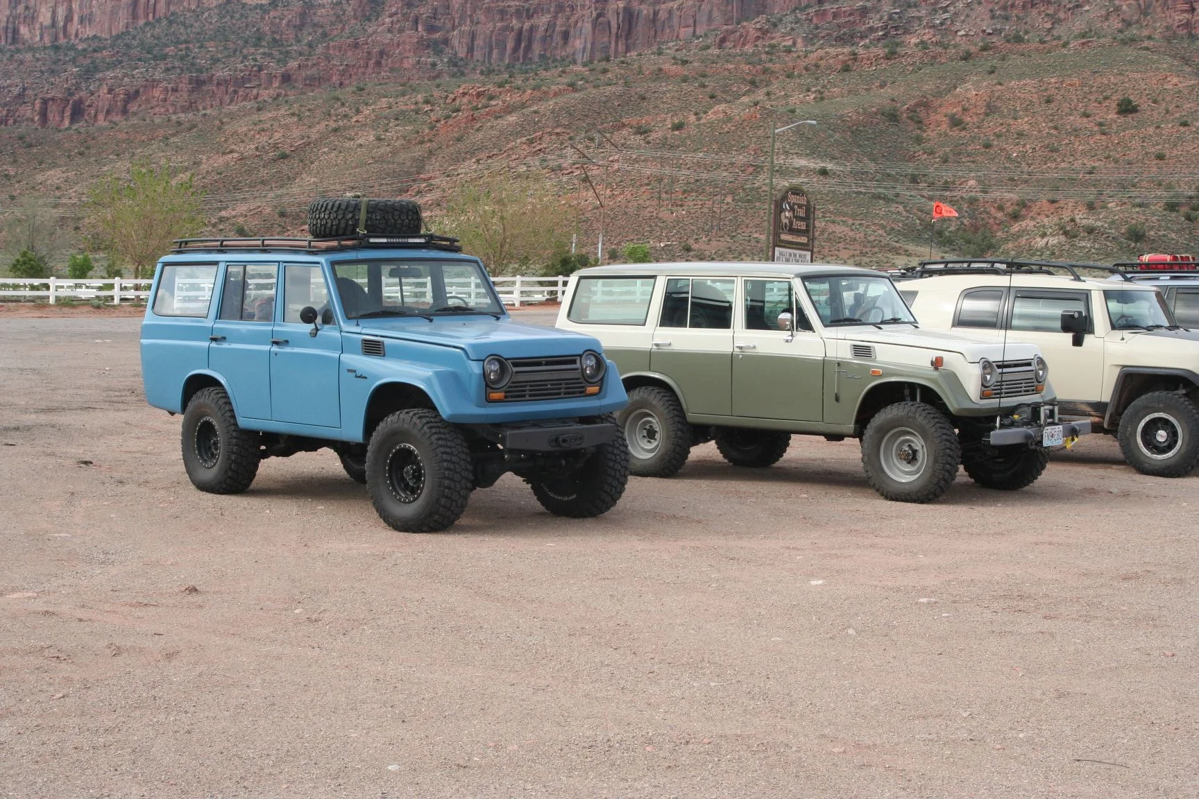

Here's an example of the low-e glass, it does have a tint to it. I didn't care for it, but have grown used to it. Mine's the green one with the low-e glass.
To be honest, I really don't know. The 55 stays pretty darn cool inside, but I think most is due to all the Lizard Skin everywhere. The e- glass is thicker (1/4") than stock OEM glass and had a fitment issue with the door track moldings. I do like that the tint matched the new windshield tint, all a light green color.
I actually think that looks really good mate. Really, really good actually.
