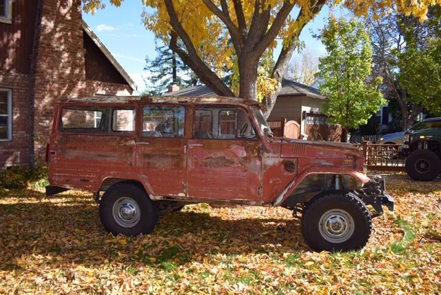

Got new horns, Washer and overflow tanks, new turn signals. Wanted to use the old ones but the lightbulb sockets were sooo rusted, Oh well. Epoxied and painted the knobs on my window cranks. Did the round bezels as well but they are packed away and I couldn't put my hands on them.
There's old Clyde. I had not been able to look at this site for a while but the itch is back. Nice to see this truck in a different place. Have you changed much on this truck?
Not to clog up JLawsons thread but, yes, small changes only for now. Not a lot of time to work on it but if I can get to retirement some day, I can spend more time restoring it.
