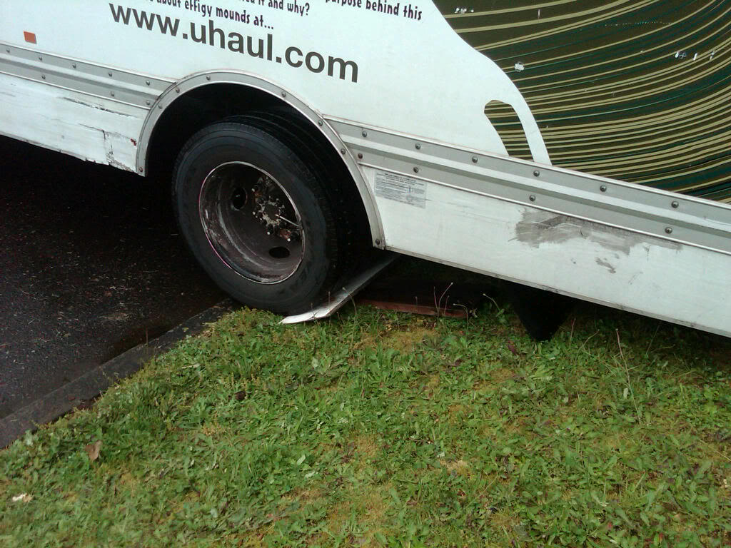

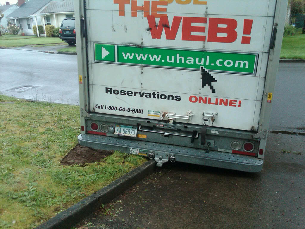

Mike decided to tryout the U-hauls offroad capabilities in the front yard.... and got stuck. :)
the good news is his landcruiser yanked it right out.
Hope your getting settled in at the new place Mike....
Makes for a nice low step when unloading. That first step can be a doozey otherwise.
Don
Thanks Zack. What you failed to share was who was spotting me. :p Thanks for patching it up after I scrapped the weeds off the front lawn and thanks for helping with our move, it is much appreciated!
