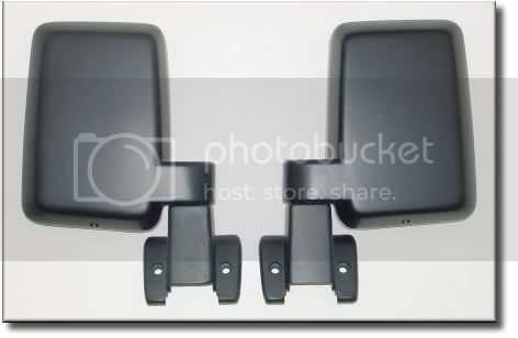

Micah - Yeah those little fj60 mirrors don't offer much visability so some upgrades like you've posted are a good idea. I'll probably add that to the mods down the road. How is that 6bt monster?!
