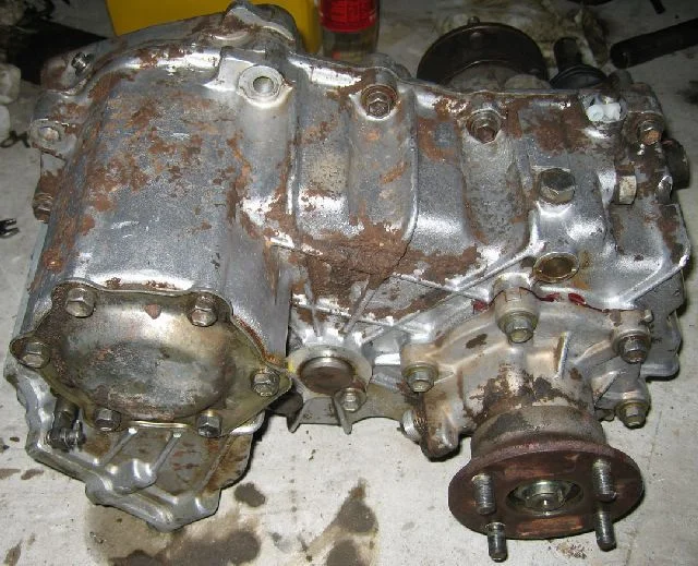

have been looking at purchasing a Fairey TC and overdrive.......off of a 2F fj60...Owner tells me it is both the TC and overdrive are one "Fairey" unit!!.......I can't find any info on a Fairey TC.........anyone with experience on this one???appreciate anyinput on this puzzle:confused:
Lou

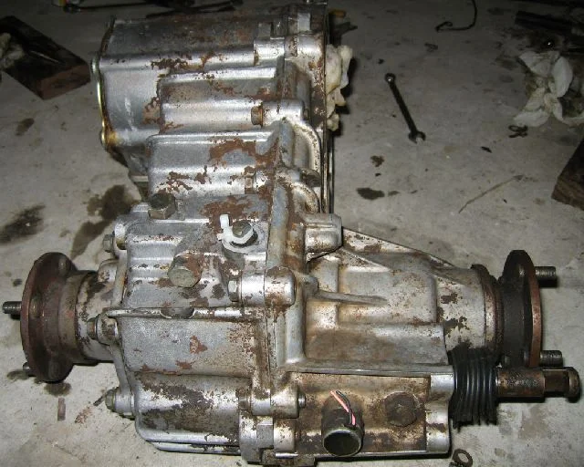

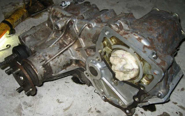

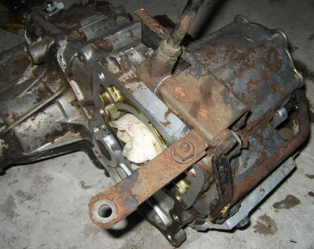

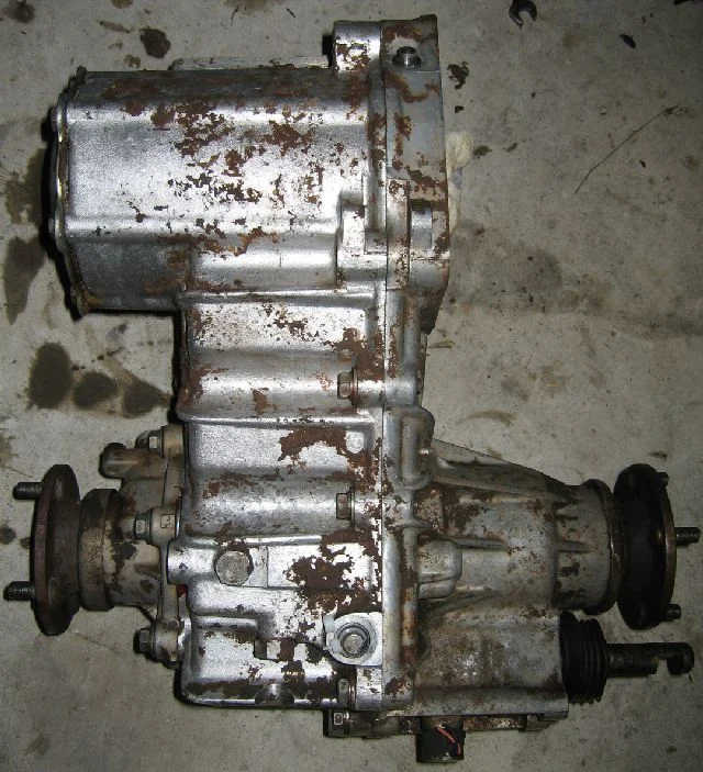

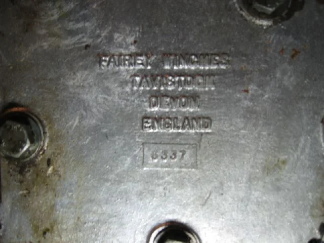

there is def. something in there. Pop off the output shaft cover....and have a look. The rear of that t-case sticks out a good 3-4inchs further than a stock 60 series case. Also the rear half of the case looks to be a different metal than the rest of the case or at least a different casting.
This Fairey model for the 60 series (posts 28-30 pics) replaced the stock back half of the stock split transfer case with a new Fairey-manufactured case half, along with new gears set, etc, and of course, the shifter attached on top. That is why it doesn't look stock, it aint.
In 22 years of working on cruisers I have never seen anything like that before!
Translated, that means you're gonna have a heck of a time finding parts for that if ANYTHING is wrong with it. :frown:
I wouldn't mind having a closer look at it tho.;)
I just pulled the same split-case fairey unit out of a FJ60. I bought it for the front 1/2 of the case only. I am going to sell the fairey 1/2 case and gears on Ebay, unless someone on MUD wants it first.
I've seen the split-case Faireys on Ebay far more often than the old-style. PM me if you have a price in mind for it before you list it.
I see my Fairy has been I.D.'d. n2666s and I have been chatting about this one. I posted it in the classifieds. I too have never seen one like this. I bought it thinking it was a unit that mounted to the PTO portion of the case. Come to find out it is the entire case. And this thing is pretty clean. From what I noticed while removing it from the H42 is that is uses most of the stock split case components from the idler gear down. The top portion(thick O.D. portion of the case) is Fairey stuff. The rear half of the case is not a toyota part but is a casting that looks very similar despite the thick top portion. I would not doubt that if one was to remove the rear half and replace with an OEM half, that the case would be functional. If anyone wants more detailed pics, let me know. I even have the factory service and repair manual oddly enough. I will admit, it is quite a conversation piece when people come over to the shop at the house.
