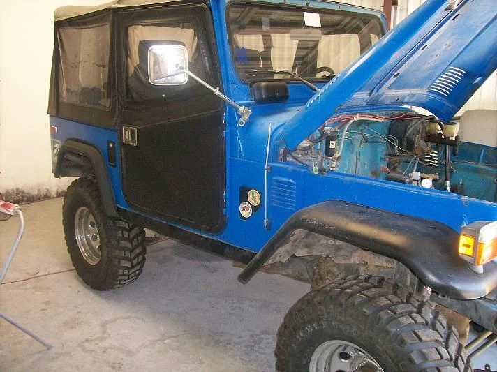

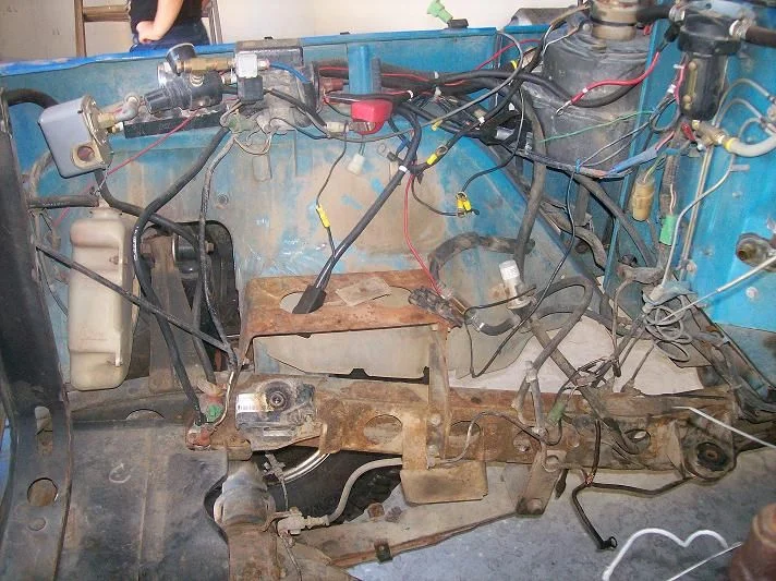

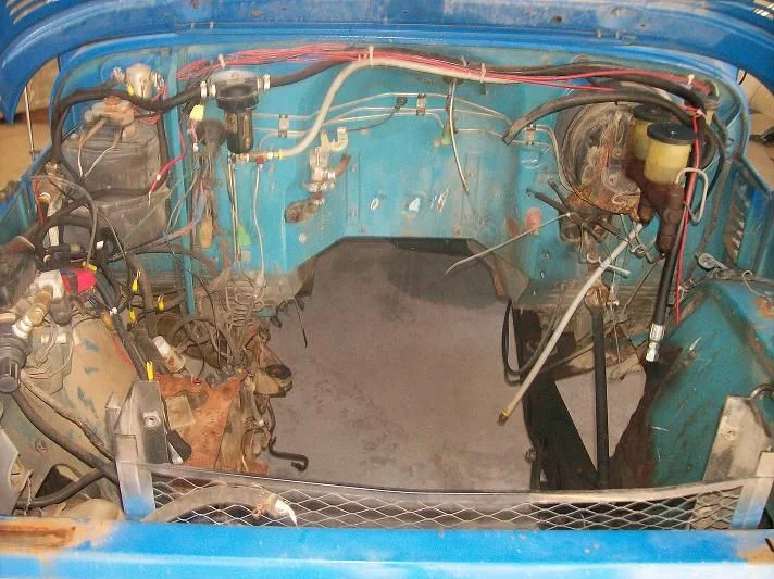

Well after a few phone calls and a couple e-mails Puddlejumper decided to bring his truck all the way from San Antonio for me to do a few things to it. He would like to have a 350 mated to a 350 tranny backed with the toy box and overdrive setup. We are also taking care of a spring over and body work with paint. This should be interesting since I have been refined to the 60-series forum with Vortec conversions. Hope I am not treading to hard into the 40's forum but I just had to do a 40. It has been a few years and I couldn't resist an old school 350 combo. Hope you guys will follow the thread with as much interest as the 60 guys. Puddlejumper will add his commentary as to what he expects to see from this conversion and how he came to this decision. So here comes the pic's!!:grinpimp:

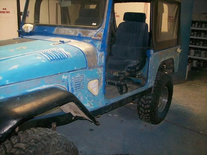

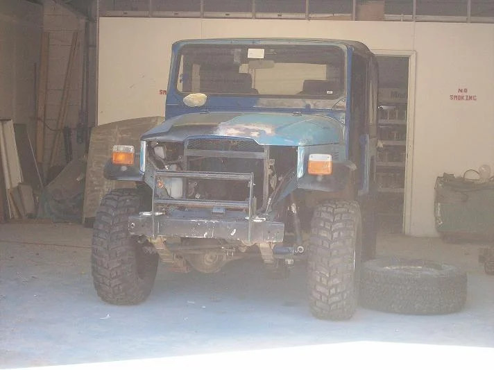

Body shop updates

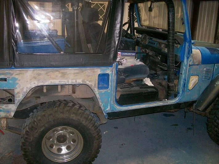

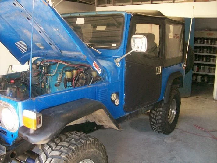

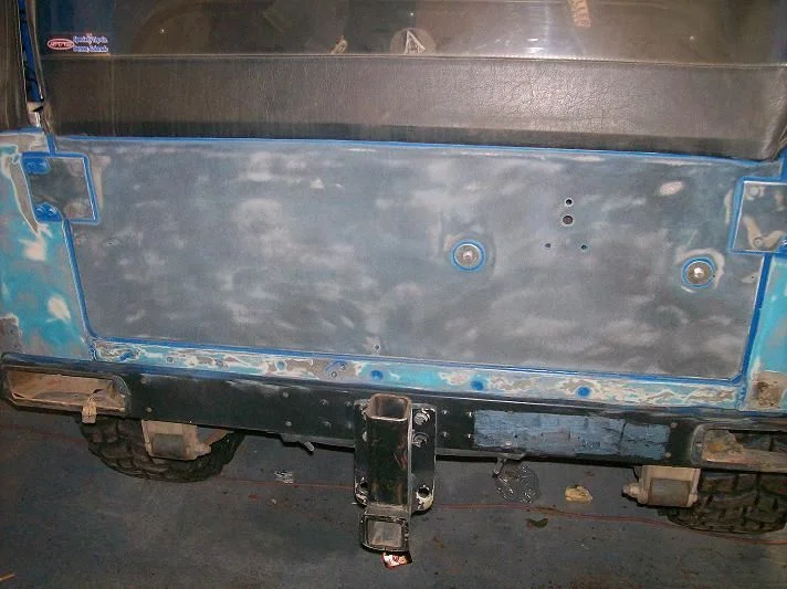

Well Joe at Sunset is rocking away on the body portion. Here are the pic's of where it is at. We will be cutting down the front fenders to allow for more clearance of some big meat tires. Also the core support has been completly redone since the lower section was completely rusted out.
