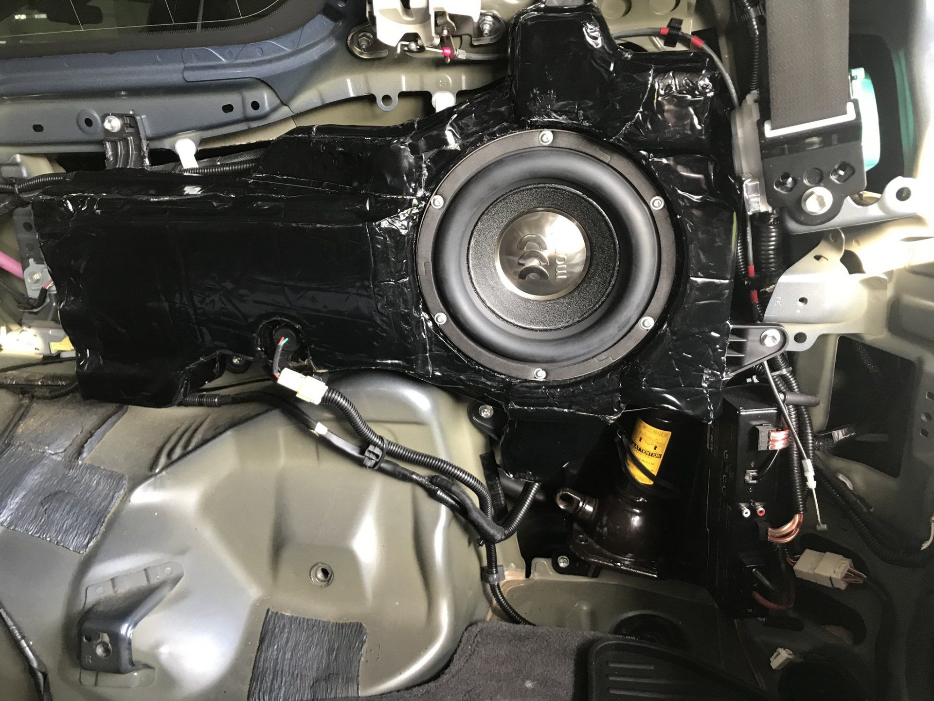

I used the NVX stealth. I didn’t want all the lettering wrapping the enclosure even though you’ll never see it. Covered every square inch of sub enclosure and all of the body panel directly behind it.
Quick update. New sub seems to have broken in nice. I am extremely impressed with the sound without the extra amplification. I am going to go through with ordering the sound deadening material, some polyfil, and the LC2i, but will likely wait until it's warmer to install all of it and the Amp.

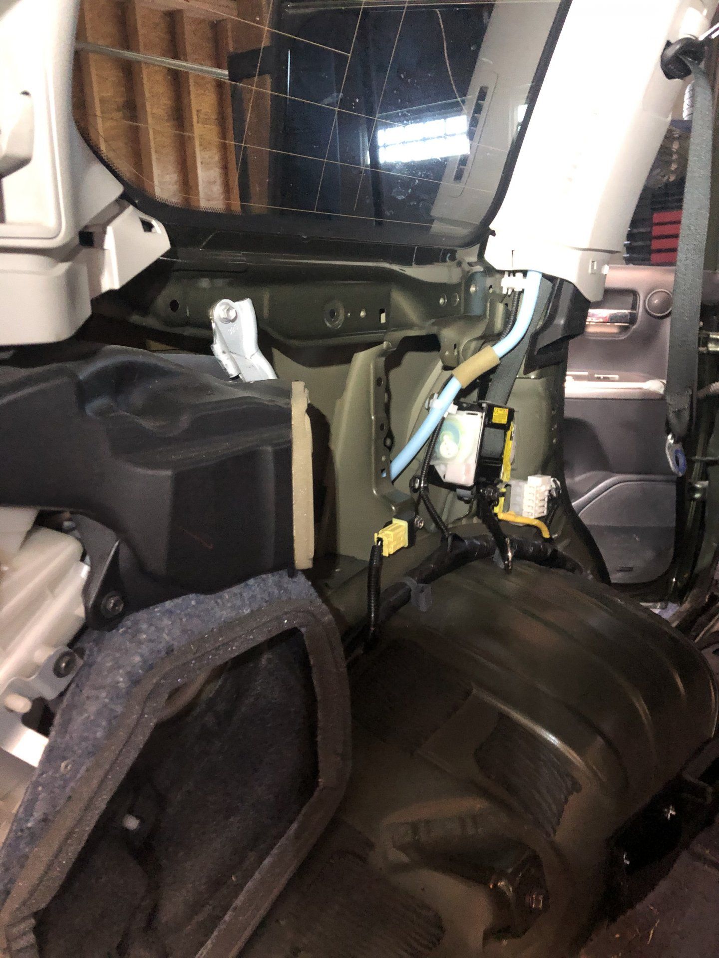

Aircon. LX570 AHC computer. 100W inverter. Ducting.
under the drive/passenger seat is the only spot where amps can be installed?
Depends on the amps. There are some micro amps that people are mounting in the cubby on the passenger rear corner. There are a couple of installs on this thread.
That's what I'm going to do. The amp I got is a 500w mono, and is 3"x3". Unreal!

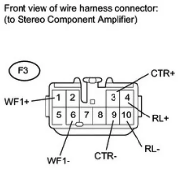

I've got an Audio Control LC2i ordered and plan to connect it to an external amp and sub in my 2008 LX570. Where is the best place to intercept the signal to feed the LC2i -- the F18 plug under the driver's seat? If so what wire colors or pin numbers would I use?
Thanks!

Pin 1 and 6 on F3 is the sub out from the amp. They are White and Black. Should be the same as back at the sub.

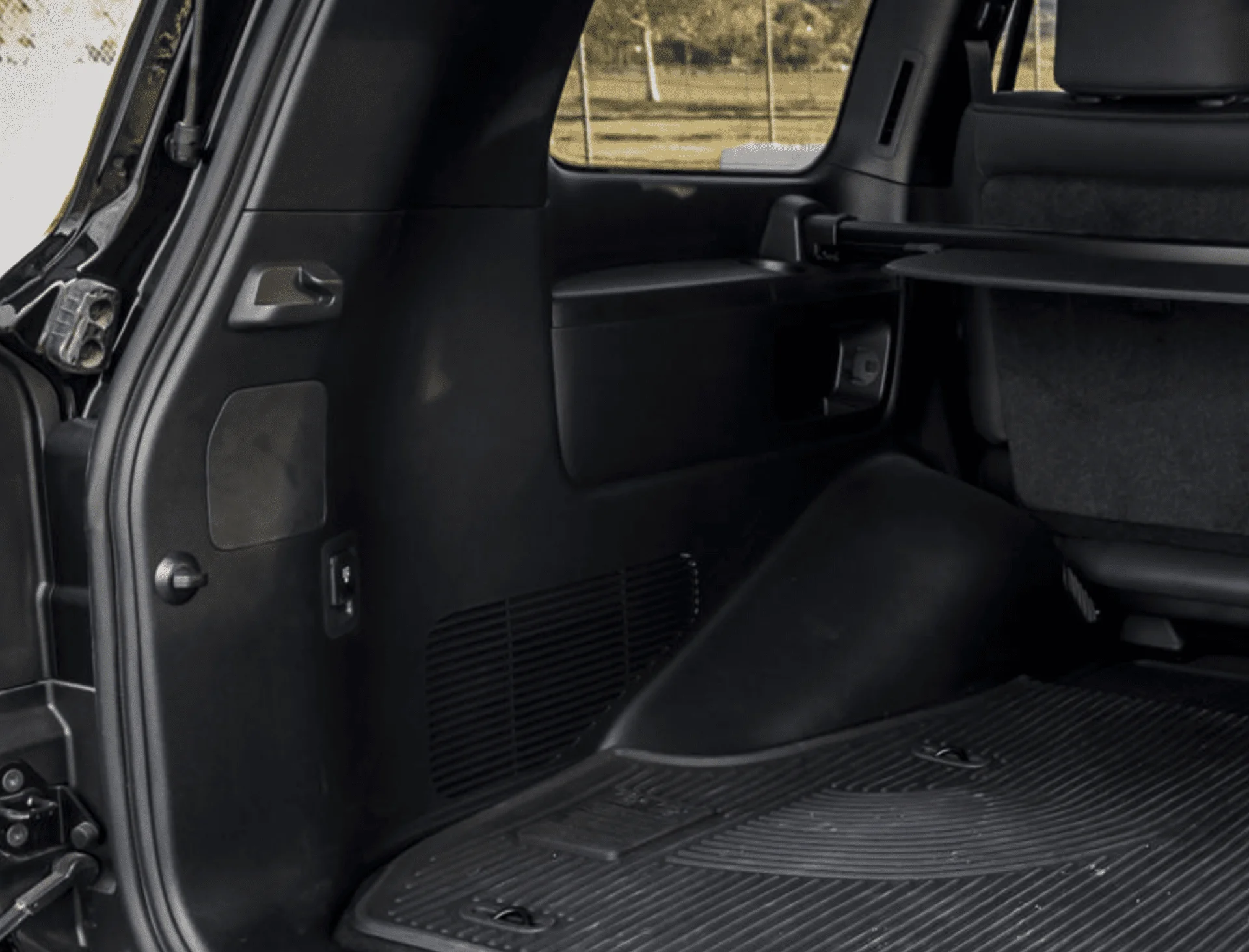

Good news! It you don’t use your 3rd row, there is an always on 30A there to power the seat motor. It is ripe for sub use. Otherwise you’ll need to do the traditional home run for + from the battery. In that case there is an access grommet in the cubby near where the jack is stored. Alternately folks have run they the firewall grommets and up the side of the floors in under the trim.
There is a ground point at the rear hatch about a foot up.
That's good info for others for sure, in my case I've removed the seats and installed drawers, fridge, and run 2/0 power down the driver's side to the rear.

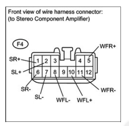

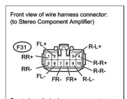

Add the other two speaker plugs on the Mark Levinson Lexus amplifier (does not apply to TLC / JBL). There are 12 channels total at the plugs.
LX mark Levinson only
Yes, these are post amplifier high level.
