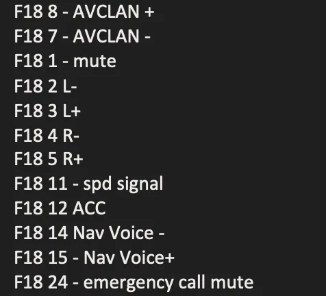

Low level signal INPUT on F18
More F18 Mappings

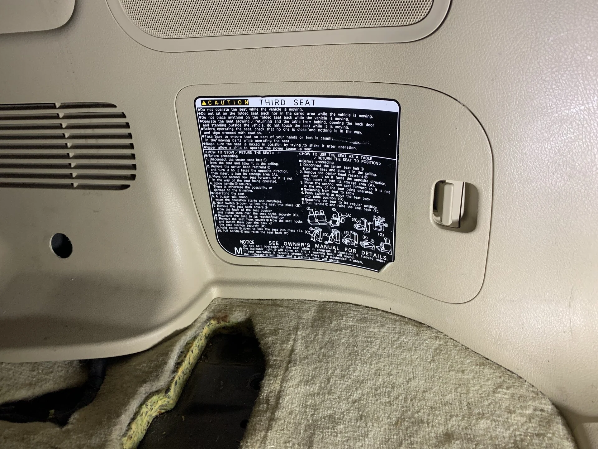

You have to pull the quarter panel cover. It's a few screws at the tailgate and under the side door access, and then about 20 blue clips.
You may be able to put the seat down and pop the clips at the top of the quarter panel trim. Or you try to access via the jack panel area. You might be able to do a lot with one hand up in there. To actually pull the sub box you’ll need to take off the quarter trim.

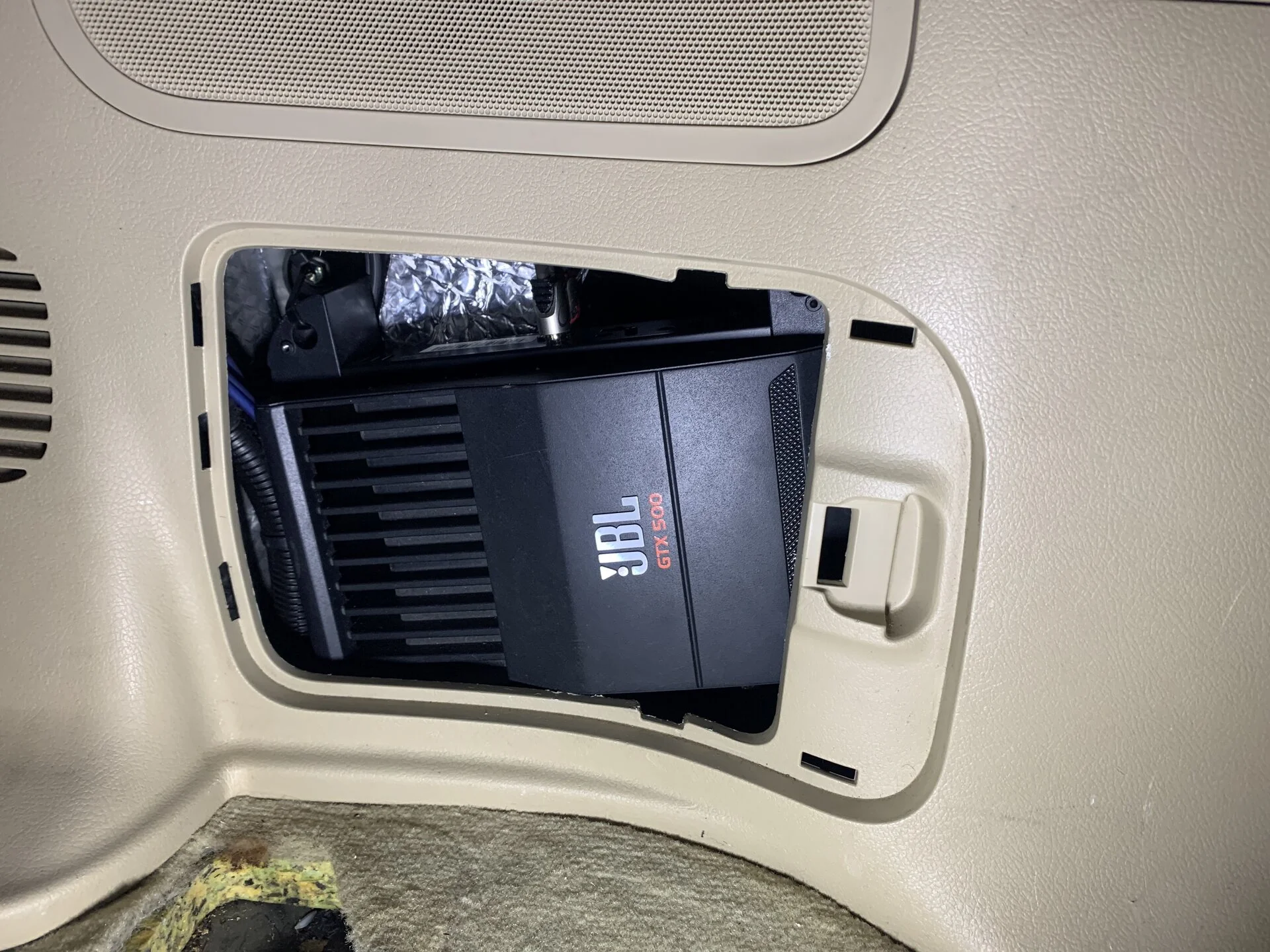

Just got a new medium power monoblock amp. Odds are even it will blow my current jbl ws1000 (only 200w rms). When it does I’m pretty sure I’ll replace with the sundown sml 10. Or a ddaudio sl600.

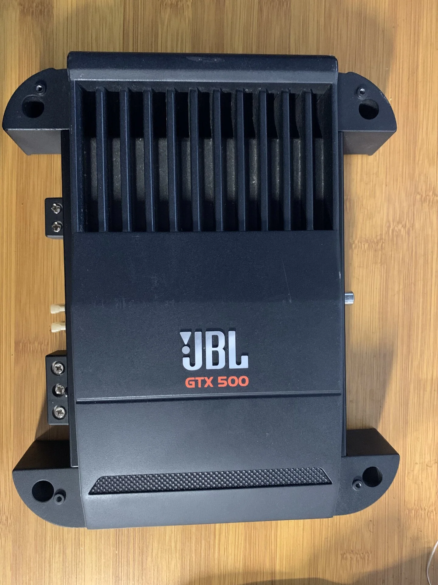

Fresh in from the pawnshop. Should do around 225w into 10 ohm load my sub has in series. Sub rated at 200w. Very safe. Amp not rated at 10 ohm, but does 280w at 8 ohm. Efficiency thru the roof - 96%+.
Could also put it in parallel on the sub and run it at around 450+w into 2.5 ohm. (Rated at 500w at 2 ohm).
Some amp demo tests have this amp running 30% over actual vs rated.

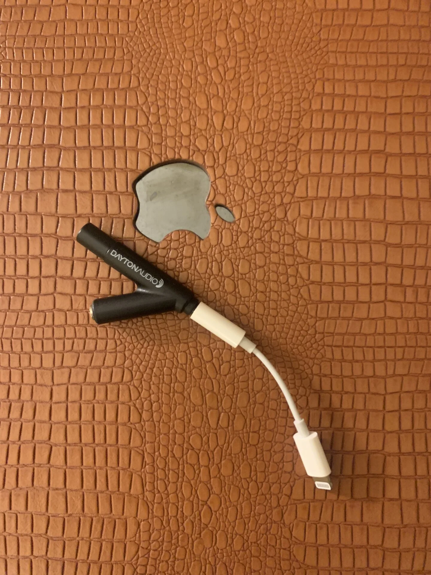

I love progress. It's now possible to get a full blown RTA for $35! And a full on oscilloscope for $30. I can't even believe it. Anyhow, I got the IMM-6 microphone from Dayton Audio, the branded apple lightning to 3.5mm trrs adapter, and used the Audiocontrol MobileTools app from the itunes store. The app allows use of the microphone calibration file from Dayton Audio. Pink noise at 0db from youtube via bluetooth to the DSP from my laptop.

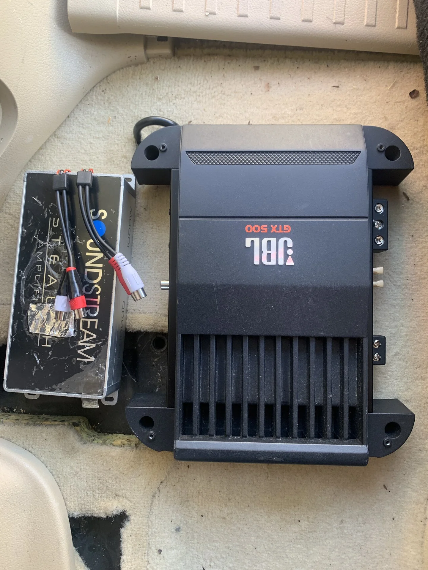

Sadly I’ll have to relocate the stock jack, the new amp won’t fit thru the cubby slot.
Tucked in. Gain set by oscilloscope but I can reach it so easy to adjust if necessary. Tucks right in there.

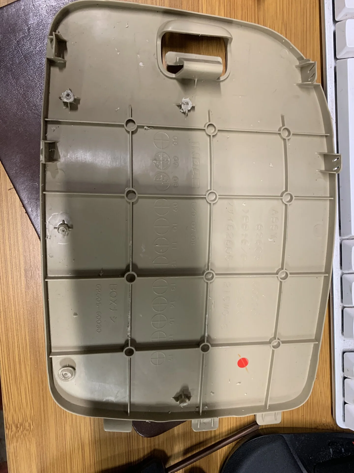

Used a 1/4” Forstner but to remove the plastics rivets holding the pocket to the door.

Jack moved to my drawer, but I’ll likely try to make a space for it in the wing.

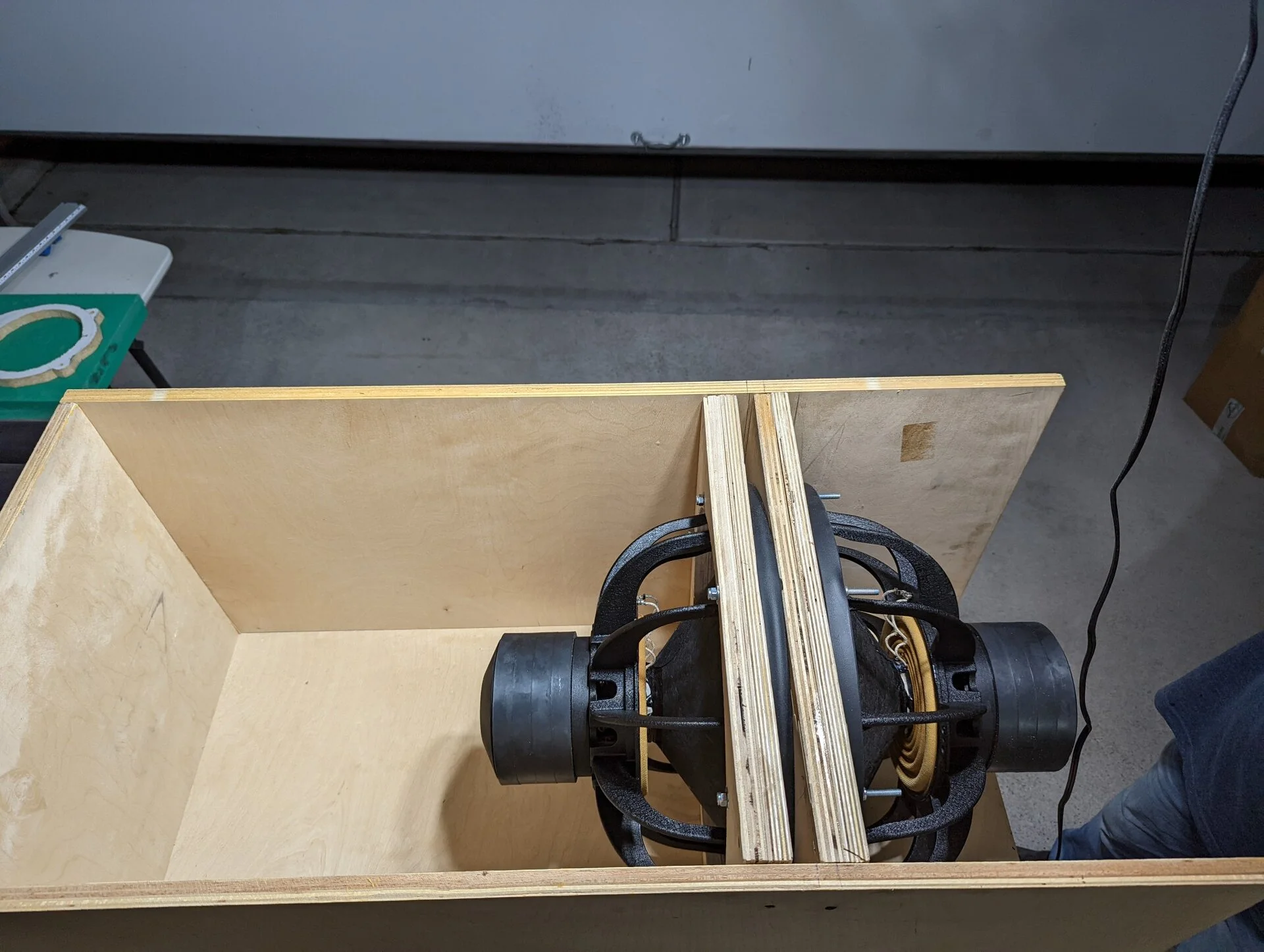

Or you could just go hog wild and use 2 18”s in an isobaric box integrated through Mosconi DSP?

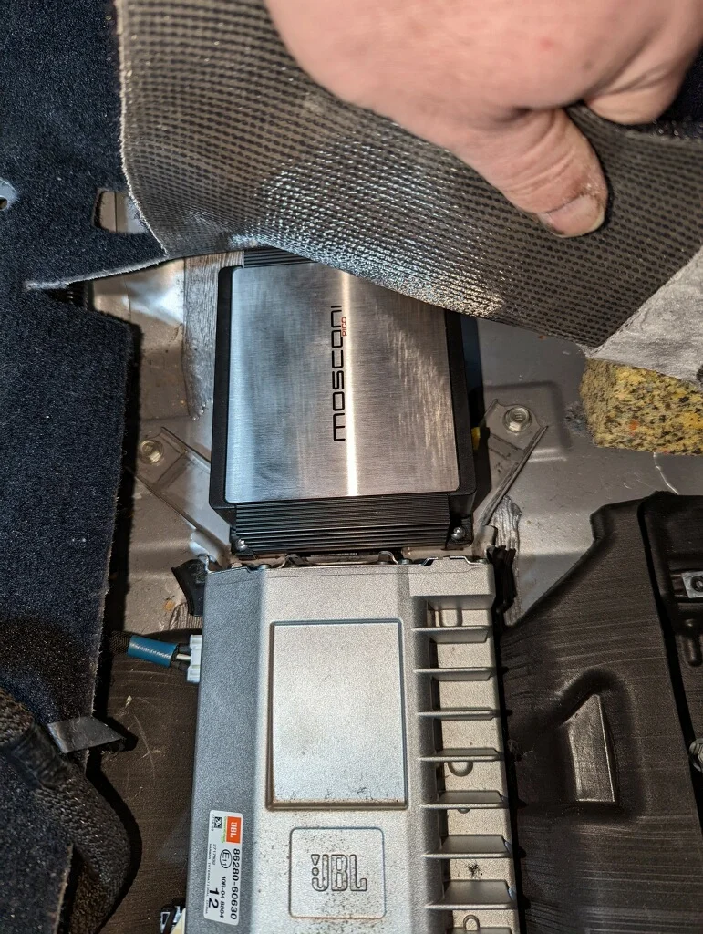

I’m constrained to the stock box and space behind the wings, but did consider putting the amp out on the back of the drawer so I could keep the jack in the stock location. Underseat location used by my dsp and the other 11 channels of amplification. It’s interesting that jbl amp is shorter than the ML amp.

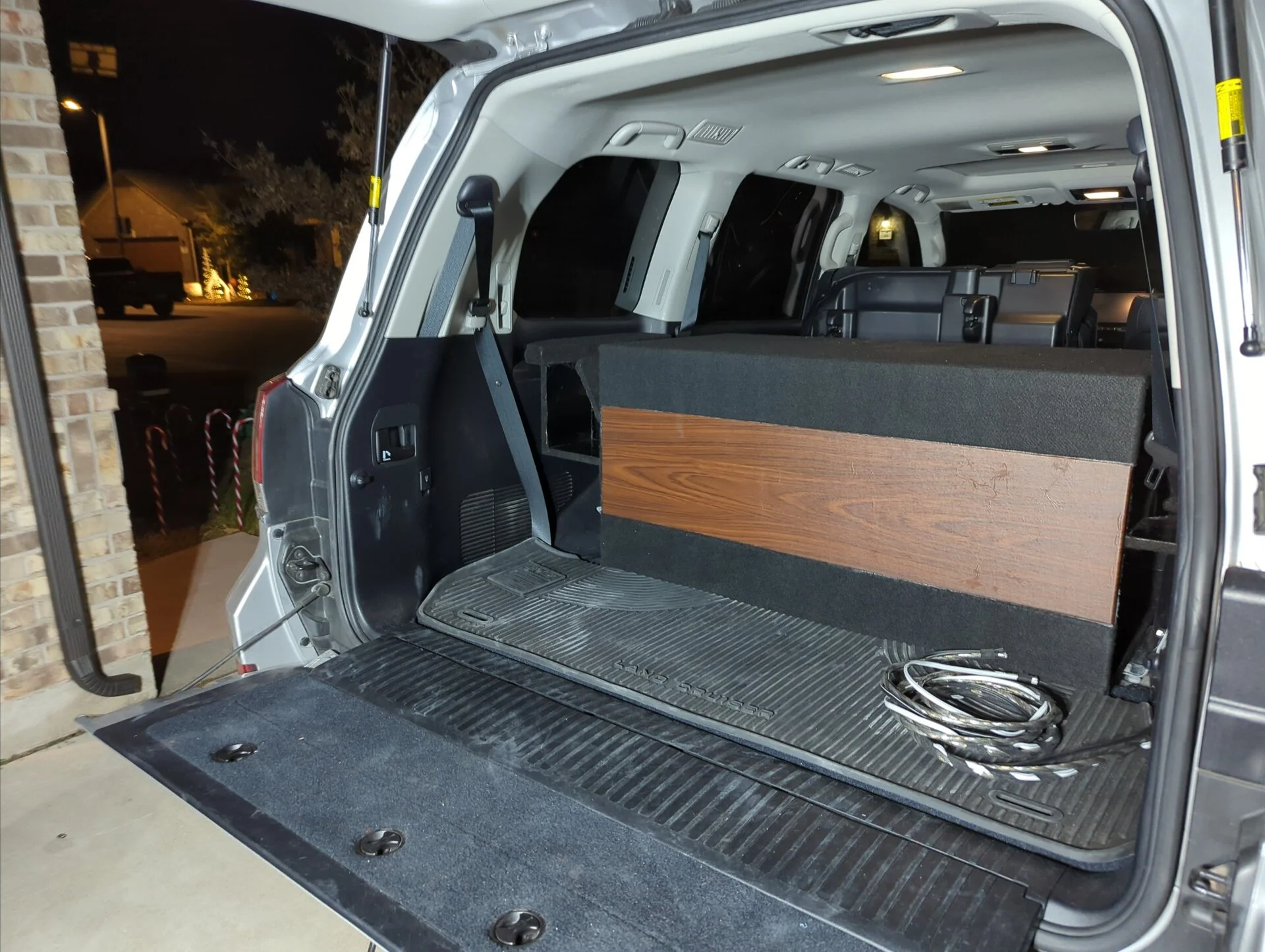

Probably was easily hitting 140s while breaking the speakers in before we did a really simple auto-eq tune to flatten the curve out. Real priority is a daily SQ build with another SPL setting for when my two boys want to have their hair move ha! Enough cone area to get down low too
There's no "tuning" on a sealed box per se, except by manipulating size. At a certain size it stops changing the response, but below that point there will be box rise at a certain frequency, which creates a peak just above the roll off. For this box (about 6 cu ft volume), that peak is at about 32Hz. F3 (rolloff) is around 26 or 27Hz if I'm remembering correctly. But, cabin gain starts to take effect around 30Hz, which cancels out the roll off, resulting in a flat response once that box rise is EQ'd out.
Running the 3-way front stage (800w/8) / subs (mono 1000w) on JL Audio VXis.
Will be starting a build thread on this process to explain what exactly got done.
Still have quite a bit to do including finishing the box & heading over to MTI to do a MAX JL tune.
