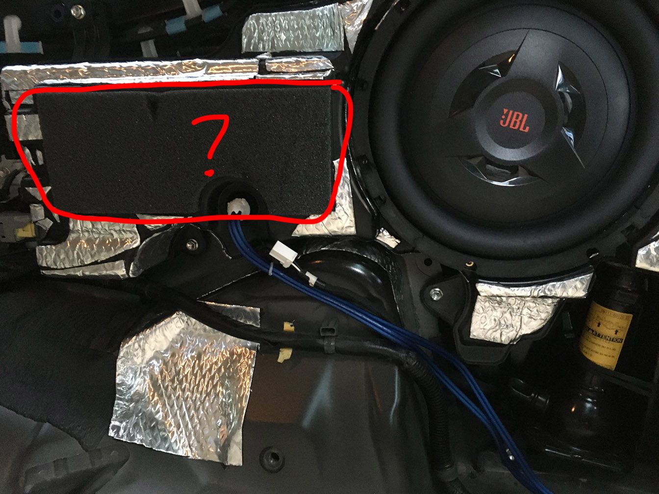

So does the volume enclosure include the volume to the left of the sub where I've marked in red?
edit - I don't have 'my' 200 series LC yet, but looking to purchase a buddy's '16 in next several months and collecting some speaker parts - maybe do some fabricating now. I have a 12" shallow mount Stereo Integrity BM mkV (3.4" depth + 1/8" gap with 0.65 cu in. volume required). I'm considering a used LX ebay box to get the 10" opening and then doing heavy mods and fiberglass with step down spacer ring to get the 12" to fit. I have the mark IV sub in my '80 and love it.
Yes, you can see a complete one in this post Factory Subwoofer Info Guide
That’s some pre existing damping on the enclosure Tupperware. 12” will be tough the circular shape cutout is probably only 11” wide. The spacer for my 10” had to be trimmed to shape to fit.
yeah, a 12 may not work at all. Will try though. The 12 sub I'll try needs about 11-5/16" diameter cutout plus another 3/4" around for the mounting flange. Looks like no way to do without rebuilding much of the Tupperware piece in fiberglass - at least where the sub mounts.
Yes you could space up maybe 2” at the 10” size and then out for the 12”. To do this you have to cut the 12” into the rear trim panel and it would no longer be hidden behind the trim cover. If you’re glassing probably easier to glass the trim cover than the sub box.
