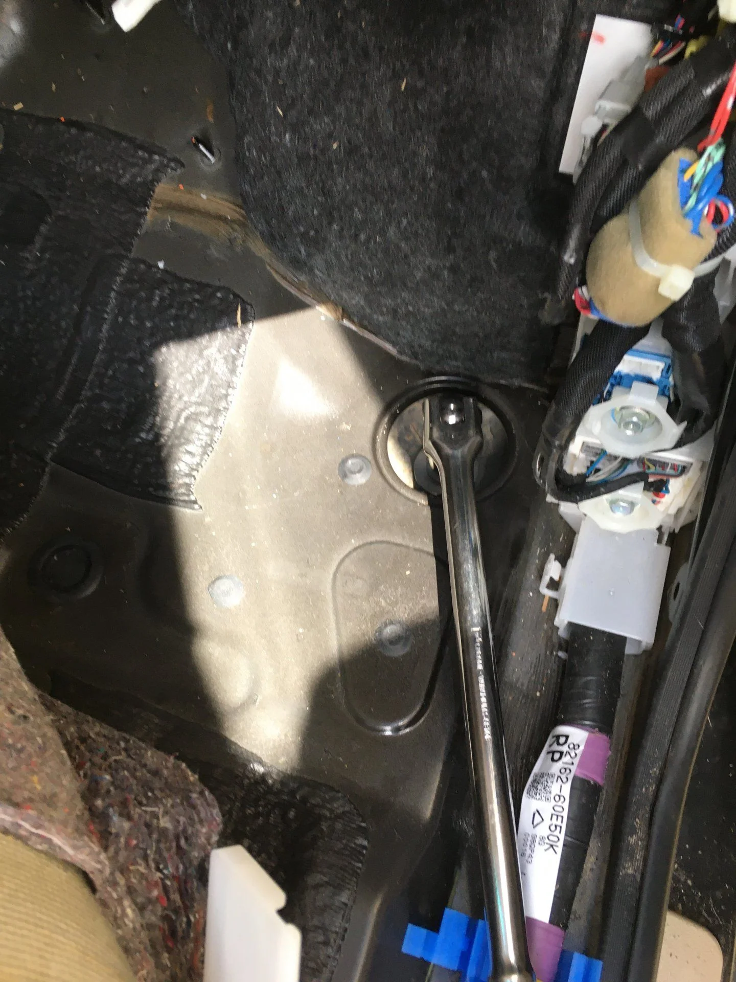

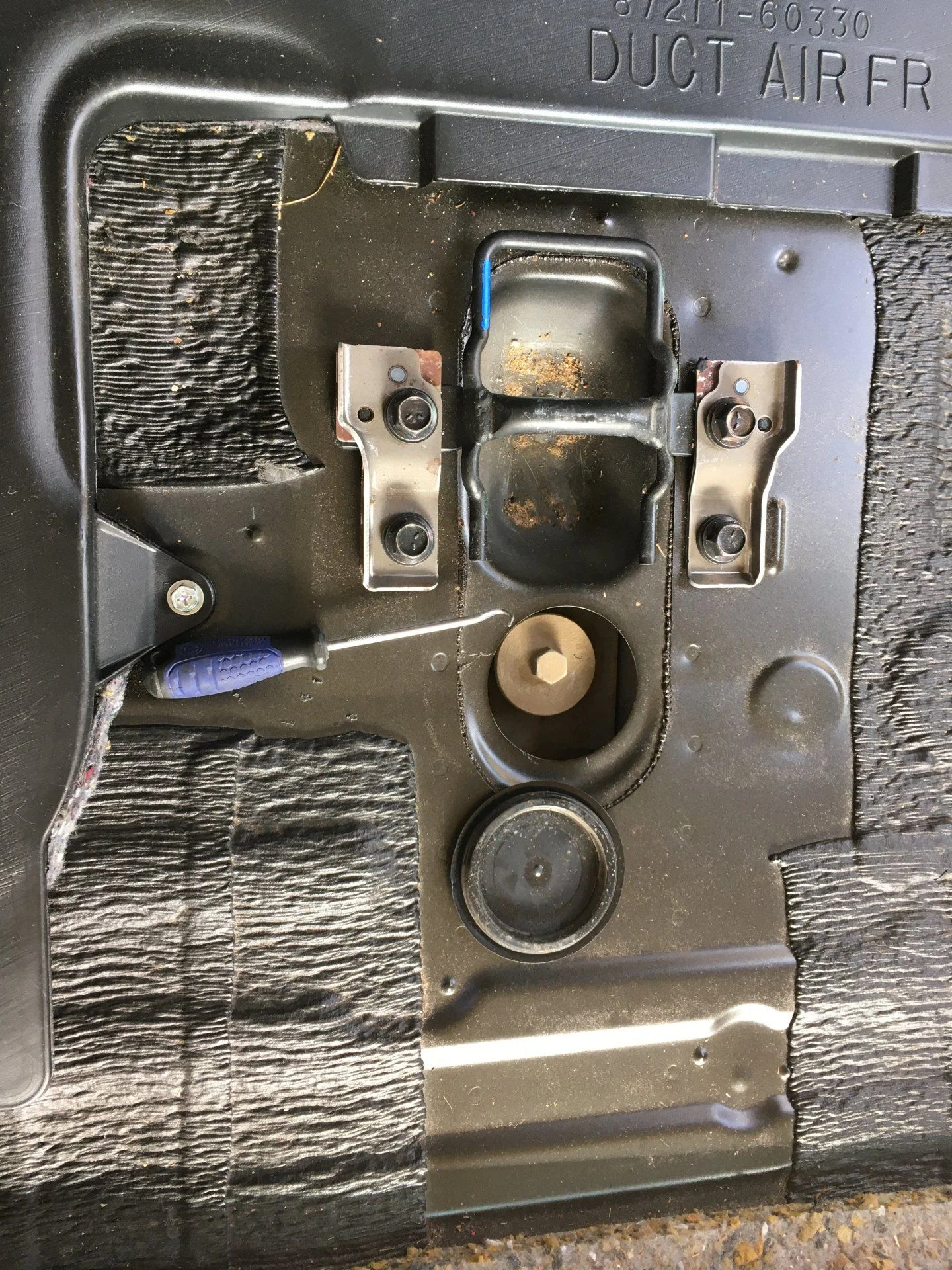

Body mount locations - total 9. They all have the same round thin plastic pop off cover. There are two at very front, two at very back, and one under each door.
Body mount bolt 17mm. Nut 17 mm. hex end on four of eight 9mm.
Beware. There is a 9th in the middle of the 2nd row that bolts into the crossmember - 14mm
I couldn't find torque but internet says 50 ft lbs is typical.

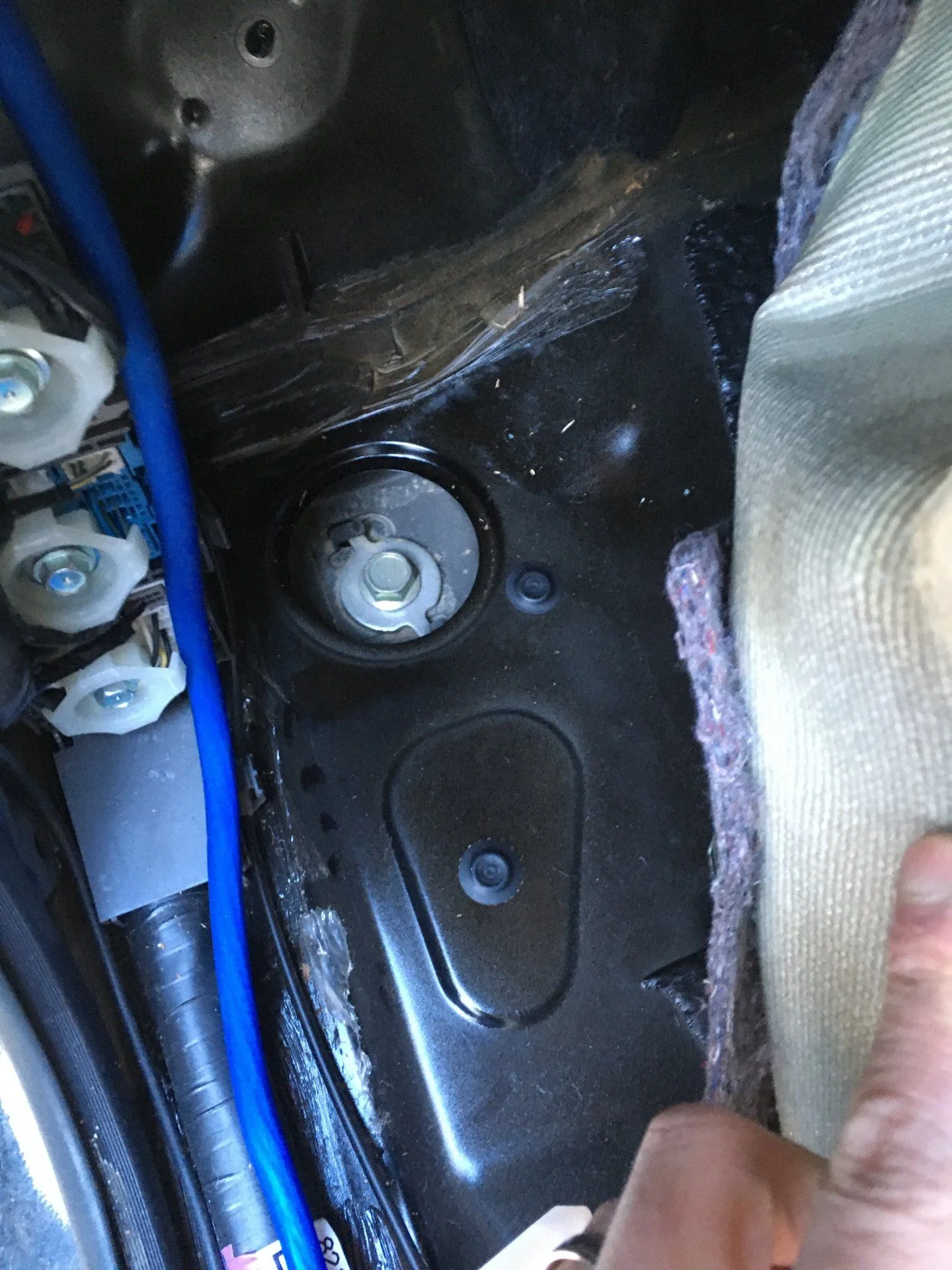

*Edit - I just found two more body mounts at the very outside rear corners. I, uh, missed these? The top of them can be accessed by removing the rear quarter interior trim. I'm gonna go tighten the other 7 and see if I really screwed something up here*
*Further edit - all retorqued and I might have 1/8" twist in that right rear. It does explain why the body didn't lift very easy :(. All the doors and tailgate and hatch seem the same as far as clearance and open shut, so whatever I messed up isn't too big a deal*

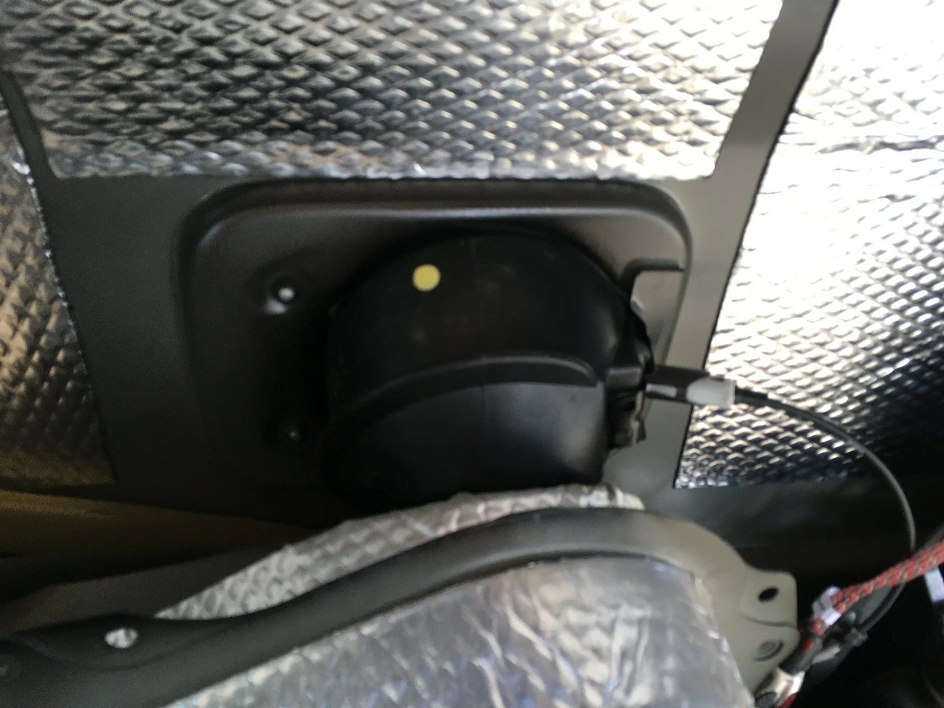

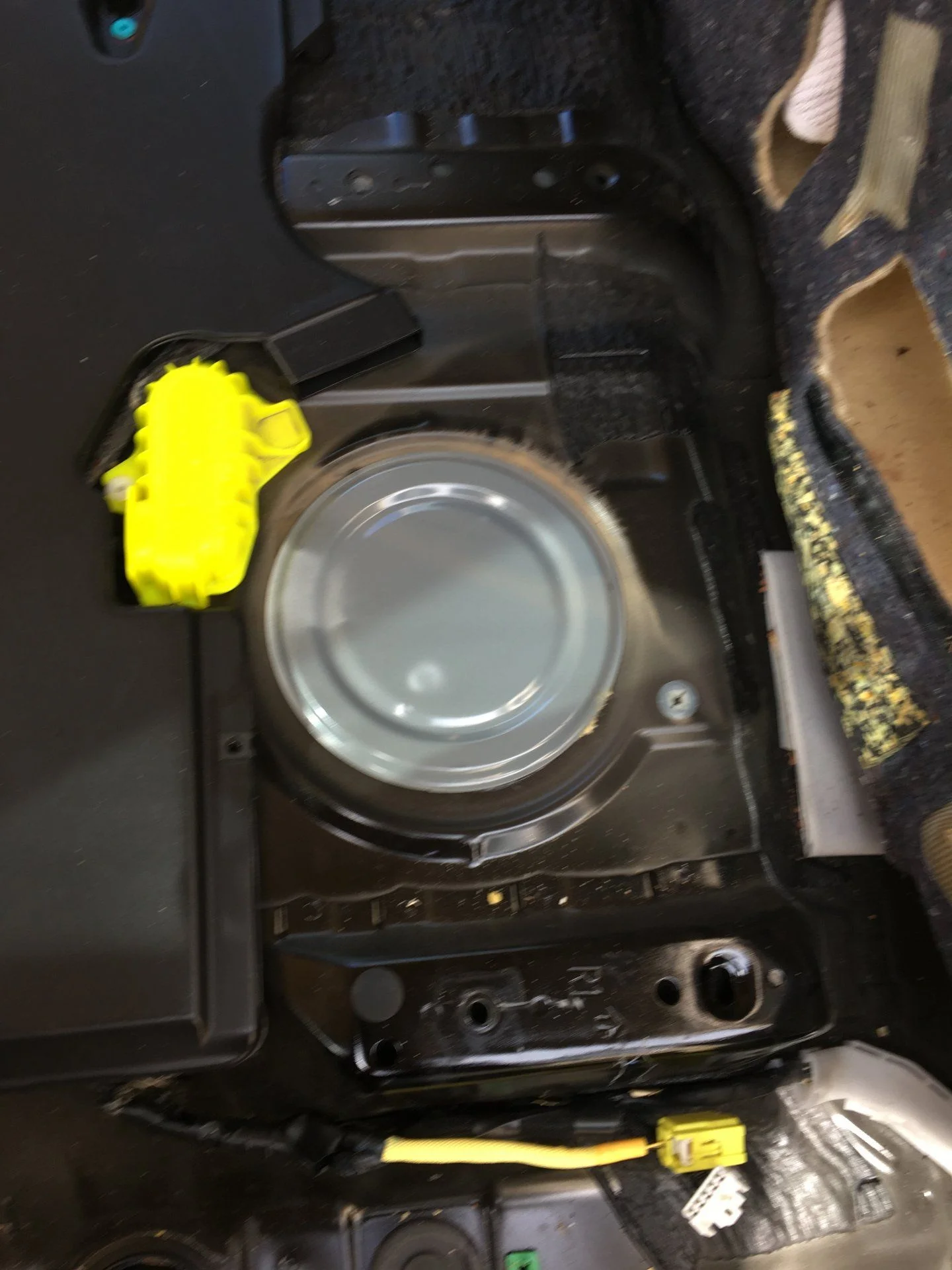

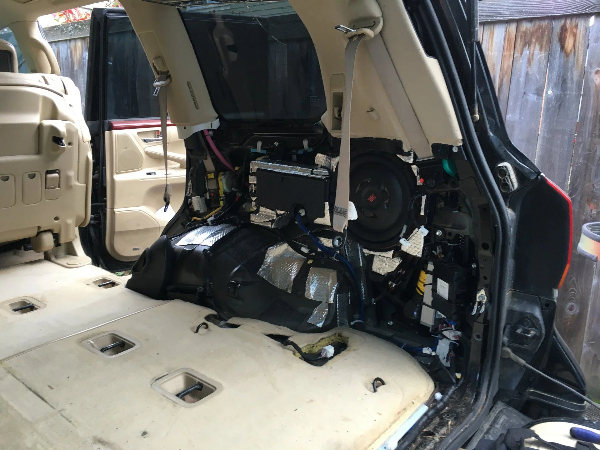

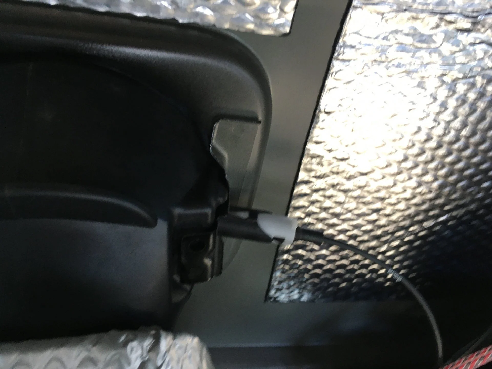

Replaced the fuel rubbers and hoop clips. Had to disassemble the right rear interior and pull the subwoofer for access to fuel release door wire to complete install of the rubber around the release pin mount.
pop the white center out from inside. Go outside and pull the black part out. Put in new rubber and hoop clips. Put the black part in. Go back inside and insert white portion. Then back outside to twist black part 90deg using pliers

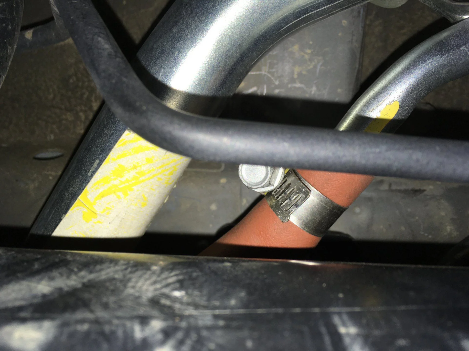

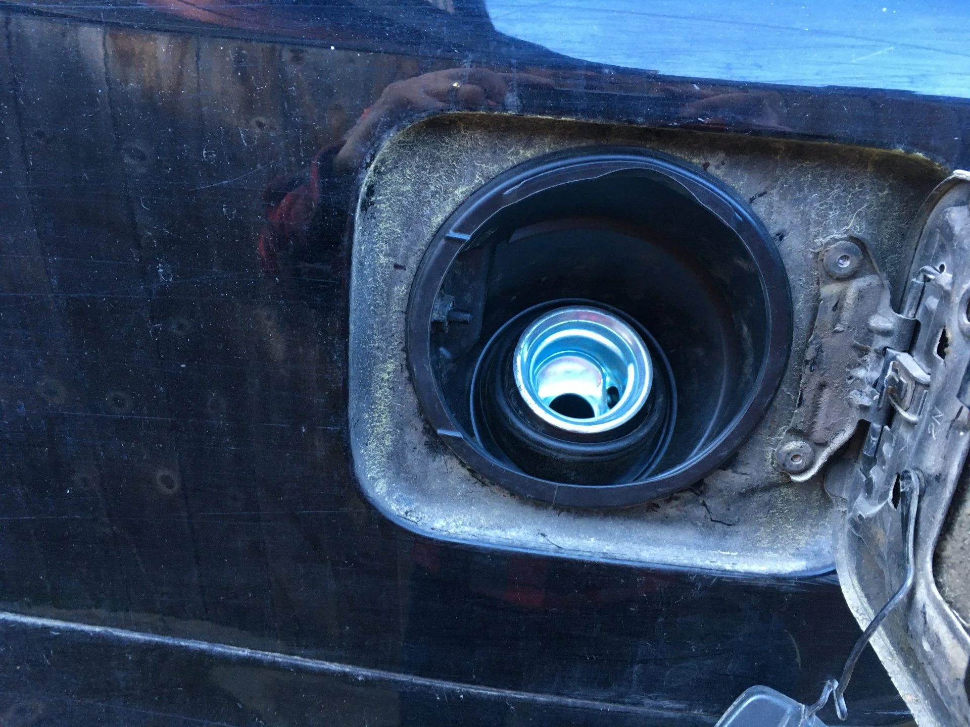

Got the new filler joined to the old us spec filler hose.
Tried heat gun, didn’t quite get there. Filled a travel mug with water from our hot tap (170 degrees f). Shoved end of filler hose in that for one min. Was able to get it on Immediately after. Retightened existing clamp to 1/4” from previous stop point.

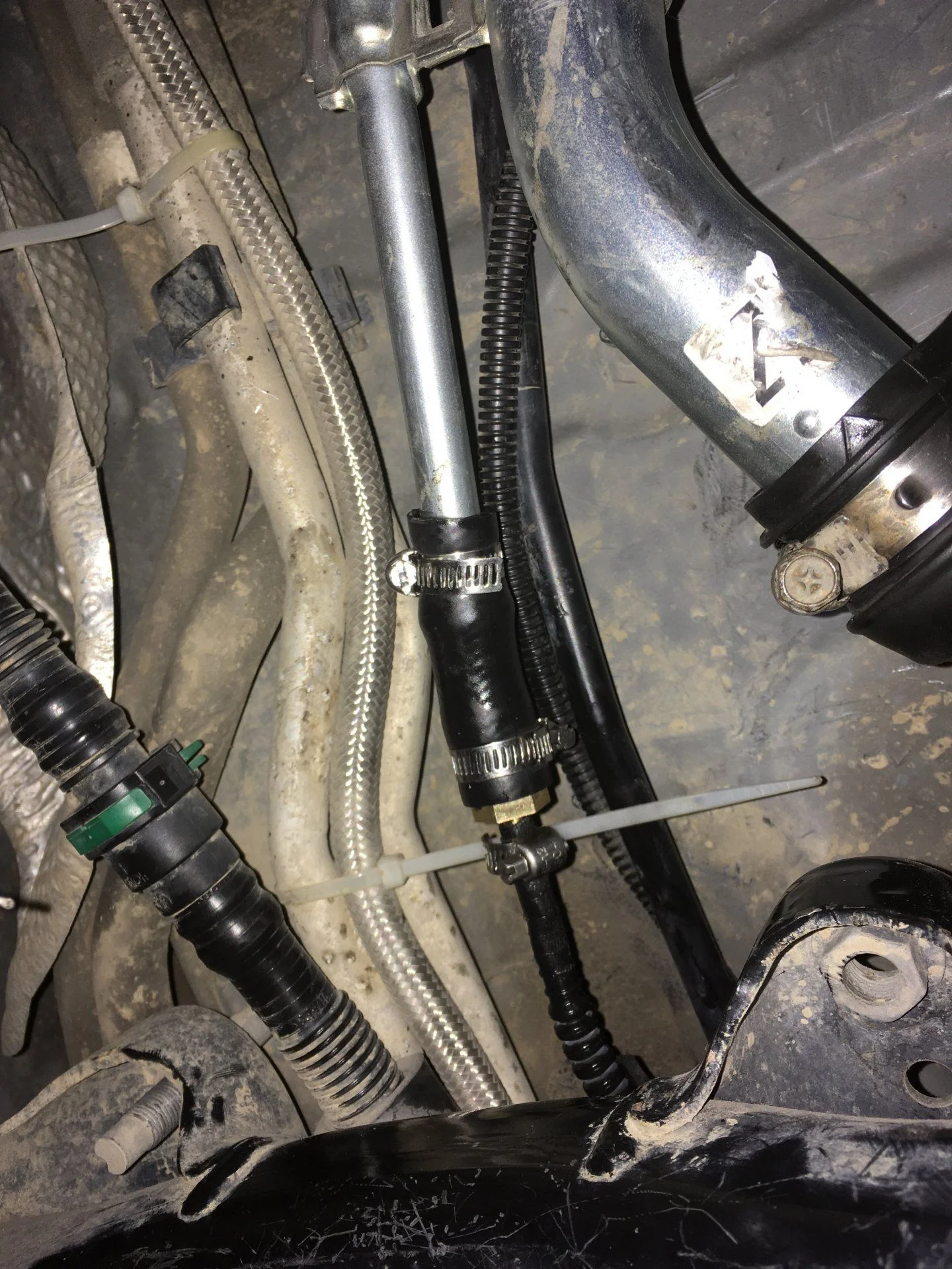

Assembled and installed vent adaption for main gas tank to new filler hard pipe.
*note this is not easily reversible - you cut off the end of the existing vent fitting clamp to put it back (return to stock) you need a double 6mm brass barb coupler. The vent tube can only be replaced by buying a new main fuel tank. Proceed with caution.*
14mm to 6mm. This fitting does not exist that I could find.

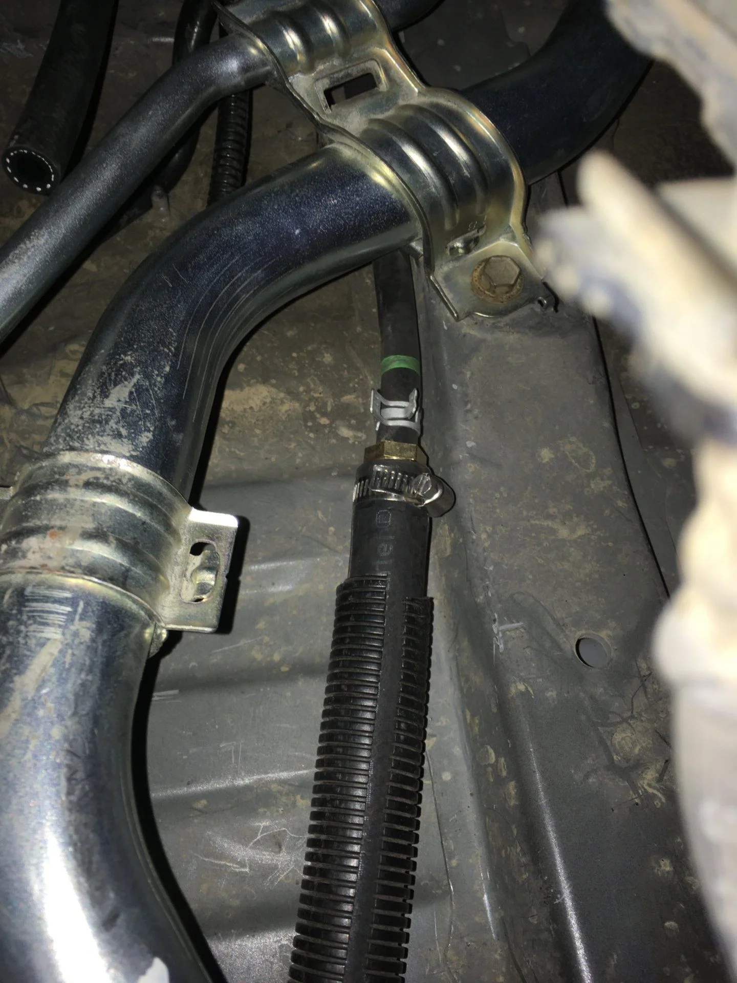

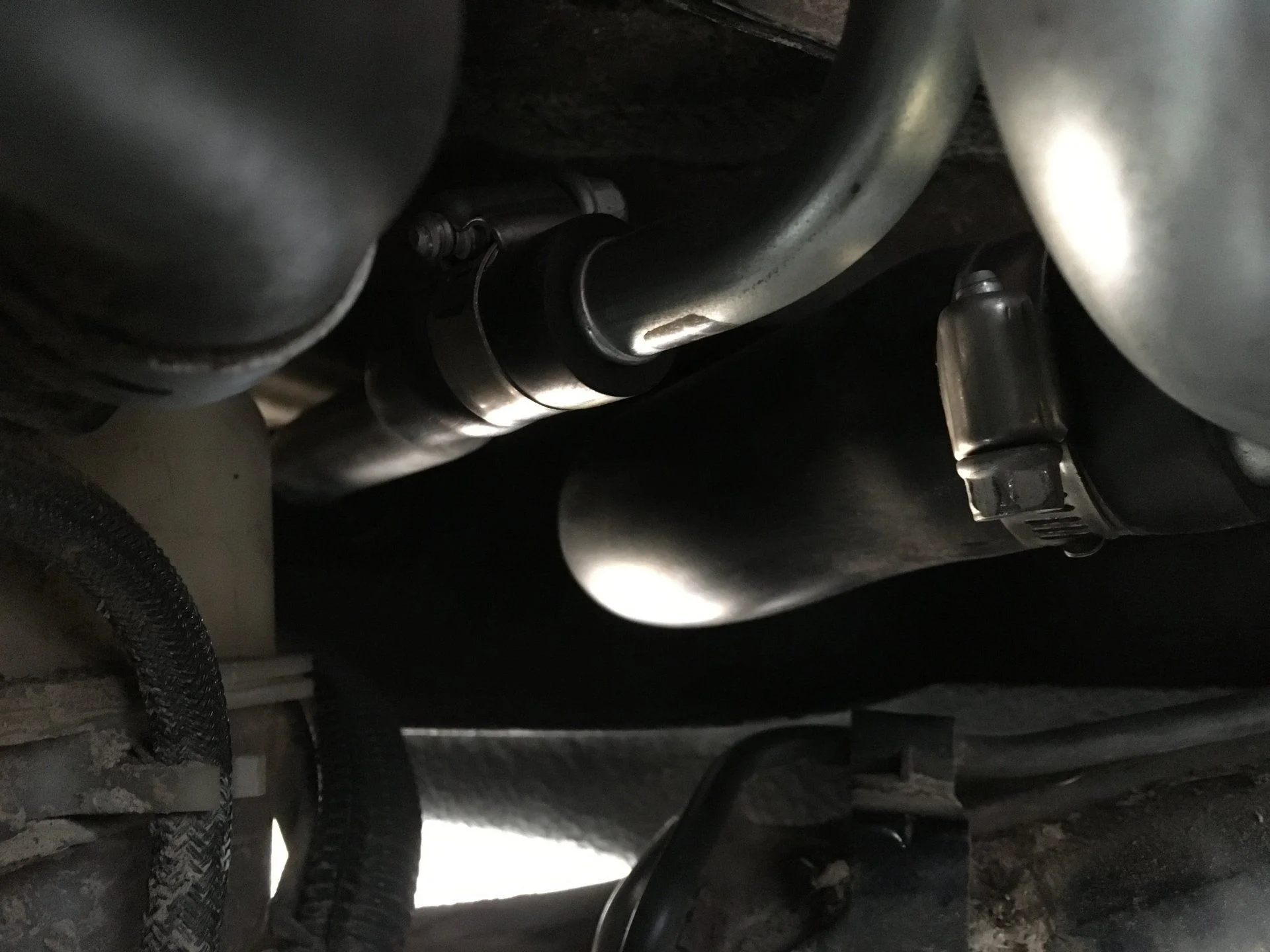

Used 9/16” fuel rated rubber hose

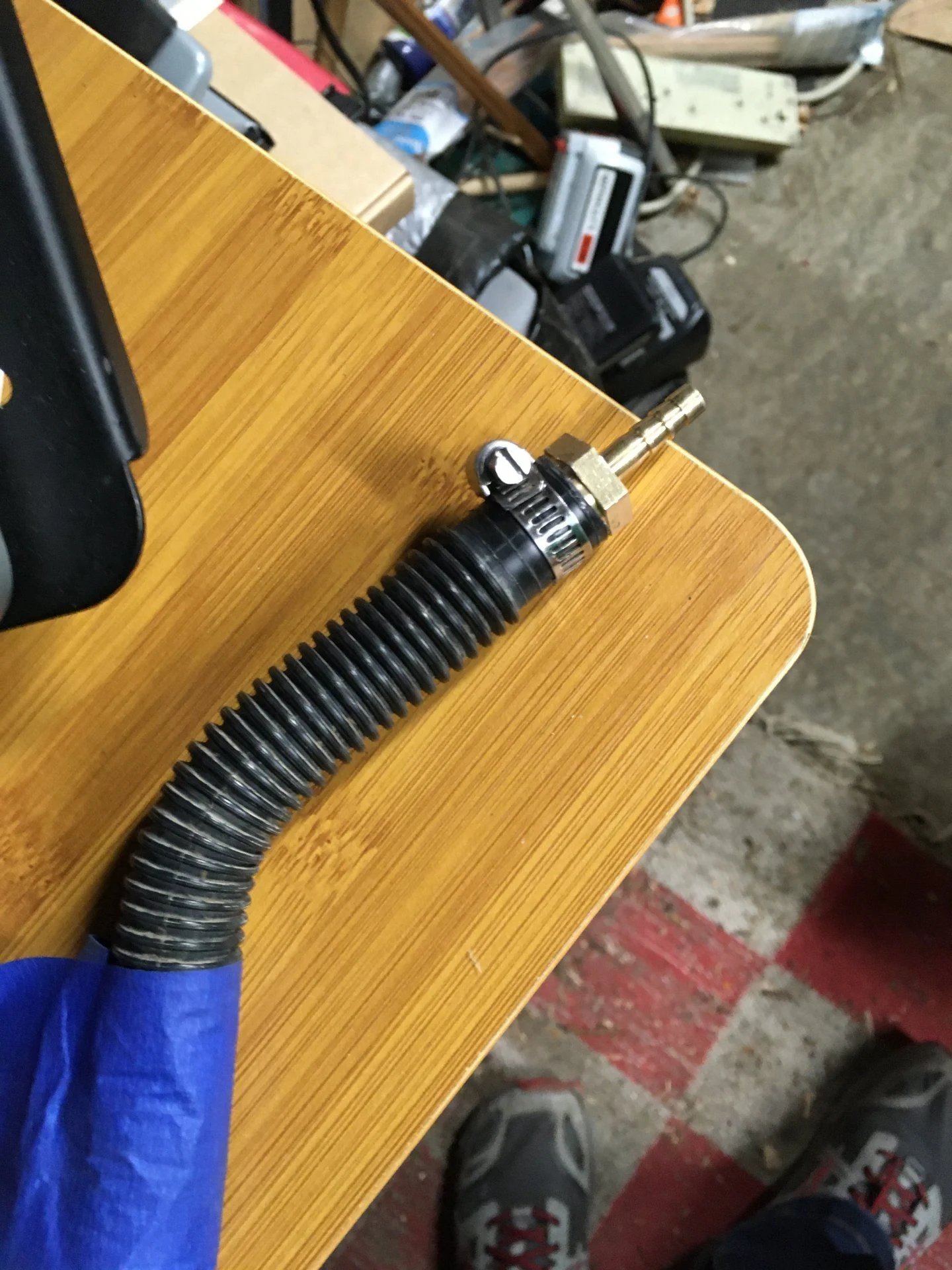

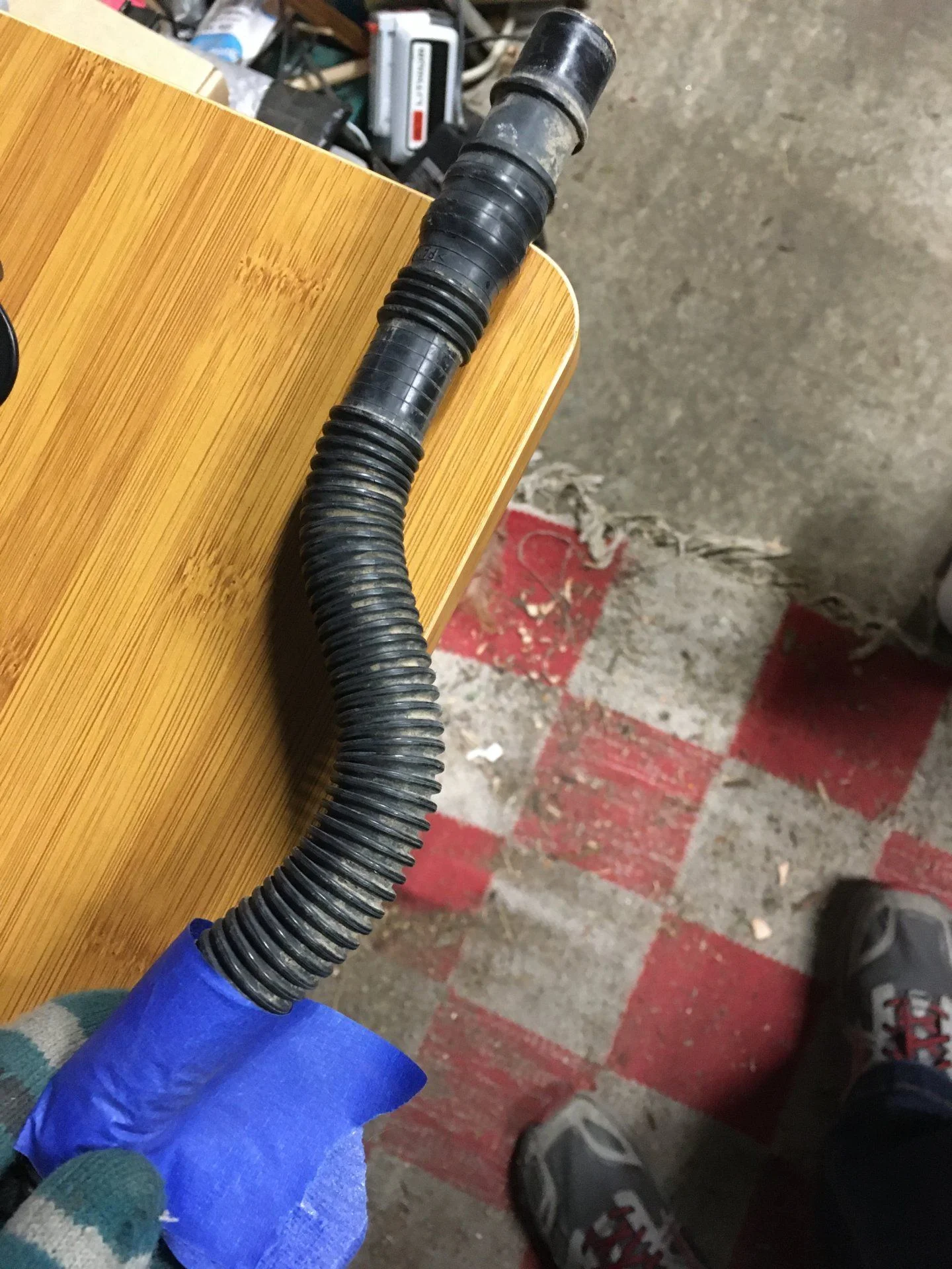

Used 5/8” to 1/4” brass barb coupler. The stock hose is nylon and is quite stiff. Was able to get in on the slightly oversize 1/4” barb after high temp low speed air gun for 30 seconds.
Also had to heat gun the 9/16” hose to get it on the brass barb, and to get it over the ridge on the metal filler fitting.

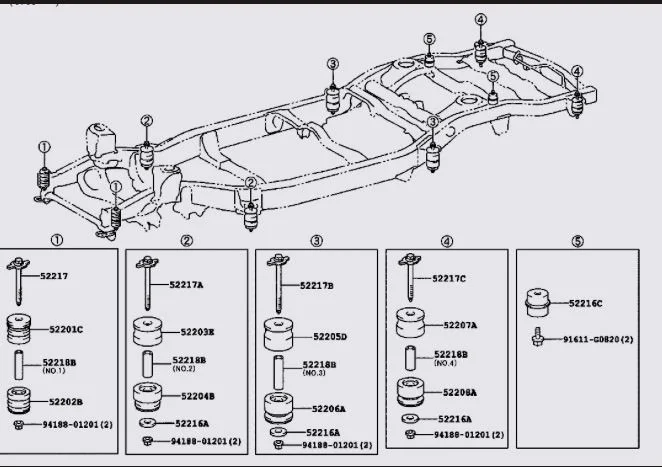

This image might help explain your description for body mount locations. Someone else had posted it I think a while ago, so I saved it. But it doesn’t show the 9th middle bolt and the locations labeled #5 don’t have bolts through the body. They’re more like overload supports.

Yeah I can’t believe I missed those two very obvious mounts by the hitch crossmember. Crazy!
I’ve got a little bow down by the rear bumper on the right side. Nothing anyone who didn’t know would ever see. I expect the bulb trim will expand over a couple days and fill it.

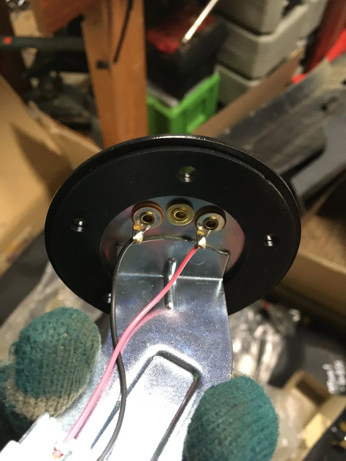

Prep of tank straightforward. All parts just plug in and match to color coding.
Note that the green and purple have a protector on them. After hanging the tank I think the protector should go away from the sub tank, it appears to be for abrasion against a clamp on the filler. I’m going to put on some split loom since I put thes on with protector toward the tank.
The sender includes sender bolts and gasket. The gas outlet siphon does not include bolts but it does come with a gasket.
Edit - go ahead and put the first rubber hose on the siphon / fuel output as well

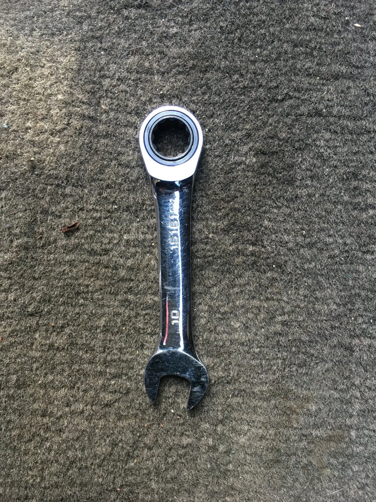

This stubby 10mm ratcheting wrench was the mvp. Impossible clearances otherwise.

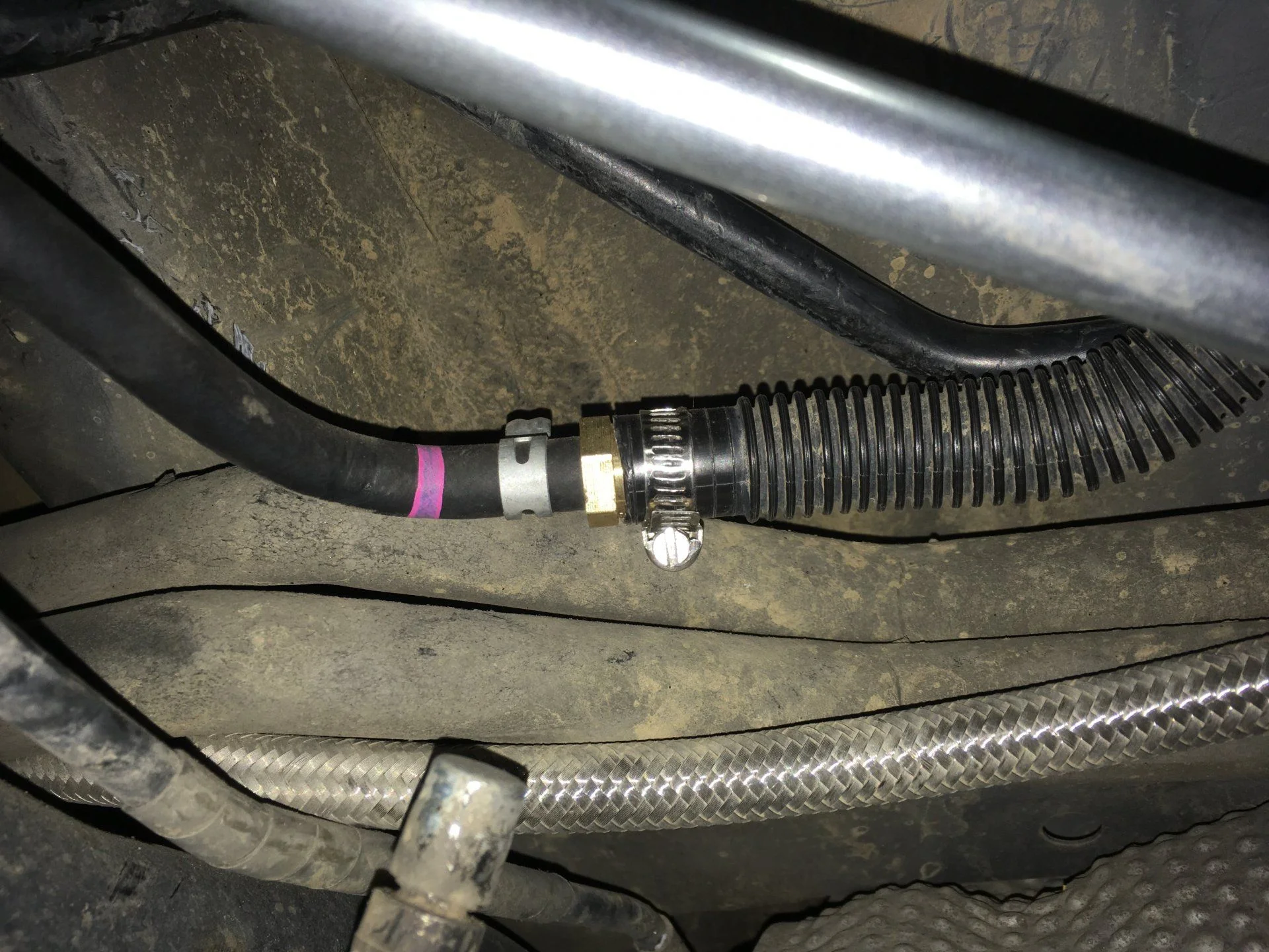

Cut the stock emissions hose and adapt to the purple sub tank connection - done
Attach the green sub tank connection to the 5/8” hose that runs up front - done

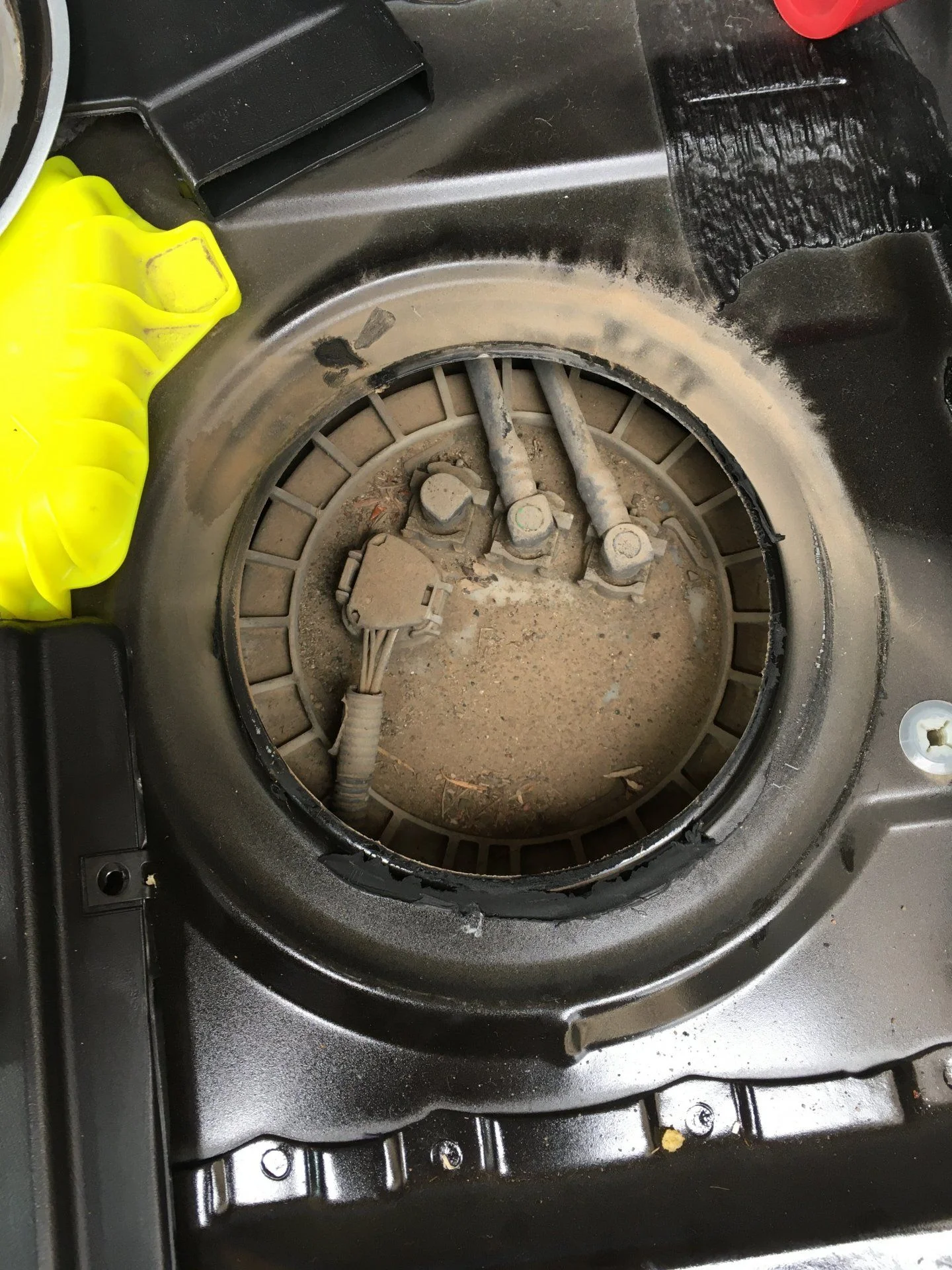

Swap the fuel pump assemblies - done

Attach stock emissions tank evap to sub tank purple input.
Pop up green clamp ( do not pull all the way out)
Pull evap hose apart at connection.
Ideal cut location is 8” long. I cut longer at the next flat part on the hose. Of course the hose is now too long but it doesn’t Kink anywhere so I’m rolling with it.
5/8” barb fits perfect.

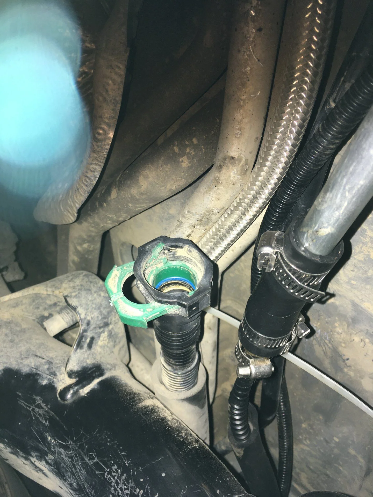

Connect to purple evap on sub tank. Connect to stock factory connection. Push down stock clip.
I broke the stock clip on one leg putting the factory hose back on, I suggest a small amount of lube to aid reinsertion. Have secured it with a plastic cable tie.

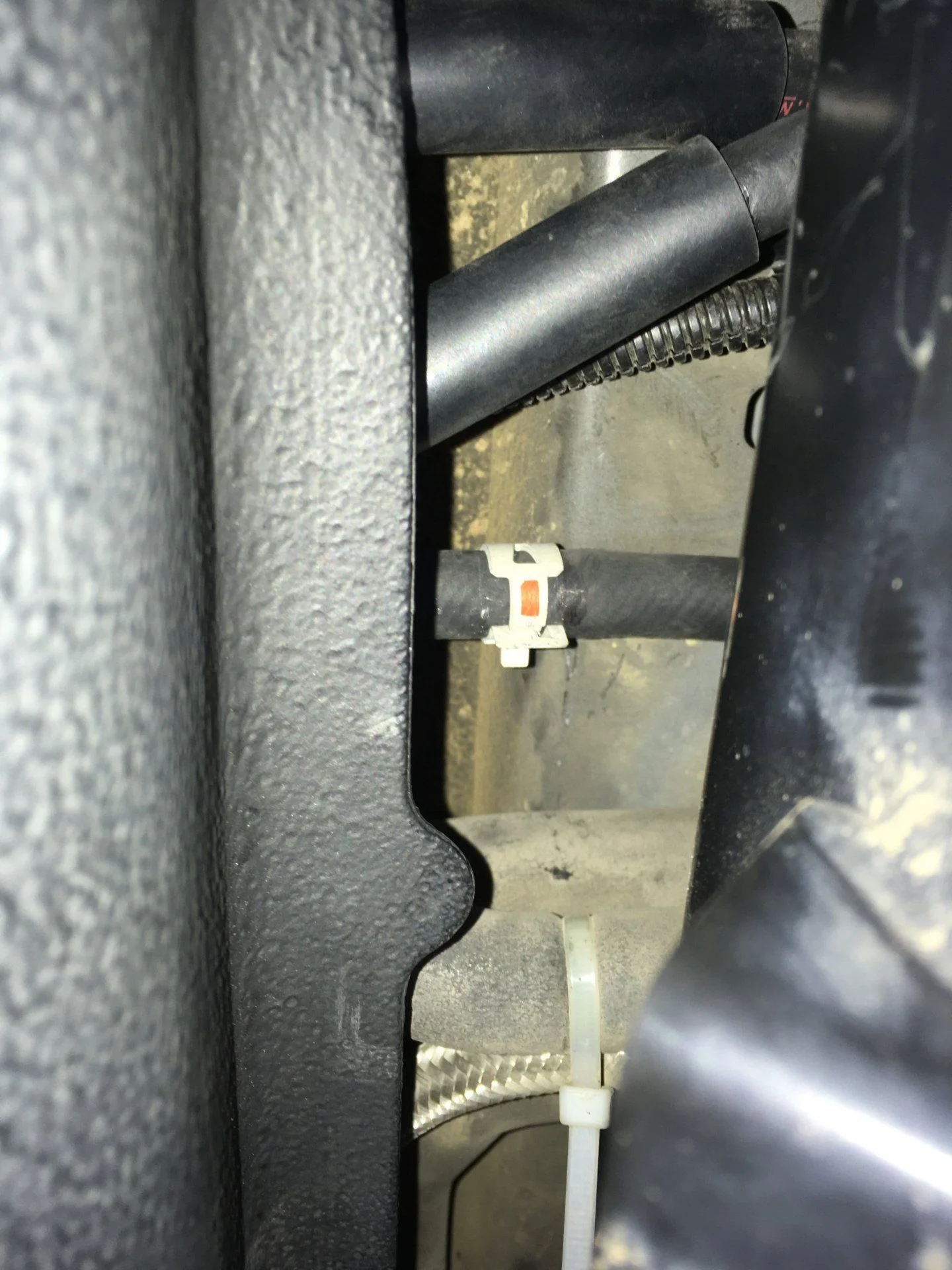

Note: it doesn’t change this step, but I think the best solution here is to reuse the manifold hard line under the car as the green evap pipe, and then just bridge the hard line from Beside the engine over to the new canister location. Sadly I couldn’t get the green marked hose on in the back from the sub tank as I didn’t plan to make this connection. With better planning and hindsight I’d recommend doing the hardline. It avoids having to run the evap hose forward, avoids exhaust heat exposure issues that might come up is cheaper saves a bunch of time etc.

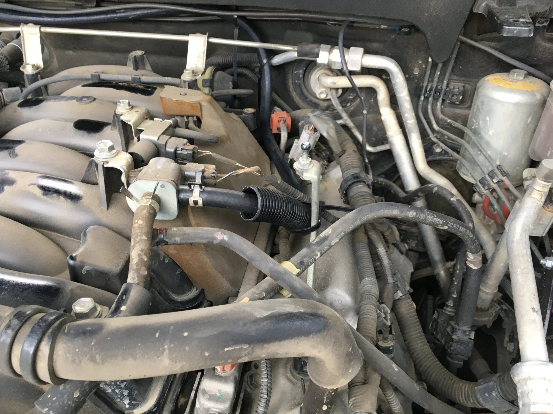

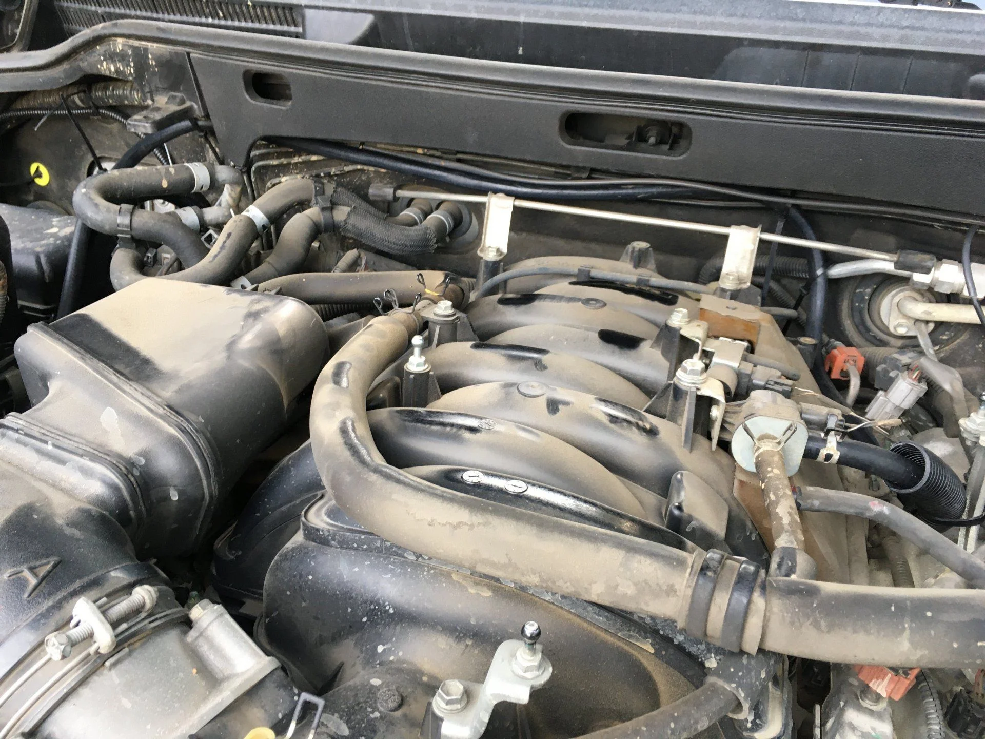

At the top of engine mid way back left side disconnect the hose from the hard line. Put a 5/16” hose on the solenoid. Run it back and along firewall, then up to the evap canister. I used about 8 feet.
I reused the two spring clamps from the small 8mm hose previously attached to the charcoal canister.
Zip tie up the no longer used hose.
Connect up the green evap line. If you reused the hardline, transition from the 5/16” to 5/8” and reuse the straight factory evap that used to be on the air filter.
If you used the 5/8” transition from 5/8” to factory using 5/8” to 5/8” barb. Again I chose to swap the factory fitting with the air filter to enable where I put it but this could be done both ways depending on your solution.
I put the 5/8” between the engine air intake and the engine. Used about 20 feet.
Note - I couldn’t get 5/8” to stretch onto the canister fittings. A 3/4” is used for the aftermarket sub tank. So a better sizing if you don’t want to reuse the factory hose is to use 3/4” for the termination. Could also do this if the green clips were broken and not reuse able.
Best path is probably green evap from sub tank to hardline to 5/16” hose to canister to 5:16” to 3/4” barb to a short length of 3/4” hose clamped to the canister
