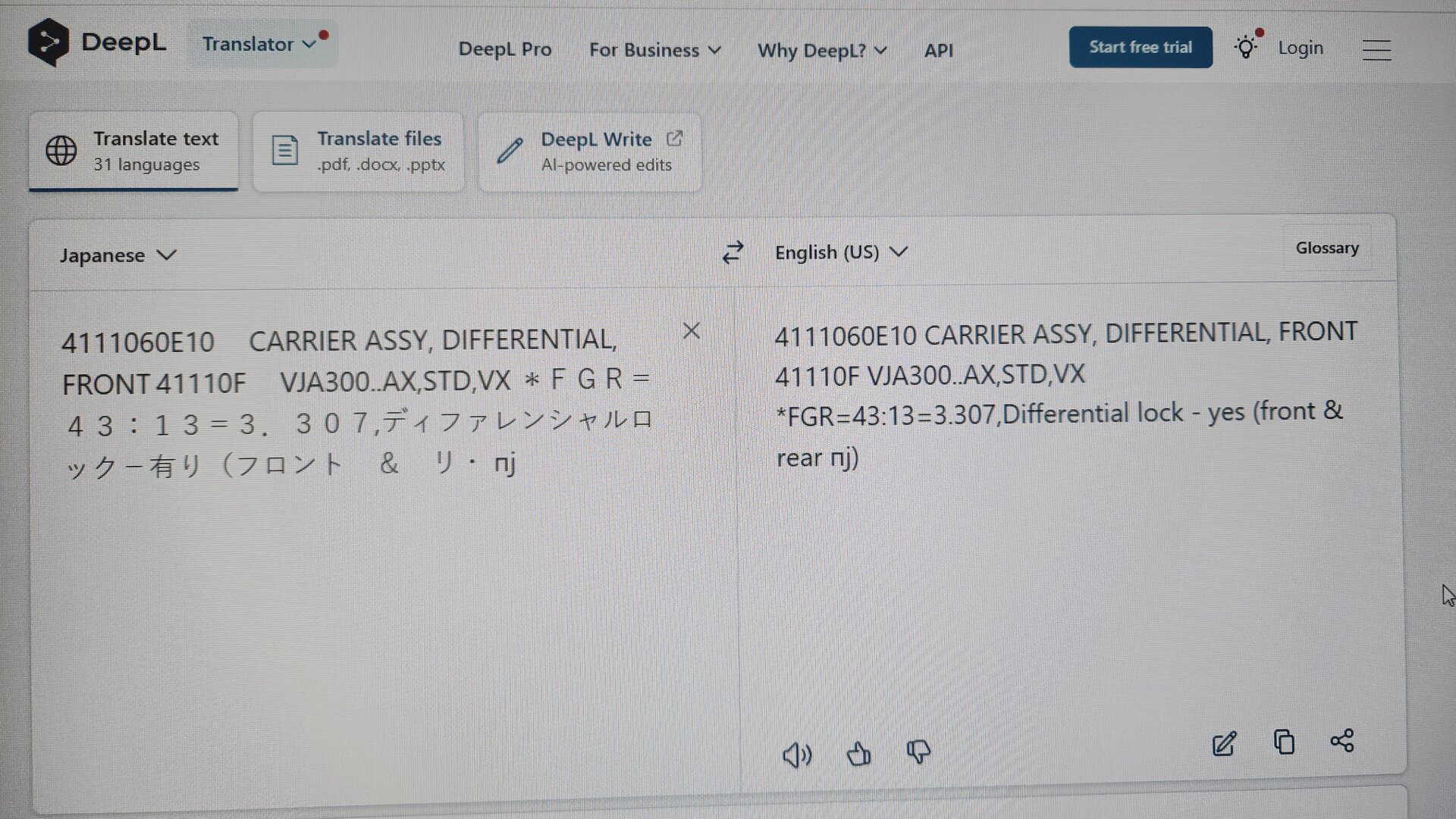

Toyo diy might have it wrong as it shows sama part number for locking and non locking.
The PN for locking differential will show as such:

4111060E10 is the one with diff lock and is is available in US too.​
That part number is not a live part number in the US parts system.
Thanks for checking that. I guess lexus parts now got some outside connection or similar geek like us that really dig into the parts calatog.
My bad. I checked the Toyota system. I don't have access to the Lexus system. Any Lexus specific part numbers for the North American market can't be "seen" within the Toyota system. So, this PN might indeed be available from a Lexus dealer.
