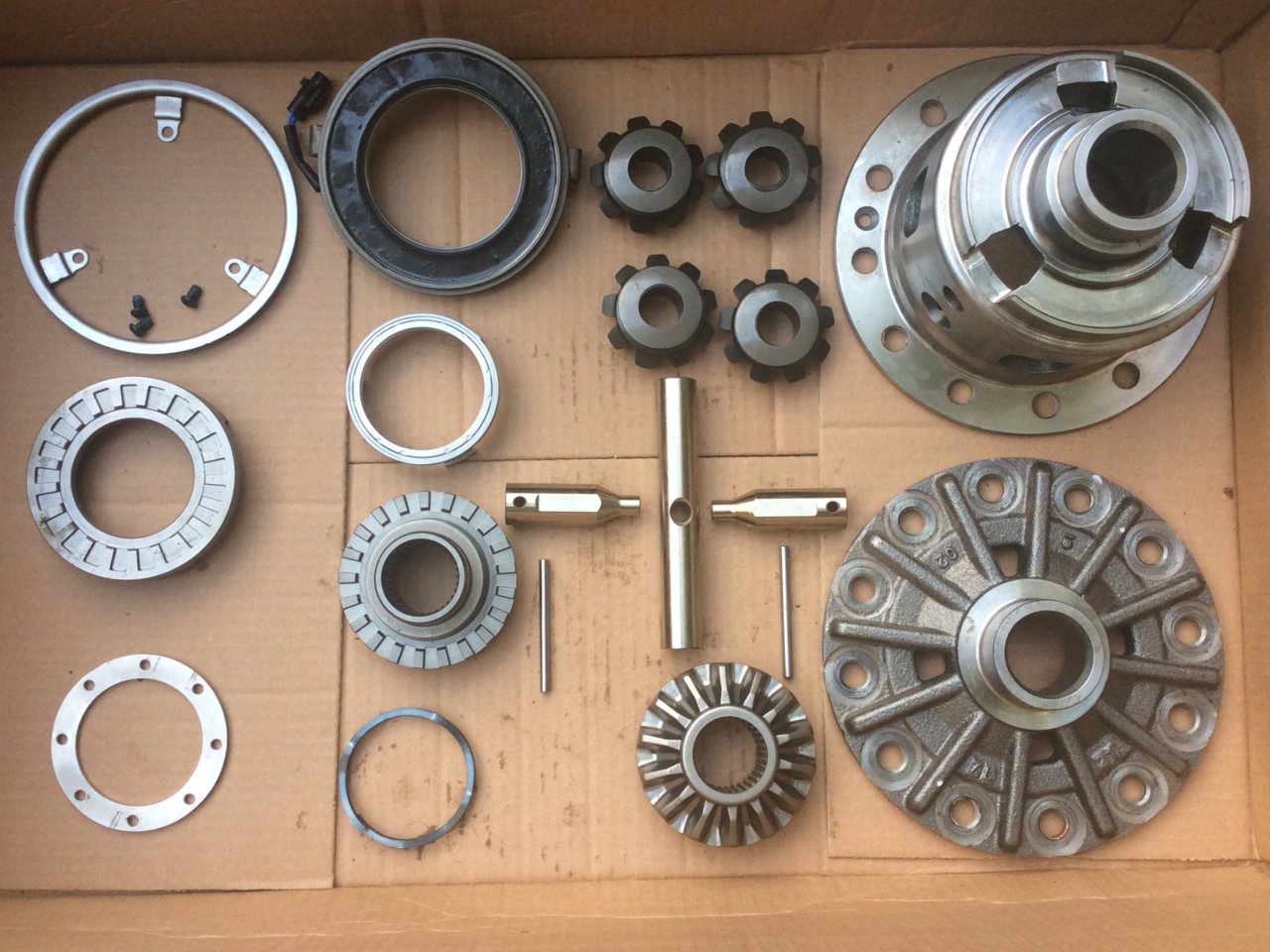

Here’s disassembled 3rd gen Tacoma 8.8” rear locker. Should be very similar in size to the new front.
Thank you for sharing this!
Makes a lot of sense to integrate the ADD system into the differential with a similar electromagnet dog clutch vs the sliding collar and shift fork/solenoid assembly. Removes a bunch of parts and eliminates lots of failure points. Should improve long term reliability I think. Only downside I see is that it's not engageable in the field if there's a failure like the older design.

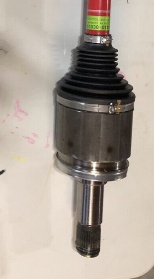

Do you happen to know how Toyota addressed the needle bearing situation? If they put another needle bearing in this one again - someone needs a public flogging.
The inclusion of the needle bearing in the new diff is an unknown at this time. However, the stub axle is obviously faaaar longer than the old design, which will add much needed bearing area and support… should prevent the vibration.
Sorry for bringing this back to life but does anyone know any more about this? The new Tacoma have much beefier half shafts and lower control arms. Is this still going to be a thing?
