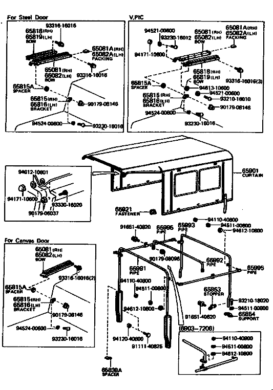

I just found this site and forum and I wanted to see if anyone could provide me with a description, or better yet a pic, of how the soft tops are suppose to mount to the door tops and the windshield frame top. I am restoring a 65' FJ40 factory soft top but it did not have the top with it and I need to make sure I have all the correct pieces. Its my first FJ project and I'm wanting to keep everything factory correct so I have a bit of a learning curve ;), Thanks

I have attached a file that should help sorting out what you need and how it goes together. Just right click and open it up in a new page.
Trollhole, i cant do anything with your attachment. When I open it in Firefox I can see it but thats it and in internet explorer there is nothing there. Can you please email it to me . I really appreciate it. The pic i could see was real fuzzy but it looks like it will have what im after.

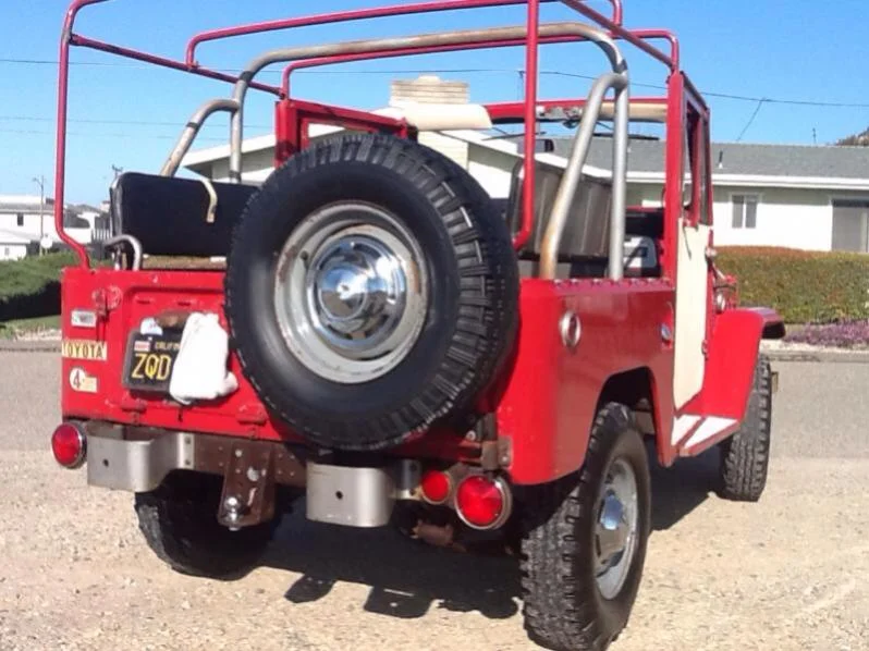

I still don't have it lol. I'm a bit slow. How does the soft top attach to the top of the soft doors and to the top of the windshield frame?
You need to install a channel on the windshield and slide the top through it. Then there are channels over the door and on the B pillar.
These are repros, but you get the idea...
ok thanks. I guess I have some missing parts. I have them on the door tops but nowhere else.
I think you should start a thread in the tech section and post up some pictures of what you have and we'll help you determine what you're missing.

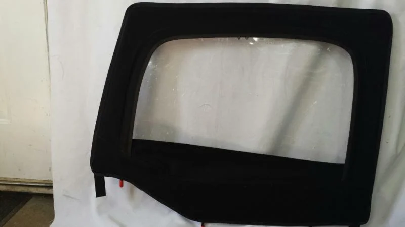

On another note. Customer sent door uppers. First one is done. Quite a beast to do. But the patterns and process are done. Looks great. These are black canvas to match his top from me.

Cool, So was the frame modified to the contours of the FST frame? I'm definitely interested in this option.
I was thinking I would modify the frame appropriately to fit the FST door opening then send it to you to have it recovered.
Lastly, what is the price for recovering 2 door tops?
Great work again, Marshall!
These are the bestop door uppers. They are used on modified doors that match the uppers. I've not seen fst doors with removable uppers. That being said it would be a shame to cut them up as no one is making reproductions.
If you want half doors find some hard doors and cut them up. I think they look the best.
As far as price I haven't gotten that far. It's not going to be cheap. There is a lot going on. Good news is we used the same zippers as what I make the tops out of. I'll have more detailed pics Monday. Probably a price as well.
I might make the frames as well. That might be this summer though.
My previous post wasn't worded quite right. I meant that the aftermarket soft door uppers are not designed to fit in the hard top opening. They just pressure fit against the soft top. In order to get aftermarket uppers to work properly with the FST top opening,the upper frame has to be modified to match the contour of theb-pillar.
I made a set of 1/8" steel doors that fit my STC door tops. I have a spare set of STC door tops that I am looking at modifying to fit the FST opening.
You are the only option for recovering the door frame. I have alot of marine upholsterers around here, but I want to support our Mud Vendors who support us. ;)
