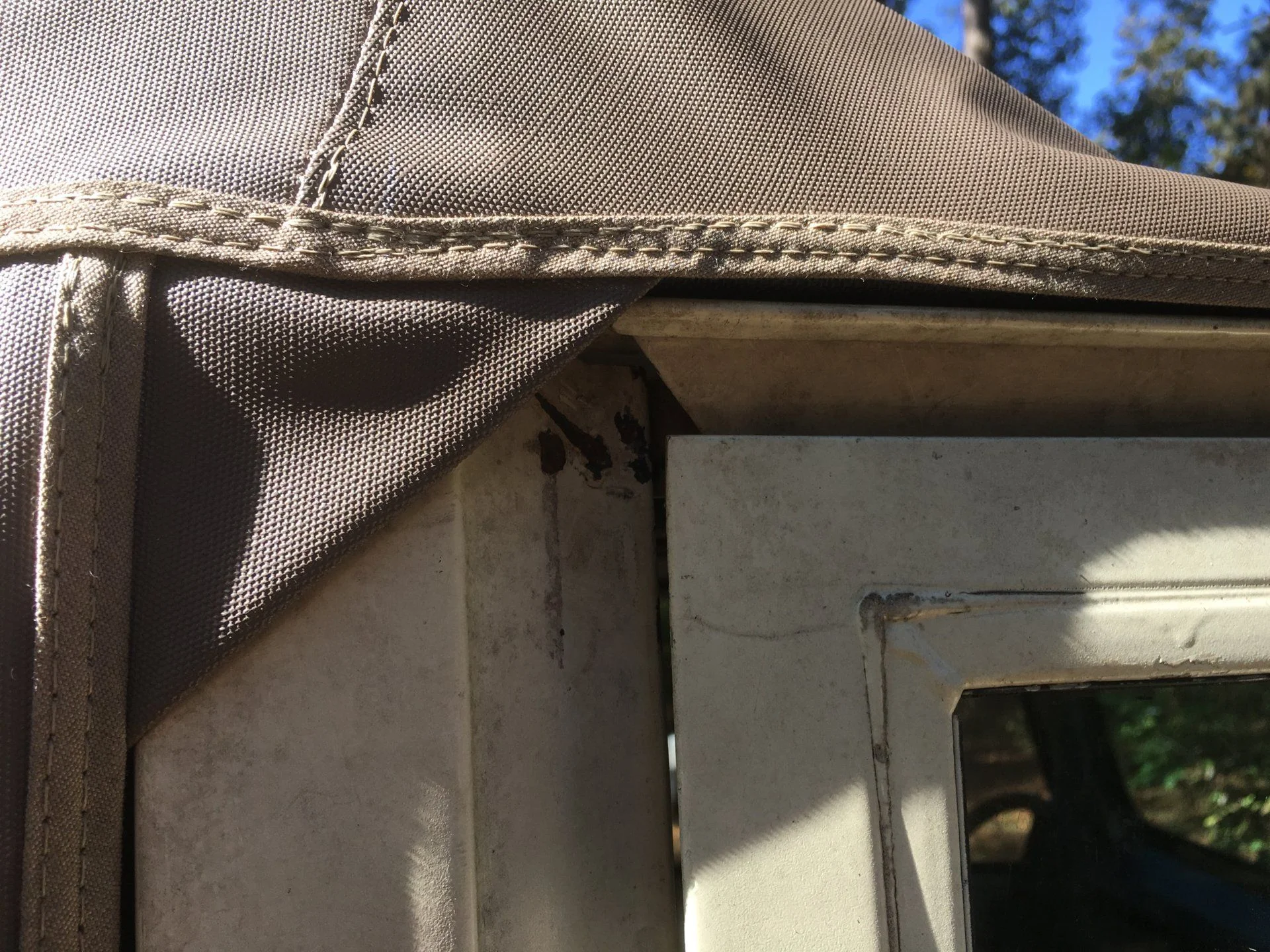

Here are a few more. the front end was a bit tight, possibly due to the metal tech cage. Also as you can see, it left a gap at the top end of the pillar, nothing a little paint won't fix. I also had to shorten the length of my bows from the pillar to the back to ~41". everything else looks good. I installed the turnbuckles with making a hole using a 5/16 hollow steel hole punch. Driving down the road at 50 mph, it makes little sound. i may have to adjust the rearview mirror to see a bit better, but that's about it.

You installed the turn buttons wrong they are supposed to go on inside of top on the 4” reinforcements and the turn buttons go on inside of tub. Call me when you can talk 616-450-0145 Julie
