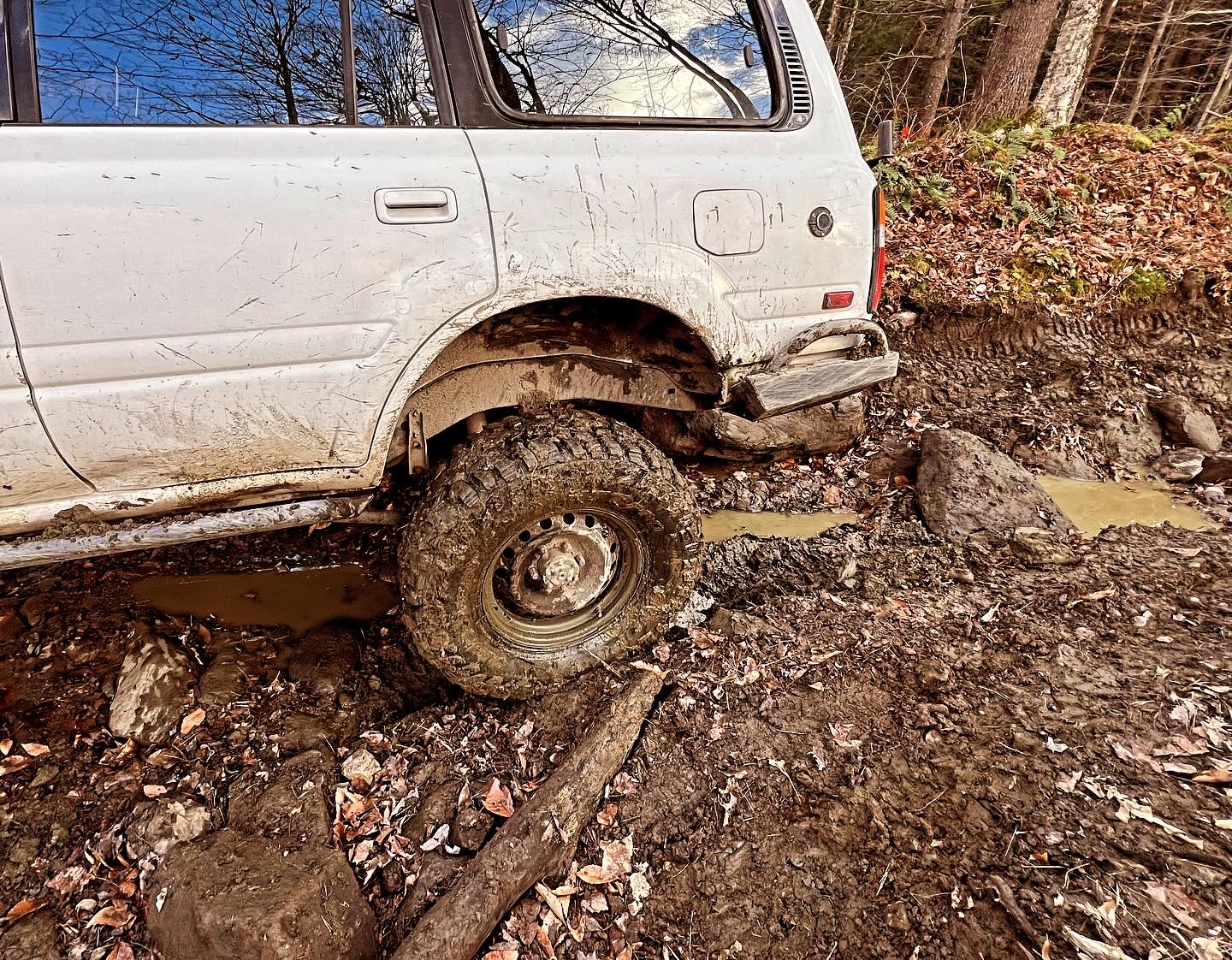

What are people running for upgraded brake lines?
I want to refresh my brakes as a winter project. At 30 years old, the rubber lines are probably toast.
I'd prefer DOT rated stainless lines with a sheathing. I'm running some from SQHD on the 200 and they are fine. I'd like to get some that are extended, especially in the center rear line.
Picture for attention
