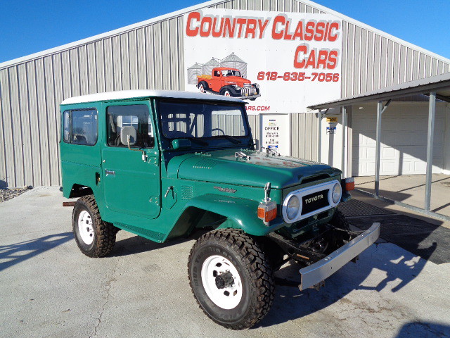

A couple things that I notice:
-Fuel door is missing
-Little bit of rusting forming on the bottom rear fenders
-Missing things in the dash
-Rear shackle "lift" looks sketchy and needs to go.
-Non OEM wheels
-Bottom of rear bumper looks weird - maybe rusty?
What gets me is how bad the pictures are. Poor resolutions and only a few of the underside. I'd check it out in person and tap on the frame with a hammer just to make sure it wasn't just painted over. It just feels like a cheap resto to me. No quality shop would ever send anything out with rear shackles like that.

I was told that the engine/air cleaner is not correct for a '78, is that true? Is this an import?
Pretty rig. I go here for visual reference regularly. > http://www.fototime.com/ftweb/bin/ft.dll/pictures?userid={2B59A31B-E687-42D4-B81F-7488E56A2498}&AlbumId={0E79F9D5-2373-4B2B-85CC-64FB136E1749}&GroupId={8F5F24C2-F271-4F5F-B7AD-95E2D9504437}&nt=a. < Make sure you read the description. Some of these 40s have been altered but not many. The door to the gas cap/filler is missing. The engine may not be a 78". Check on the jump seats. Not sure they are correct for a 78". I believe they should have fold down legs, the legs were the wide version. The padded dash is aftermarket. The spot weld dimples on the tub and hardtop are not visible. Body filler or replacement panels?
Check the corners of the tub versus the corners of the ambulance doors. I wonder if that is a 78"tub. Like yotadude520 said, the photos aren't the best.

The rear wheel openings in the quarter panels look like a pretty bad hack job, definitely not the oem opening..... you’ll need some flares to hide that. Also, that air cleaner indeed looks very different than the one on my 78.

I couldn’t tell you about the air cleaner, but for $23.5 I think its still a gamble. If you go look at it bring a hammer and ask if you can hammer on the frame. If they seem hesitant or say no, walk away right there.
I’ve heard of people doing this and the hammer will go through what looks to be a nice shiny brand new frame.
Also look up in the rear fender wells and around the rear sill for rust too. Also check for rust under the front doors.
It did look like they used a spray can underneath a bit here and there. And I've never seen shackles like that anywhere.

Isn't that a non-US air cleaner arrangement on that 2F? It looks like all the South American imports to me.
Not sure about the air cleaner but most SA 40's have no heater or dash pad. Considering the one on it was redone, I'd think it came with one from the factory.
Ha. I had to walk away from the thread and come back today.
Yes, lots of trucks and vehicles through the Port of Miami and various South FL areas you have to proceed with caution.
It may seem like a lot of length to go through, but to try and get North of $20k for a South American "botched" or "cobbled" truck that is no problem for them. I did see those crazy shackles and strange quarter openings. The incorrect air cleaner and non-standard underhood components.
Even the brake lines seem "custom" to me. I bend all mine carefully by hand the best I can. They're not perfect always, but you can see someone did those freehand, they're not repro or factory US-spec 1978 either way.
