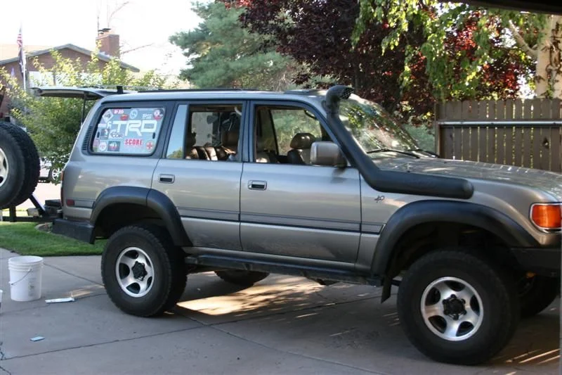

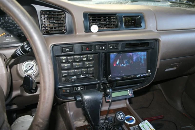

In addition to the dual battery I made 3 other changes last week to the truck. I replaced my indash dvd with a different system. yep I'm a dork but a solo trek requires good tunes and cool technology. Oh and I got the deck at distributor price.

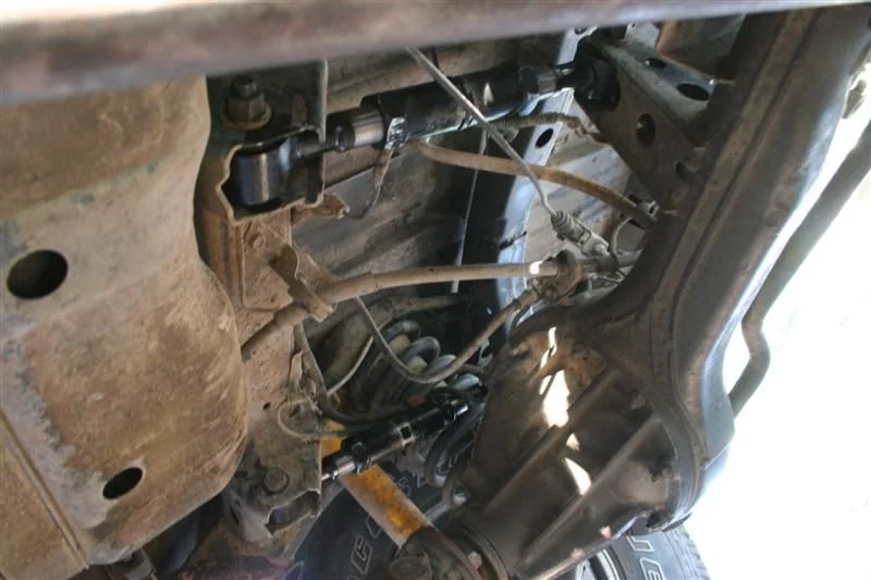

I swapped out my rear upper control arms for some adjustable arms to minimize the vibration and save my ujoints. I took a 2300mile trip over the weekend the smoothness on the highway was noticable.
lastly I painted my fender flares with some simple spray on bedliner. i like it because it isn't as rough as the real stuff and it looks good. my flares were trashed from my poor driving skills and i like the contrast against the paint.
this weekend i'll be redoing my drawers after selling my old set. pics on monday. hopefully.

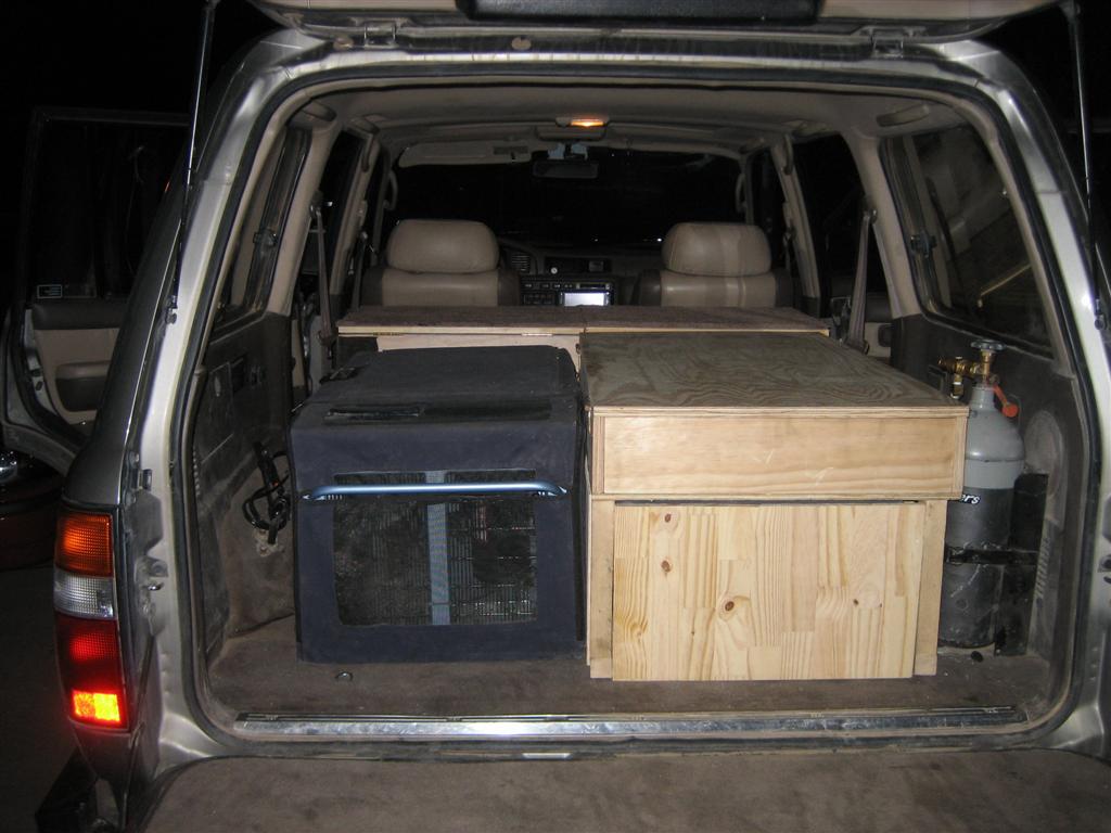

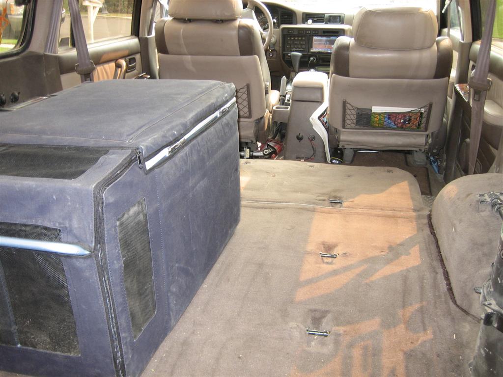

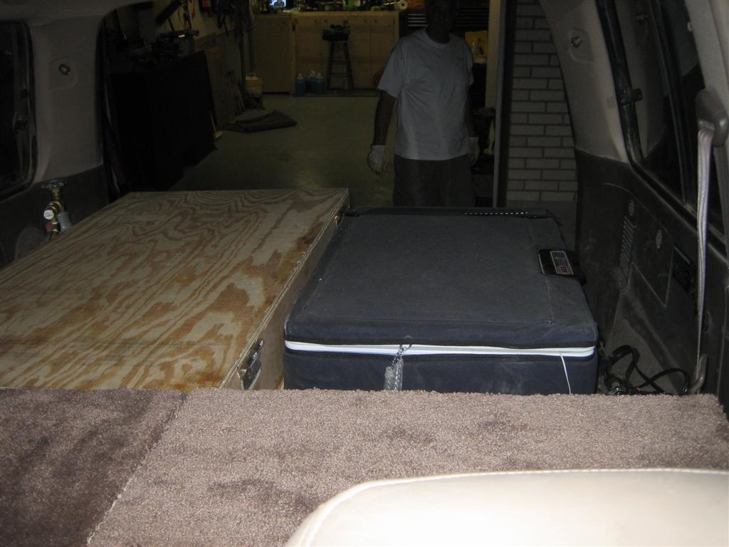

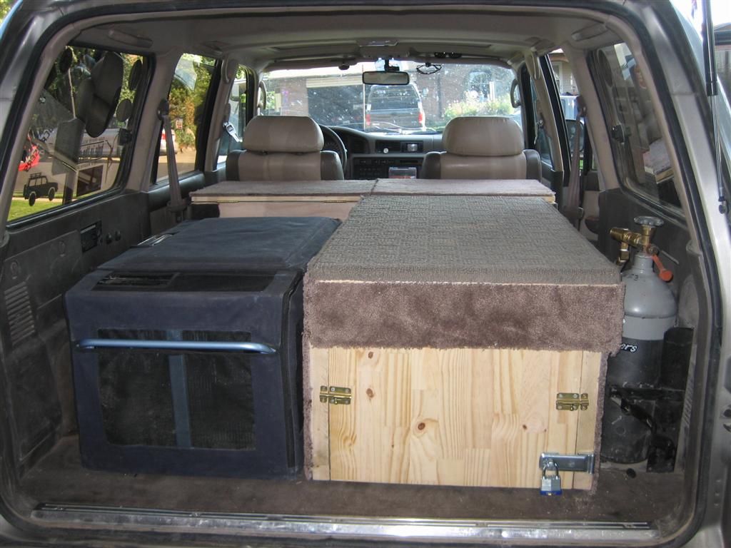

I spent the weekend working on new storage for my truck. i sold my old drawers to a local guy a few weeks ago. i took a bit of a different approach to this build and had a few goals in mind when i started building.
1- simple. my wood skills and tool availability is limited
2- deck height. make it level with the fridge so in a pinch i would have no problems sleeping in the truck
3- save weight (my truck will be rather heavy once loaded)
4- i wanted to have enough storage to have everything locked up, nothing out and visible
So with those goals in mind I decided it was okay to lose a bit of storage space in lieu of weight savings. Because a set of drawers 18 inches tall would have been extremely heavy i decided to build shells for containing lighter weight containers. i know i'll be gone for almost 10 months but i'm still only one guy. i shouldn't need that much space.

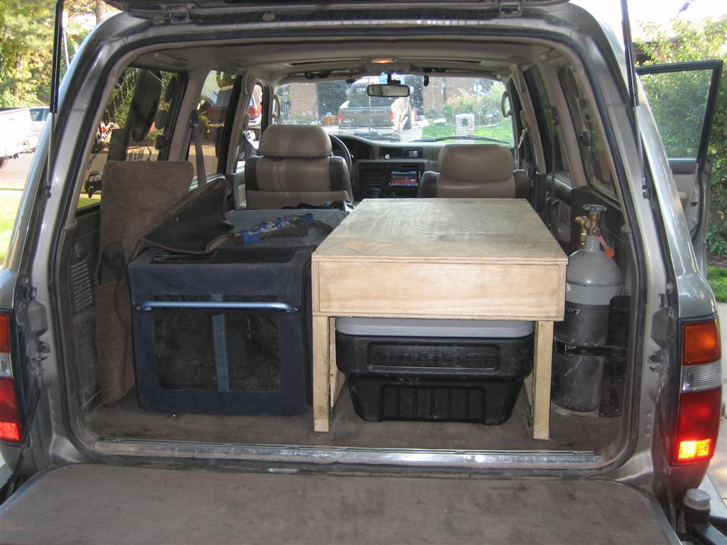

i started with the box to run parallel to my fridge. underneath i'll be able to place 3 small action packers, or one small and one medium sized depending on how parts and tools shake out. these will contain emergency materials for the most part, alternator, waterpump, start contacts, birfield etc. the rear most action packer will probably hold my 'kitchen.' stove, dishes, spices, utensiles etc. above this i built a 6in deep box that should be able to hold longer items as well as more readily access items, pry bar, ax, camp chair, tow strap, d rings etc.
so...
The blank canvas...
the build...
in place...
i need to attach the gate latches but you can see the cover over the actionpacker area.
more to come.

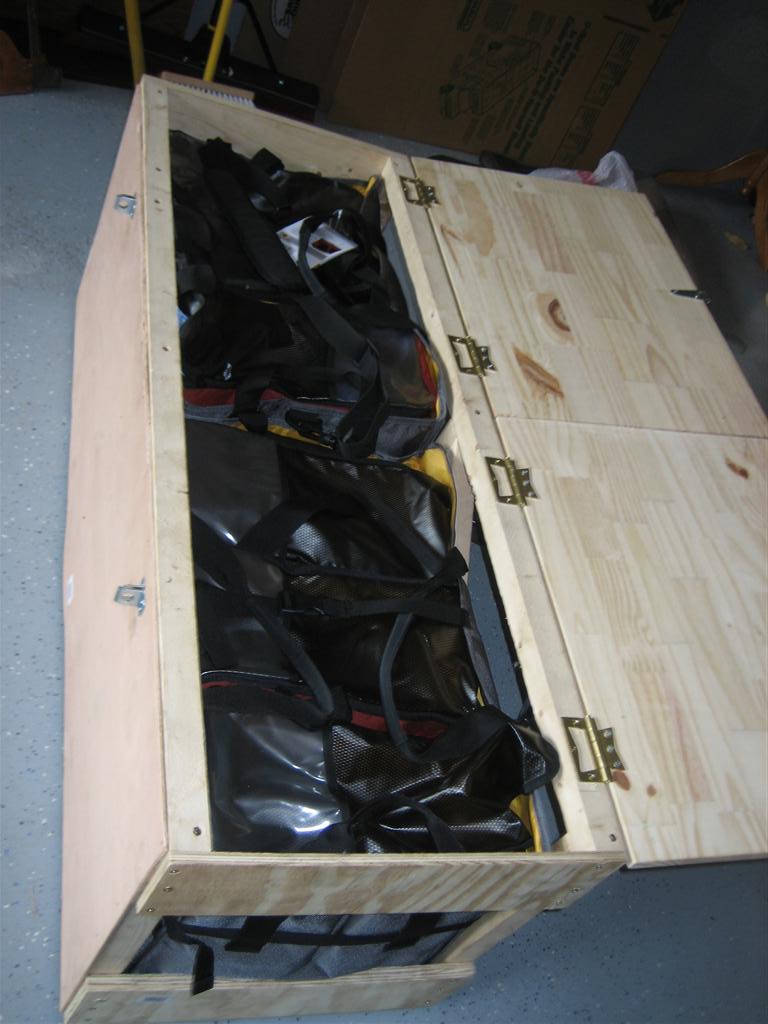

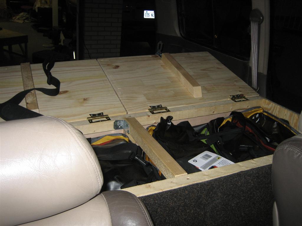

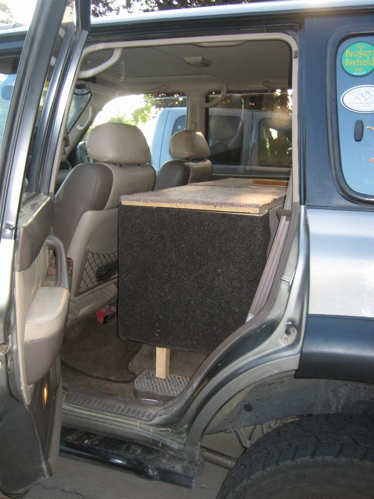

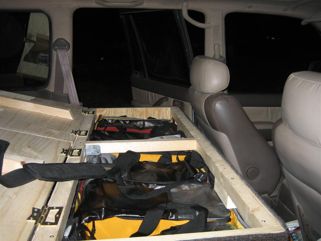

so as part of my goal to save weight and stay organized the box behind my fronts seats will again be little more than a shell for holding containers. after researching at Outdoor Retailers Show here in SLC i settled on these bags.

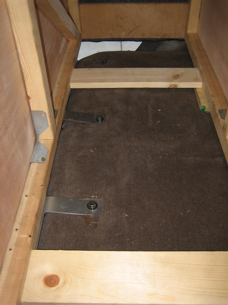

two of them (and thus 6 individual pods) will fit inside the box. this will allow me to keep my stuff organized and not buried inside huge duffle bags and still remain very light. clothing, camera gear, laptop etc will go into these bags or on top of them. i don't have pics but should in the morning of the brackets i used to secure this box using the rear seat mounting bolts.
the stucture...
with the bags installed...
now in the truck...
view from the front...
all loaded up...
i need to finish up the trim around the edges, add some handles, and carpet the rear box. then find a way to attach the 2 together for stablity purposes. luckily i have some nice washboard and potted roads nearby so after final assembly i can load up and go rally a few hundred miles and see how they do.
any comments would be appreciated. i felt like i was reinventing the wheel when it came to strengthening the structures. i'm clueless. i have a bunch of steel 90s i am going to screw into the corners to add some rigidity. right now the whole thing feels very stout.

Nice rig Dave. Whos upper arms are those? They look like hydraulic rams..
I dig your website and will be checking in periodically.
they are arms that a local guy had machined by a friend. a group of 8 of us went in and got a decent deal. they are threaded, you just can't see them in the pics.

well i'm pretty much done. i need to add some rope handles to each lid but for the most part time to move on to my oil leaks and 4:88s.
carpeted and locked at the back...
the brackets i used to bolt the front box to the floor. i think they are thin enough that they will flex but rigid enough to keep the box secure...
and finally i added some legs for a bit more stability.
if time allows i will be adding a book shelf to the front of the box for my guide books and 'escaping from central american guerilla camps for dummies'
dmc
