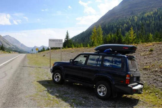

A little update on this thread, bringing it full circle to the original post. Currently the fuel is turned down a little more than 1/8th from where it was when the engine was installed and the fan clutch that was spinning at rpm was fixed (as stated previously, in Kamloops). I also started using a Lucas additive on this trip and I've seen my mileage spike up now that we're not doing tremendous passes. My last couple of tanks have been as follows and I couldn't be happier.
Banff to Sandpoint, ID (via hwy 40/940 to the highest paved point in Canada): 18.9 US mpg
Sandpoint to Missoula, MT: 19.34 US mpg
Missoula, MT to Twin Falls, ID: 19.8 US mpg
So, at this point I don't think I need to worry so much, from what I hear about NA 1HZ's, that's as good as it gets. The only things that need attention is the glow issue and my tranny not holding 2nd when I manually drop it to '2'. But that's another issue and probably another post after I review what the FSM says.
Highwood Pass along route 40, 2206 meters/7239 feet
