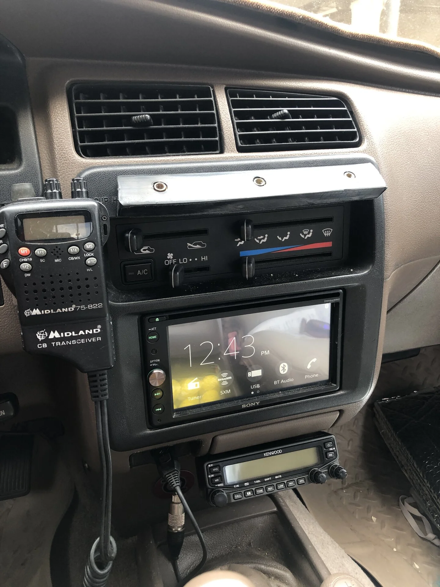

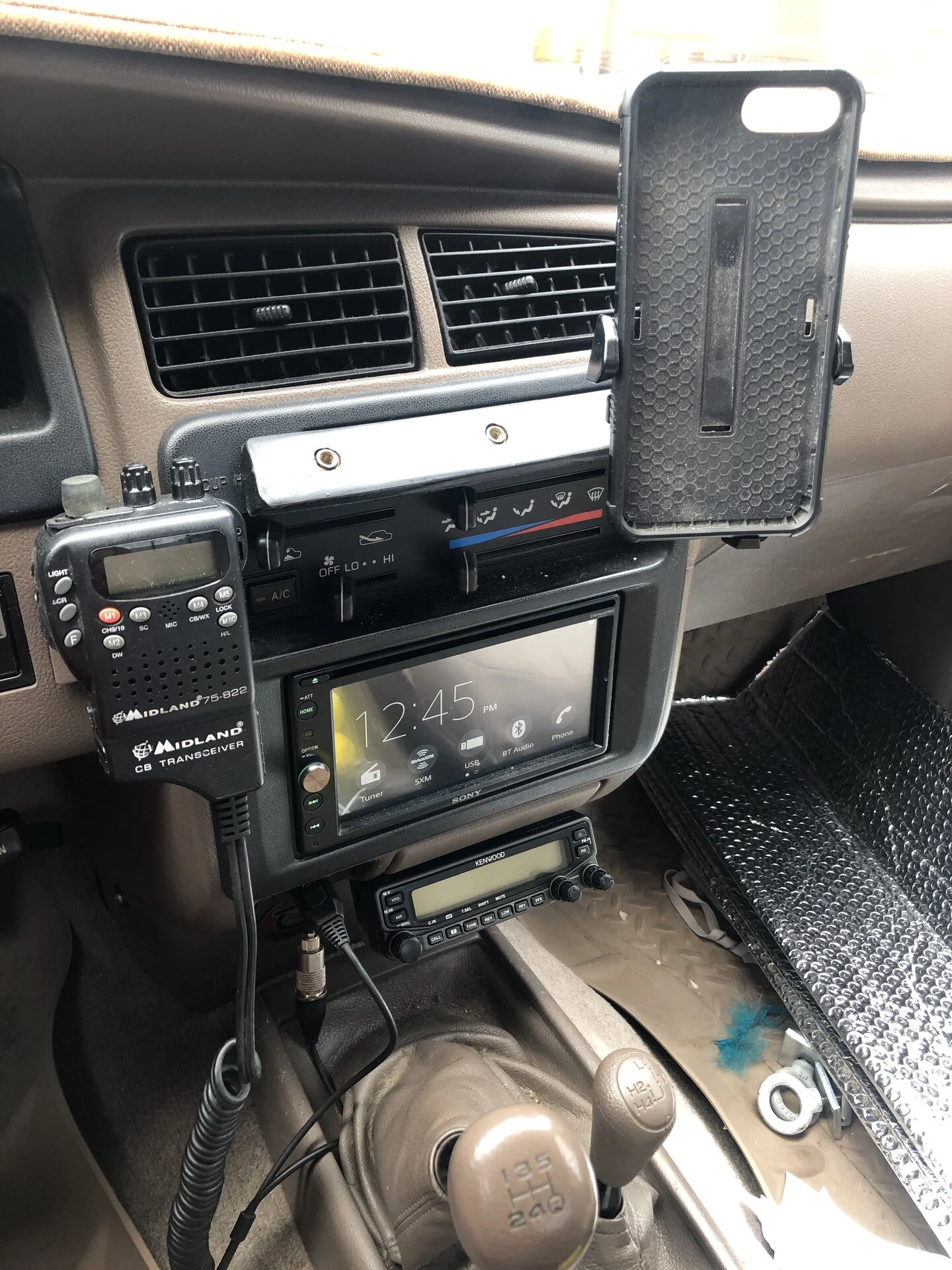

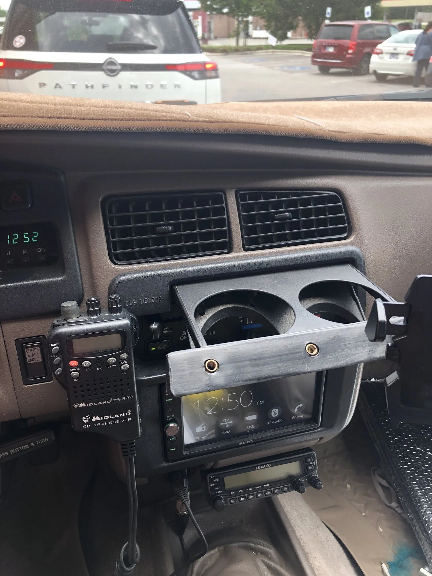

I made an accessory mount and got inspiration for it from my 80 series’ useless cubby insert from witsend. It nowhere near as nice but does the job. Originally I thought I would make my own solid insert to slide into where the cupholder used to be. Then I got smart and just attached the new accessory mount to the cupholder instead. Solid and much easier. I can see and reach all climate controls.
I don’t think I’d ever put cups and the phone there together because of the cupholder deflection but it’s an option if needed.

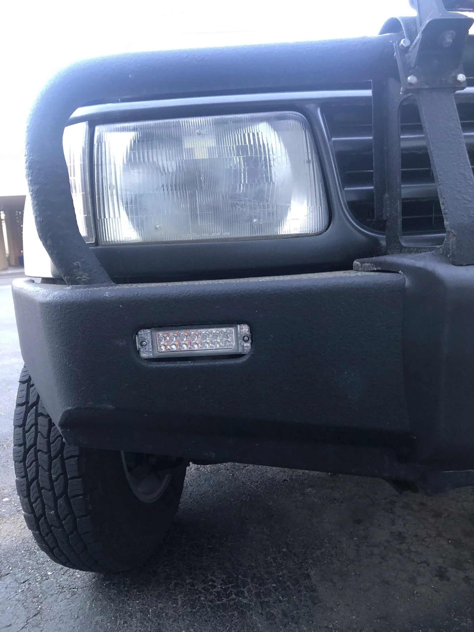

284581 miles. The ARB turn signals have been losing continuity and hyper flashing lately. I’ve tried new bulbs and tried squeezing the socket connections inside the housing hoping it would help but the problem always returns. I grabbed a set of leds from eBay Australia and some Amazon resistors to try. I had to make some brackets to mount them but they work so far.

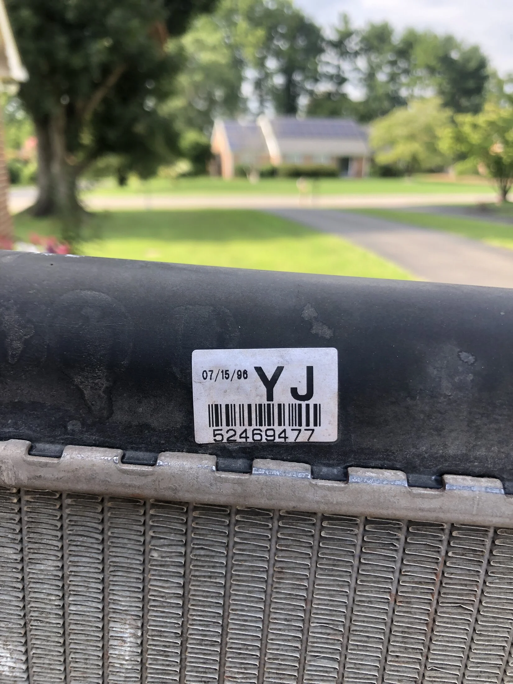

A koyorad c1512 from rockauto.

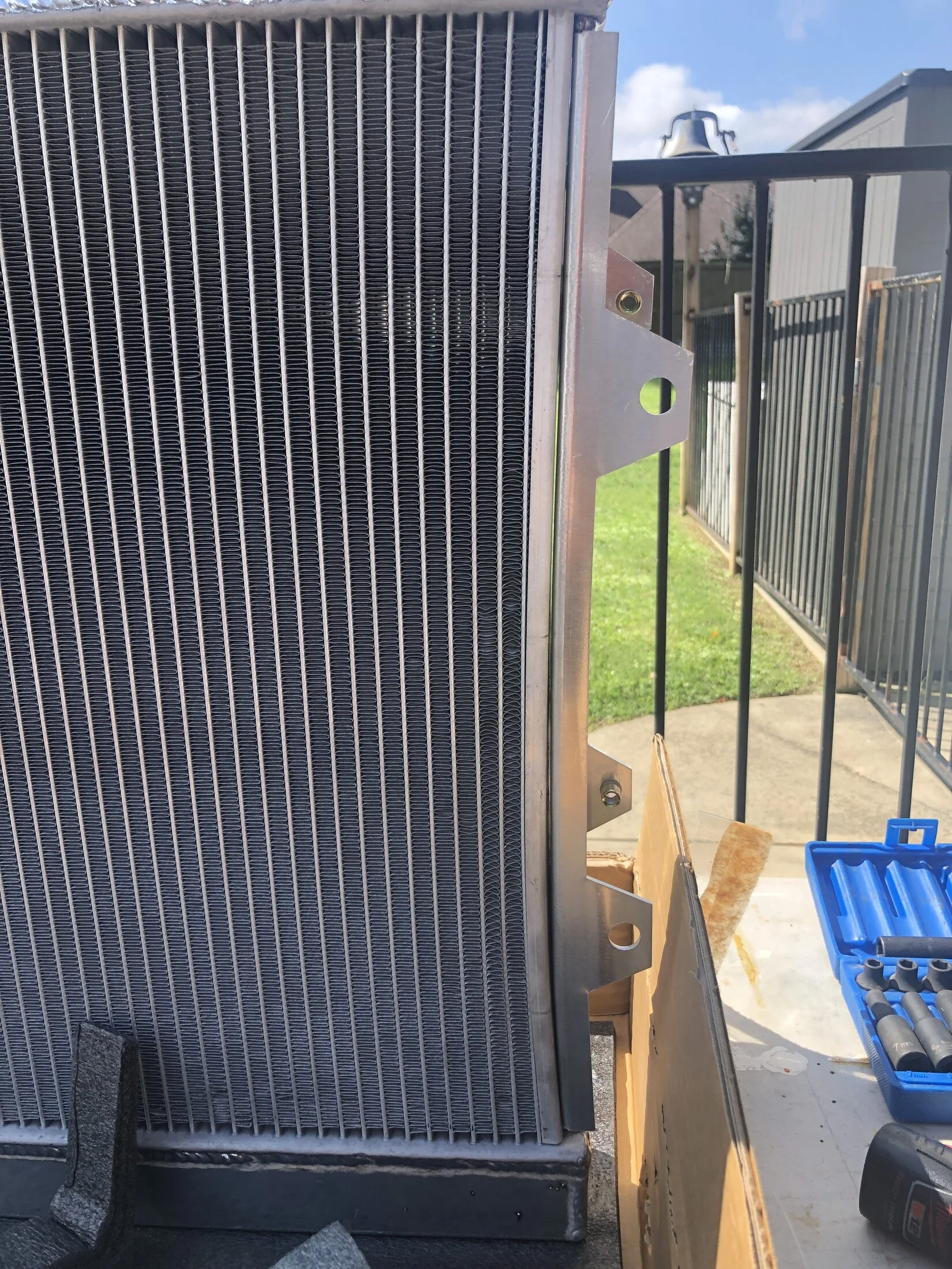

Originally I bought a shiny all aluminum rad from eBay because they always look so nice and all metal is appealing but it arrived with one side warped in so the mounting brackets didn’t line up. So it’s on its way back and the koyo is on the way.
Here’s the aluminum one. I wish it worked it was pretty.

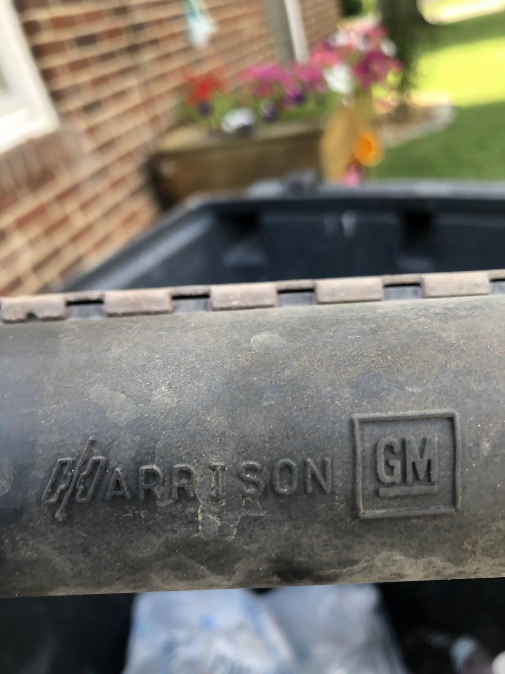

Wondering if that KoyoRad is an improvement over the stock GM one.
Granted my GM one has 260K miles on it and no issues so far.
Doubt it. My T100 has 285k miles. It came from the New Mexican desert for the first 205,000 miles of its life then 80,000 in Tennessee. No cooling issues that o know of. I seriously doubt the koyo radiator will last that long simply because it’s an unreal amount of miles for something that goes through so many heat and cooling cycles.

I am still impressed with the fit and appearance of the koyorad. It came with mounting brackets which is something I have read some other rads don’t have and the factory brackets must be moved over. I kept my old brackets if someone ever needs them.

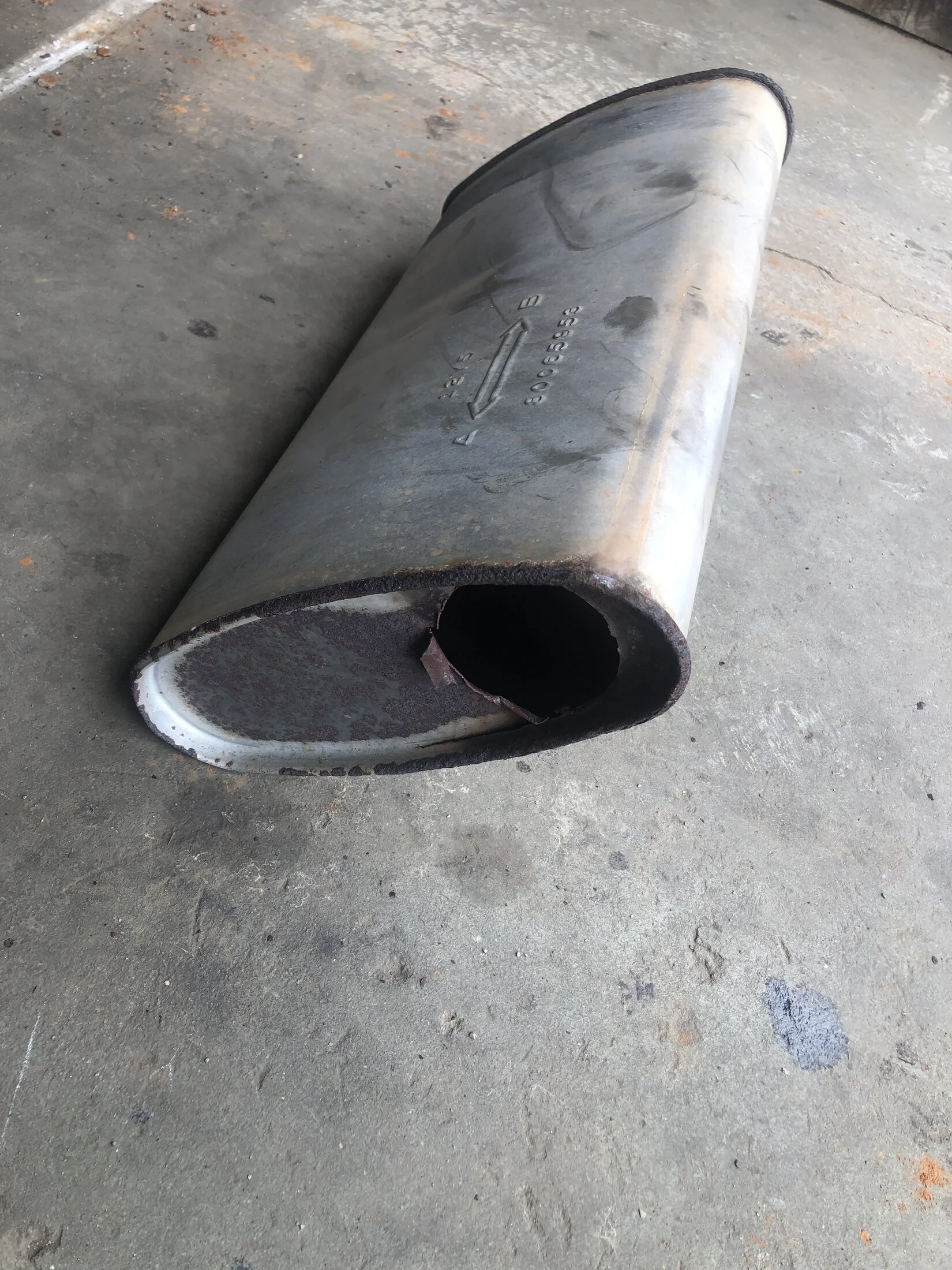

I had an exhaust rattle and some weird exhaust noises develop so took it in to a local muffler shop. 20 minutes and a new muffler and things were back to normal.
