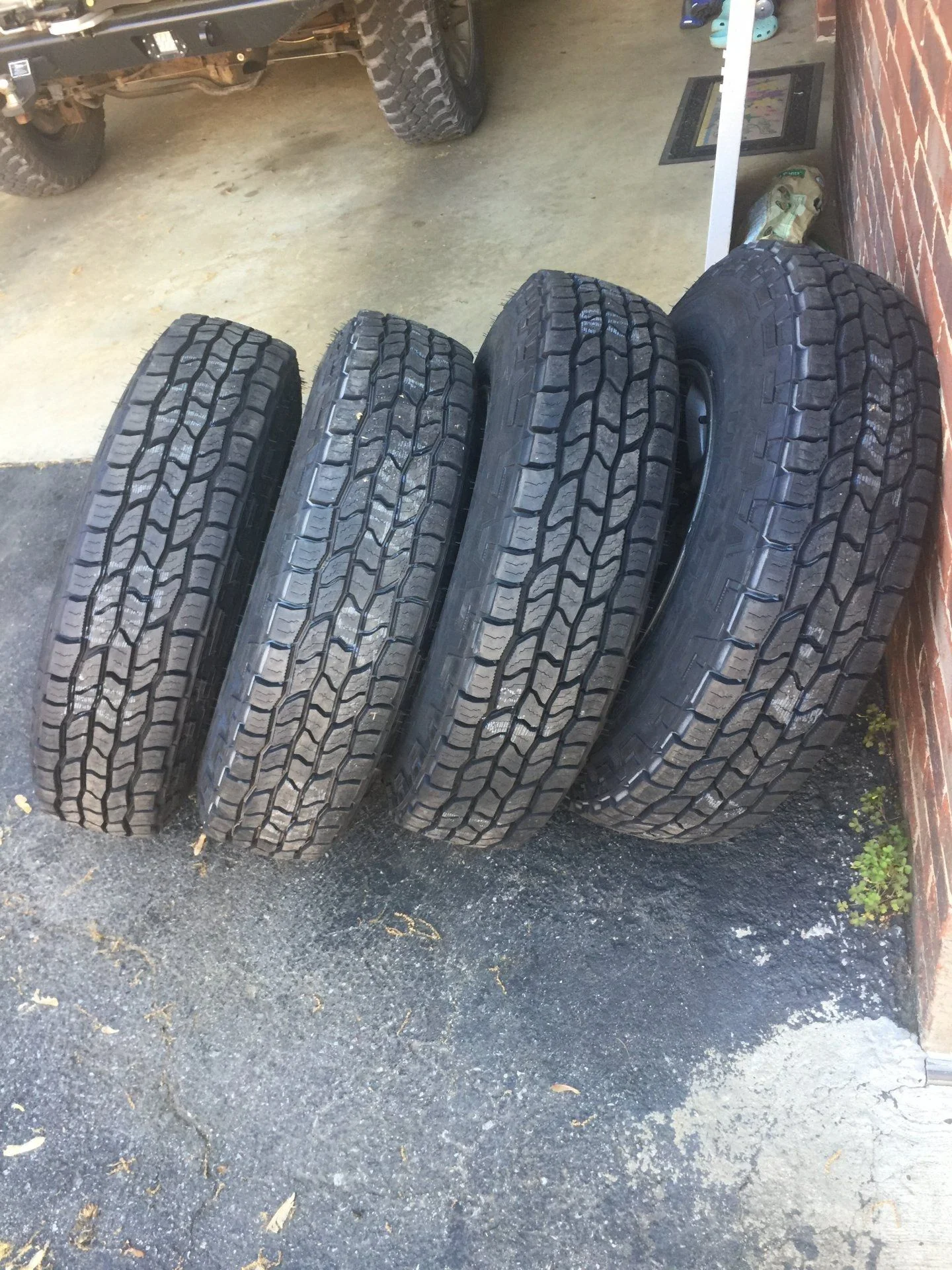

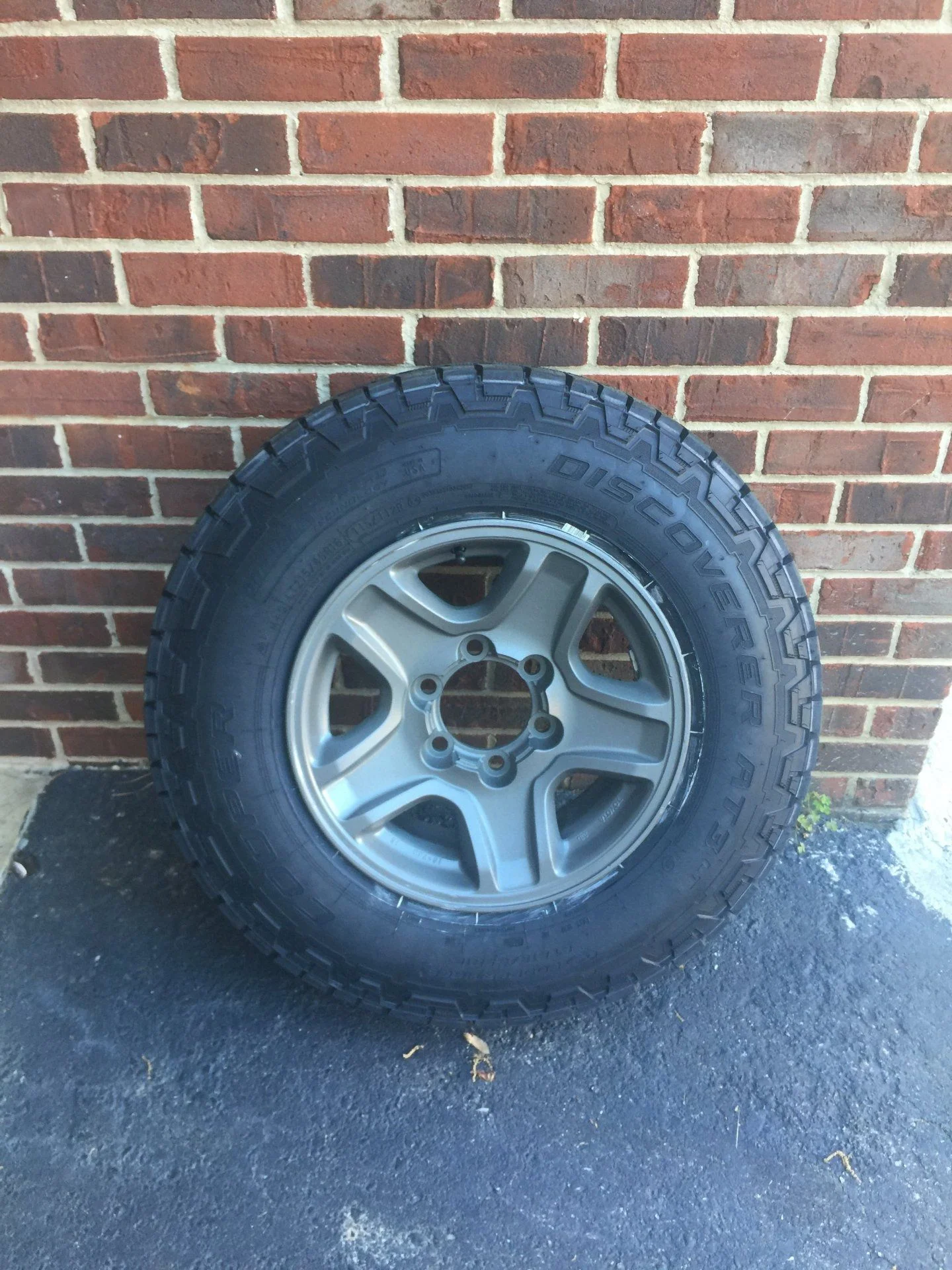

I had some grey paint so used it to refresh the factory wheels and I picked up some new tires today. Cooper Discovery AT3 LT 215/85r16 mini pizza cutters. I really like this size. I’ll put them on the truck in the next few days.
I hope they last as long at the bfgoodrich Tire’s I had before.
