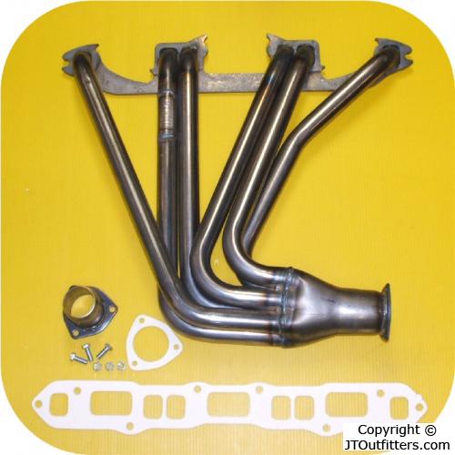

I have a 78 smogged 2F. It has headers, but I do not know what kind they are. I was hoping someone could tell me. Since it has headers the heat from them will not cause the IM to crack again like the stock exhaust (thanks for the info in that Jim...I was wondering. So I dont need the plate to keep heat off of the IM....)

Your headers look like JT Outfitters 6 into 1 to me...

Well I am going to take the IM to a welder to have it fixed. Since I was not doing anything else and my wife was watching the bachelor, I decided to take the headers off too. Here are some pics. Looks like Sub is right. Looks like JT headers when you compare the pictures....
