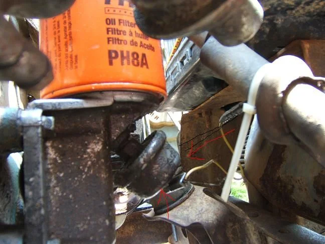

:cheers: That sounds like the winner. The rear one is the one I took off my F and it is now in the same place as is was in my F. I took the Oil pressure sender out and looked in the small hole and dug around in there with a pick. Seems that is a hole to no where. Can one of you guys post a pick - or link to one - of the sending unit on the filter housing?
Thanks
oil send unit
1978 2F...hope this helps
