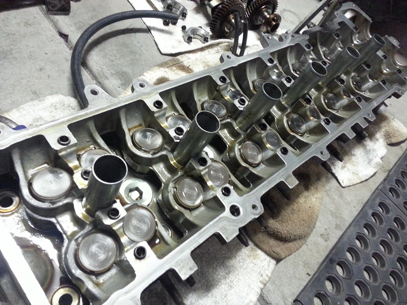

The head looked brand new when I pulled the cover off. I was very pleased, especially for 190k

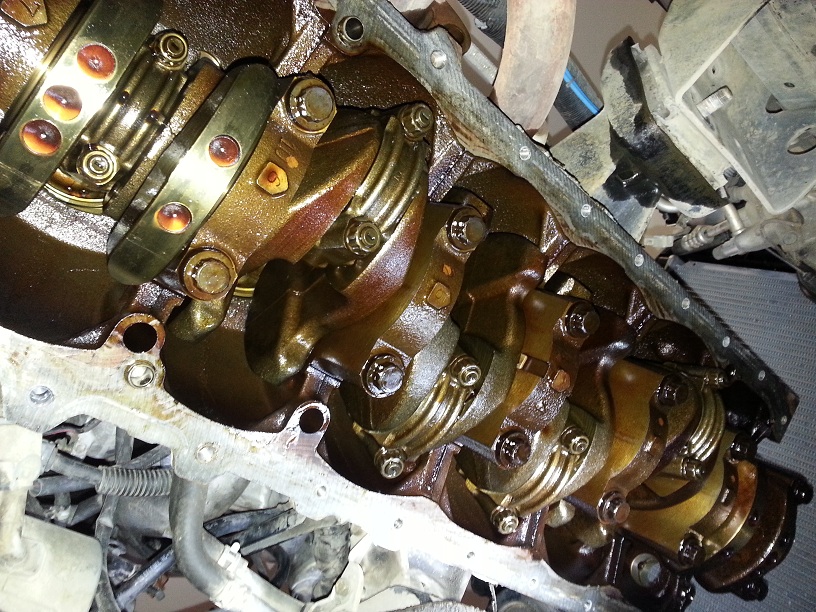

The bottom end also looked great! What a pain in the ass getting the oil pan off. One of the top 5 most difficult thing's I've done on a vehicle.

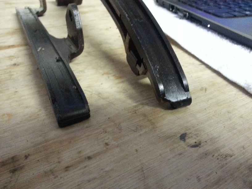

After getting the slipper and dampener off, I noticed both tops had small chips off of them. I wonder if one of the chips went through the gear down below.... Hmmmm

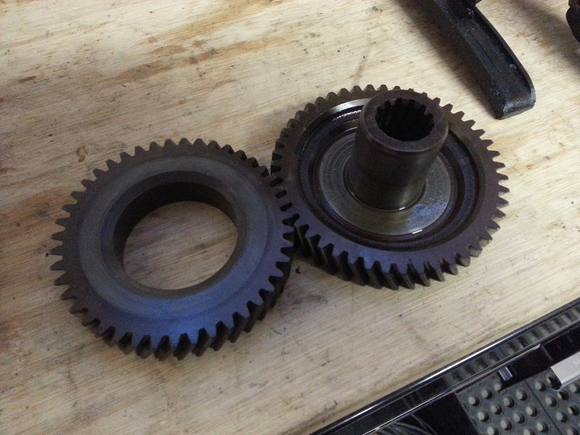

And the problem gears!

I honestly don't think I can take a picture of the damage, most due to the fact that I can't see the damage with my own eyes. The only way I found it was by rotating the gears together, both mounted in the car, and then just by holding them.
They rotated very smooth, but right when that certain spot on the crankshaft gear meshed, the gears didn't seat right, and they wanted to wobble.
No problem. I have seen a lot of damaged gears before, some like yours, where it is not obvious, but the clearance is compromised as the damage has created a high spot on the interfaces. I have spent a lot of time with a stethoscope trying to locate the sound of a damaged gear/bearing. It's always the little ones that take forever to locate. John

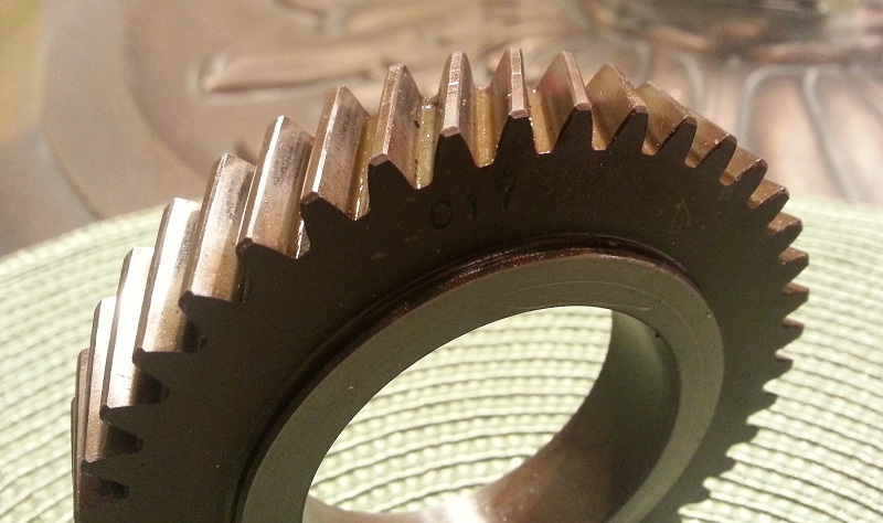

Here, I took a picture. The tooth that wobbles is the '1' directly above C17. Looks like all the others, with maybe a tad more wear on it.
