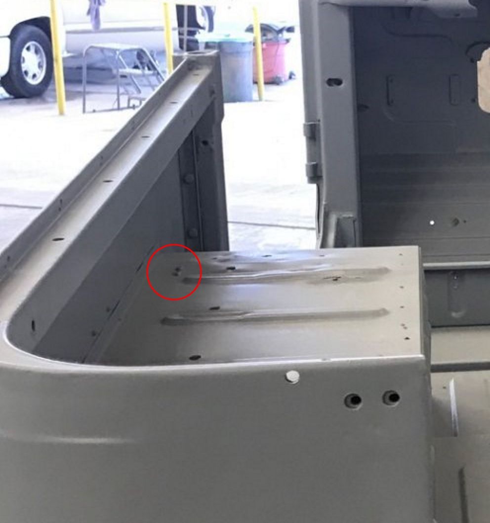

I found an engine crank handle from @Tancruiser. Super happy to land one of those. Where did the crank handles mount in the ‘66 FJ40’s? Where is the correct location? Thanks for the help

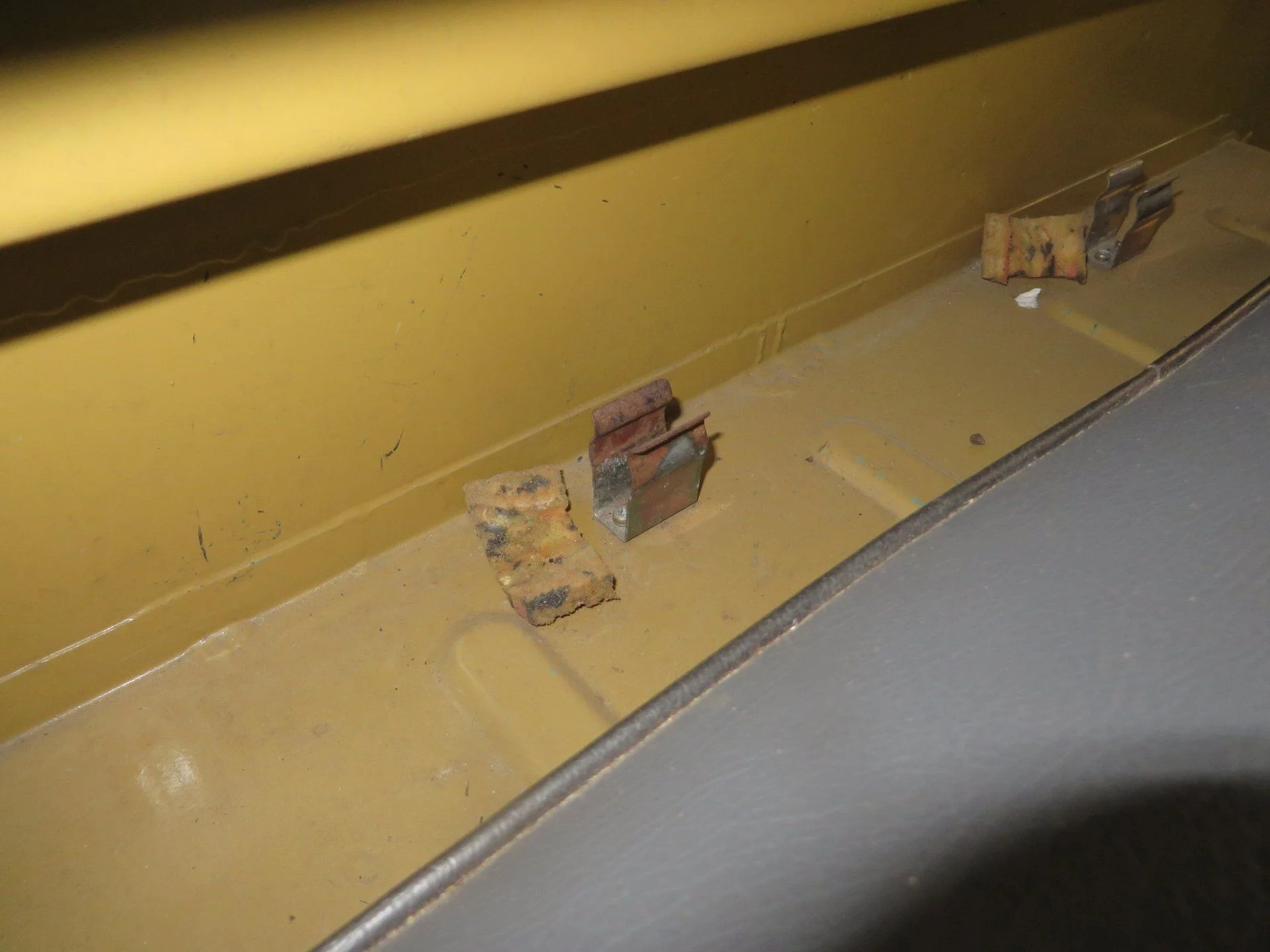

A 66 FJ40 uses 3 spring steel clips to hold the starting handle. These can be difficult to find since they did not come with US models. Similar clips were used in FJ45s, although these clips are riveted to a mount.
From the Jack Reference thread, post #96, Jack Rod/Starting Handle Brackets:

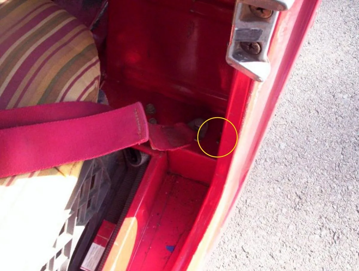

There are 3 starting handle clips, 2 on the left rear wheel well, and one front clip. The front clip is located on the floor just in front of the wheel well.
Early FJ40s use the same starting handle clips as the FJ25, the large clip with offset mounting holes. Originally body color.
Starting in 1966, FJ40s use starting handle clips made from spring steel, part number 74741-90301, SPRING, STARTING HANDLE SUPPORT. Originally unpainted. The mounting holes are in-line. (Landwrecker)

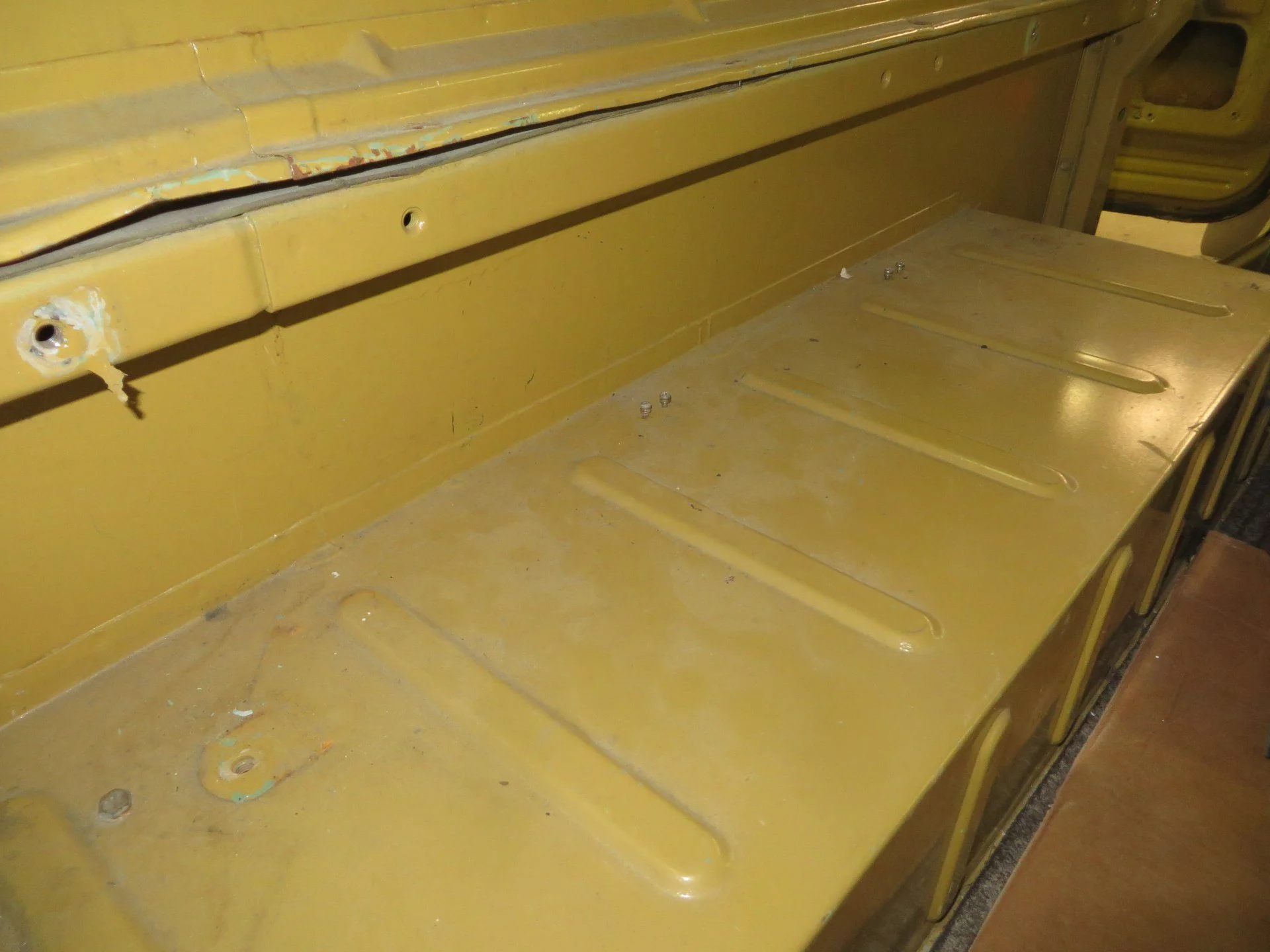

For markets where the starting handle was not provided, the starting handle clips are not installed, the small cross-head mounting screws are used to fill the holes. (Landwrecker)

Thought this had been discussed before. From the early sixties on none of my FJ40s have the threaded holes with screws. A number of them still have original paint. My 68 owned since 74 and while it doesn't the original paint anymore it did when I bought, no repairs or hole were filled. Would thing it was possible Toyota switched from the intended market and got sent or at change over on the line to the US market a few had the threaded holes but from what I've seen we didn't get them here.
Here is one from a US import FJ25. You can see the lower clip attached to the side of the tub not the floor.

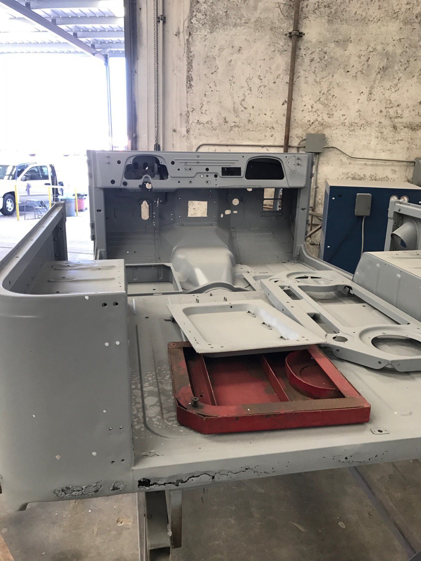

They were there :(. I put in new wheel wells. Great research @wscbill and thank you for the help. Any clue where to fine these clips? Needle in haystack I suppose.
