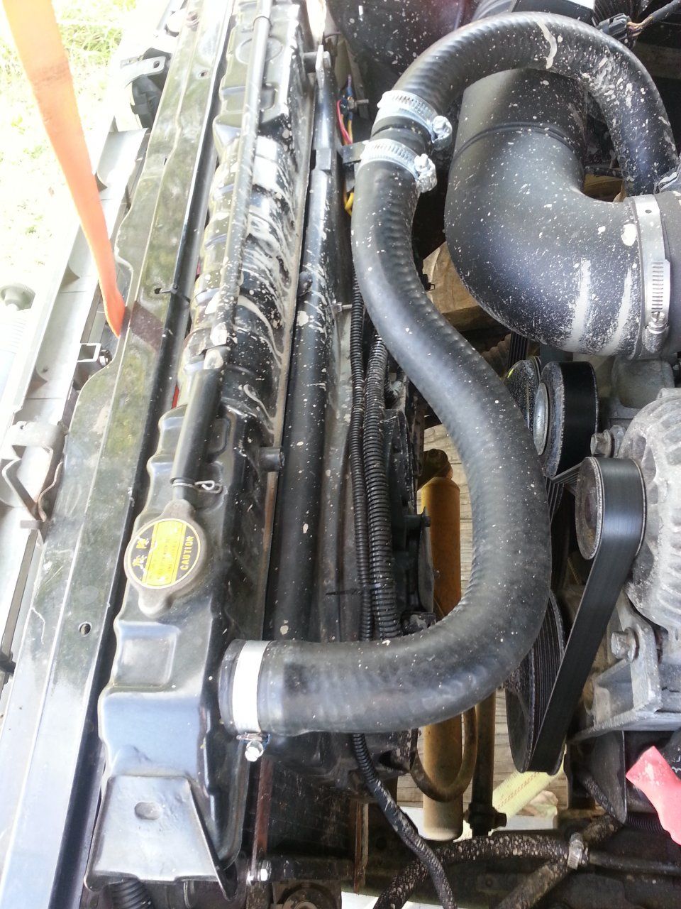

I'm running stock radiator with Ford Contour dual fans no overheating whatsoever my radiator is the 91 witches metal not plastic also if you want to run your air intake like mine I have leftover 4 inch plastic pipe from mine that I will make a deal with you. I'm running dirty dingo adjustable LS mounts if you're planning on running AC that's one thing that I would do different I will get my mounts too far forward to use the factory LS A/C compressor. If you have any questions and want to speak with me send me a PM and I'll send you my number
